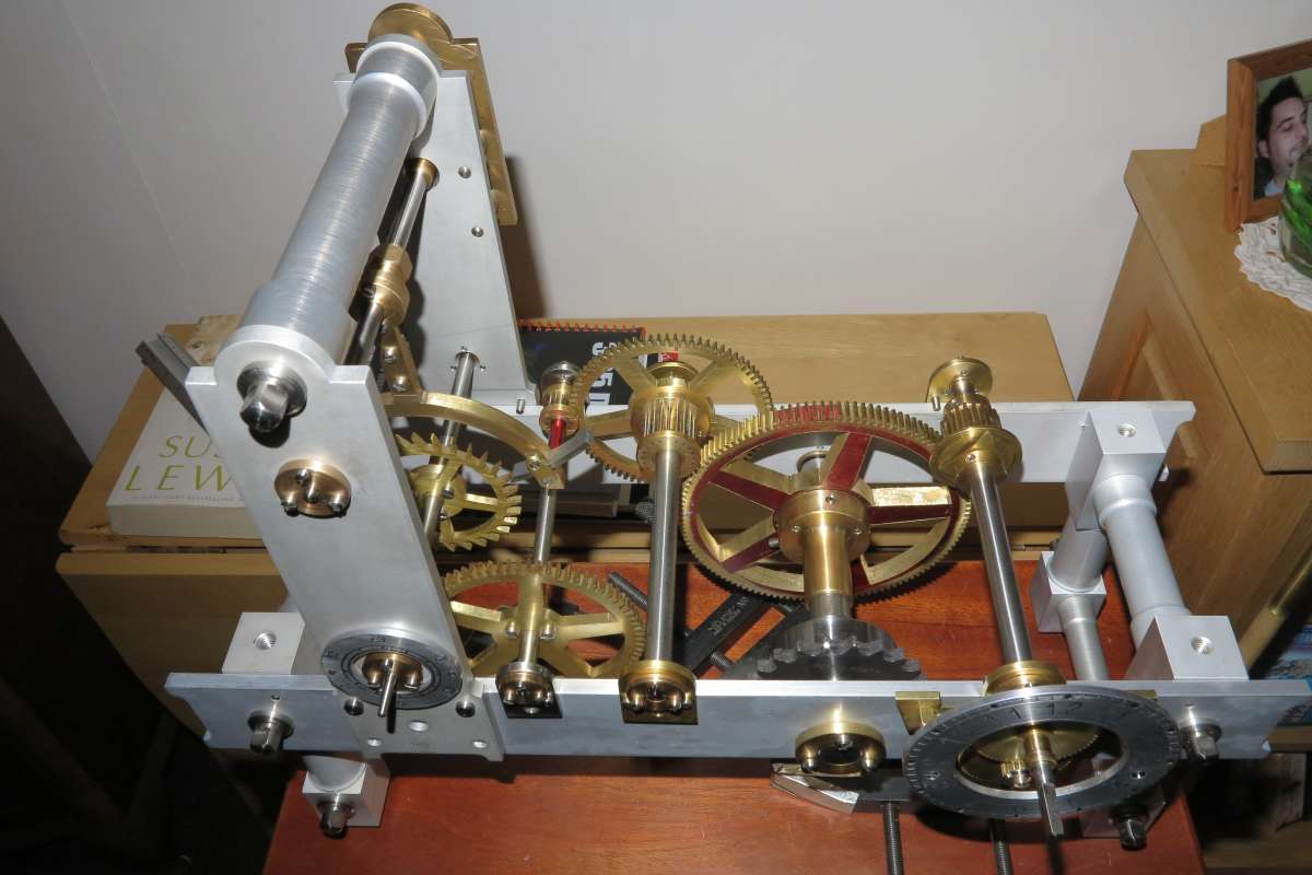

                  bernard towers
                    @bernardtowers37738
                    lovely to see Chris and glad someone else is making one. Amazing how two people have the same drawings but the end result is completely different. Mines been running non stop since 2018 (Electric winding).IMG_6932

                      That looks excellent Bernard! Did you use wildings plans for the auto electronic winder? I’m going to have to do this as I’ve not got the drop long weight running.

                        Th electric winder is a version of the endless chain thing that operates a tilting arm with a tilt switch that operates a relay for the motor and turns off by tilting the arm in reverse. It winds about every 30 hours.

                          Mine is still on the drawing board! I have a bunch of mods planned that are aimed at increasing the run-time on a single wind but other things keep getting in the way of finally detailing the design.

                            Excellent work from Bernard.  He scores double points because it’s a Towers’ Tower Clock!
