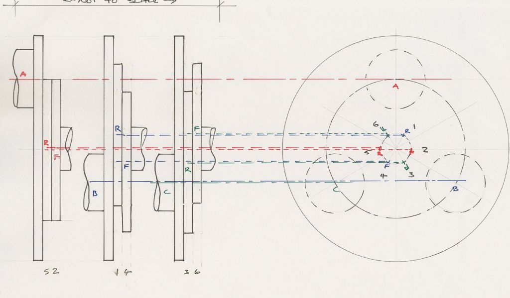

        Hi guys.
        I am confused again ( no surprise there then)
        I fancied having a go at this engine and I thought the crankshaft looks the most complicated bit so if I can do that the rest should be reasonably easier,
        BUT, I can't get my head round how the ends are marked out.
        Am I to assume that there are 10 centres marked on each end?
        3 for the cranks, 6 for the cams and 1 for the centre.
        I laid it out on a piece of paper and it looks awfully crowded.
        Any help and guidance is appreciated.
        Cheers
        Roy

          #91899
          wheeltapper
            @wheeltapper
            Thanks for that Jason, the other challenge seems to be making sure you use the correct centres so the right cams go with the right crank.
            Could be fun indecision
            I can't figure out which of the two centres for each cam relates to the position of the cam on the shaft.
            get that wrong and you have two cylinders going forward and one going in reverse.blush
            Cheers
            Roy
            #91900
              It wants drawing out a few times larger than actual size. And then make a note of which way will be forwards then say make all the cams that are forward of the crank the nearest the web and all those reverse the furthest from the web.
              As all the valve chests are on teh same side of the cylinders so long as you use the same relationship for each pair it won't matter which is forward and which reverse.

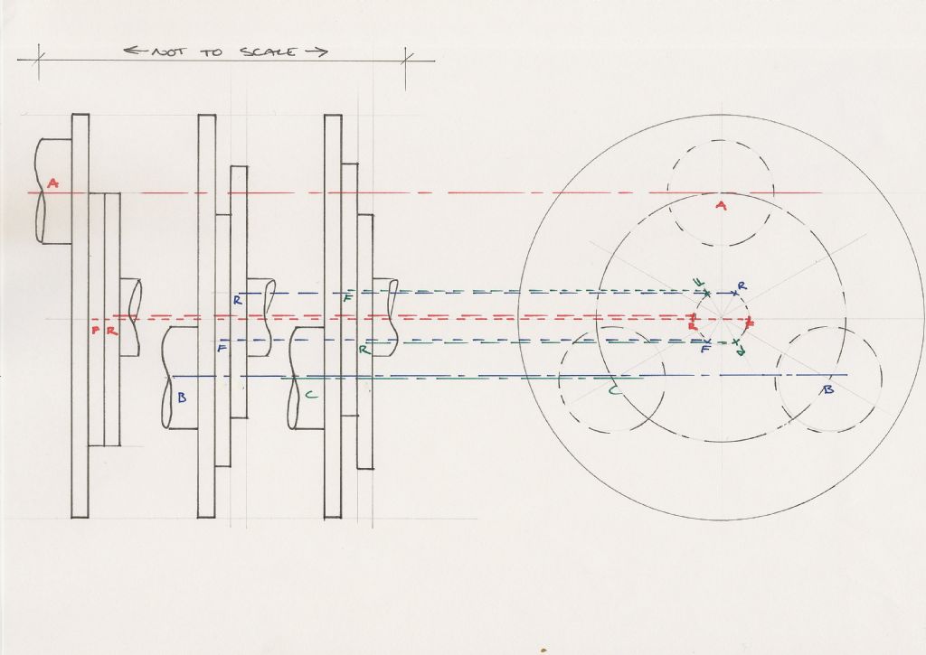

                  #91907
                  Gunnar M
                    @gunnarm
                    Hi!
                    I make a drwing for you, hope it help.
                    Crankshaft markings
                    Regards
                    Gunnar
                    #91914
                    wheeltapper
                      @wheeltapper
                      Thanks, it's all becoming clearer now.
                      Roy
                      #91915
                      Sub Mandrel
                        @submandrel
                        I don't think Morgens made it very clear how /why the eccentrics are set out the way they are.
                        #91916
                        David Clark 13
                          @davidclark13
                          Hi There
                          Three crankpins as shown on the drawing.
                          So, at 120 degrees apart.
                          Eccentrics at 90 degrees to the crankpin, one each side.
                          Simples.
                          regards David

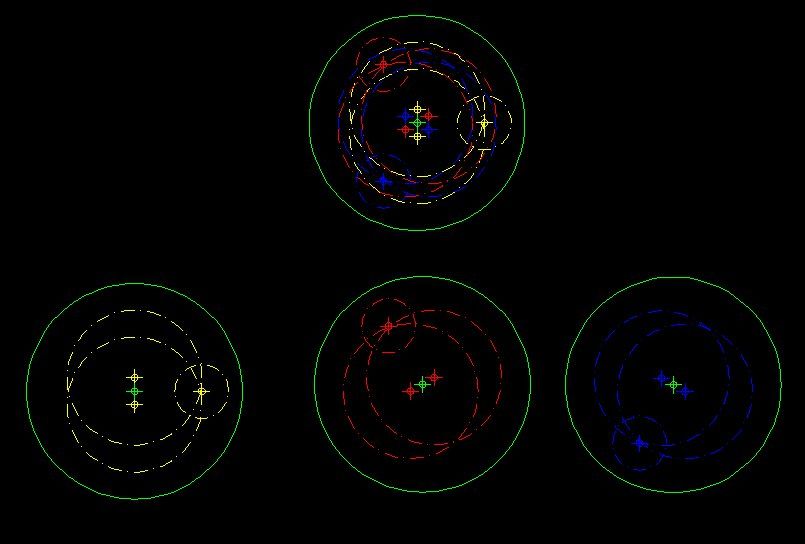

                          #91920
                            Well Gunnars sketch shows how each pair relates to the crank but there is still a chance of getting the forward & reverse eccentrics transposed. Hopefully this will show you how each of the six eccentric centres relates to the position along the crank.  As I have drawn it my reversing lever will be the opposite way round to Morgens but as I said so long as all three pairs of eccentrics are consistant it makes no difference as there is no lead or lag to the eccentrics. Click to enlarge.
                            Triple eccentric layout
                            Note the drawing of the right hand pair of eccentrics in the mag is wrong, I susspected it earlier but now I have drawn it out it is definately wrong. The amount of throw shown should be the same for middle and R/H not larger on the R/H crank.
                            J
                            Edited By JasonB on 01/06/2012 20:54:30

                              #91923
                                I've altered it to be timed like Morgens, will stick up the pic in the morning.
                                #91943
                                  Reveised drawing below for those that want it timed as per Morgens.
                                  Revised Triple Layout
