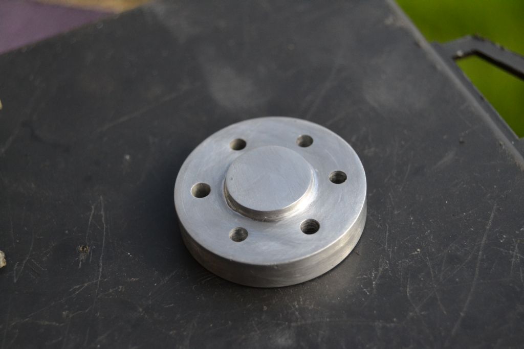

      After a while thinking about it I decided to stick with the 6 hole version that I've already made and hope I have enough room in the cylinder walls to drill and tap. There's only really one hole near the base mounting face that is risky but I think with care it's achievable so here's how it went
      Firstly I gave the cylinder side of the head a tidy up, I'd cut this face off in the lathe by parting it off so it needed a bit of filing and emery paper to clean it up a bit

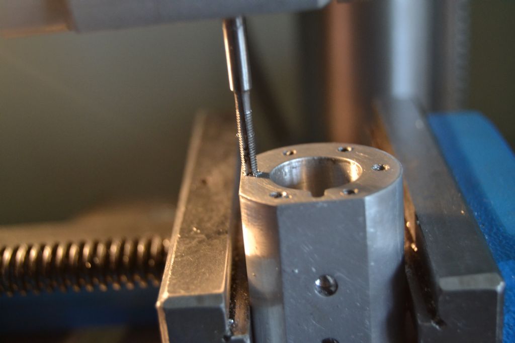

      Next came the bit I wasn't looking forward to – drilling the cylinder block. Since the head mounting holes are slightly out of line I used it as a template for locating my drill, although I forgot to take a photo.
      Anyway you get the idea and can now see that it's only the hole against the base mounting face that is likely to cause problems. I did cheat a bit by putting 2 thin shims under one side of my drill vice to try and coax the drill bit to cut very slightly inward.
      Similarly with the tap I've tried to gently persuade it inward – so far so good.
      Maybe not precision engineering at it's finest but I did get away with it – just.

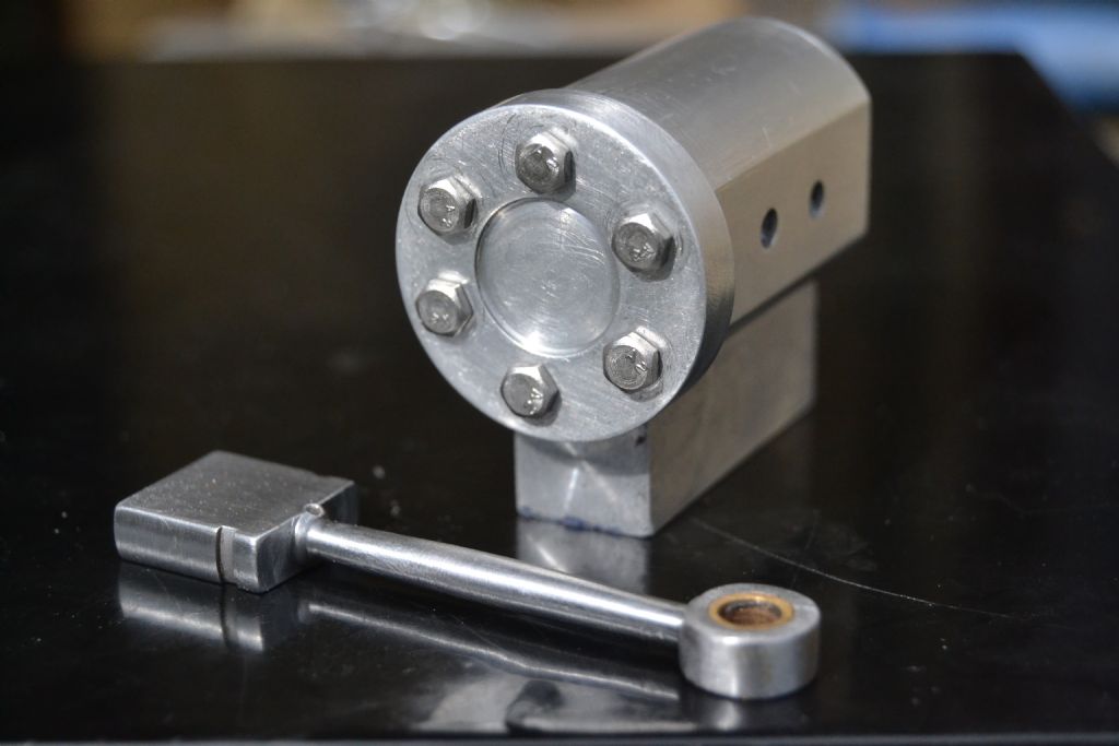

      All holes tapped and head bolted on.
      With hindsight I think I was pushing my luck a bit trying to get 6 bolts in rather than 4, if I was to make another of these engines I'd be inclined to stick to 4 holes next time.
      Having said that, it did turn out ok and although one of the holes is a tad out of line I'm pleased with the result.
      In doing the head this way I've now committed myself to doing the other end of the cylinder the same way but next time might make the radius of the bolt ring a tiny bit smaller without it being visually noticeable.

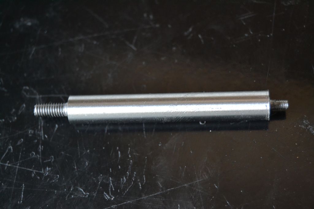

        Having made one cylinder cover I decided the next obvious step was to make the piston rod end cover. This part is very similar to the cylinder head cover but with the addition of the piston rod hole and its brass guide.
        I made the brass support guide from a 10mm hex brass bar drilled out to 4mm and threaded on one side to an M8 thread.

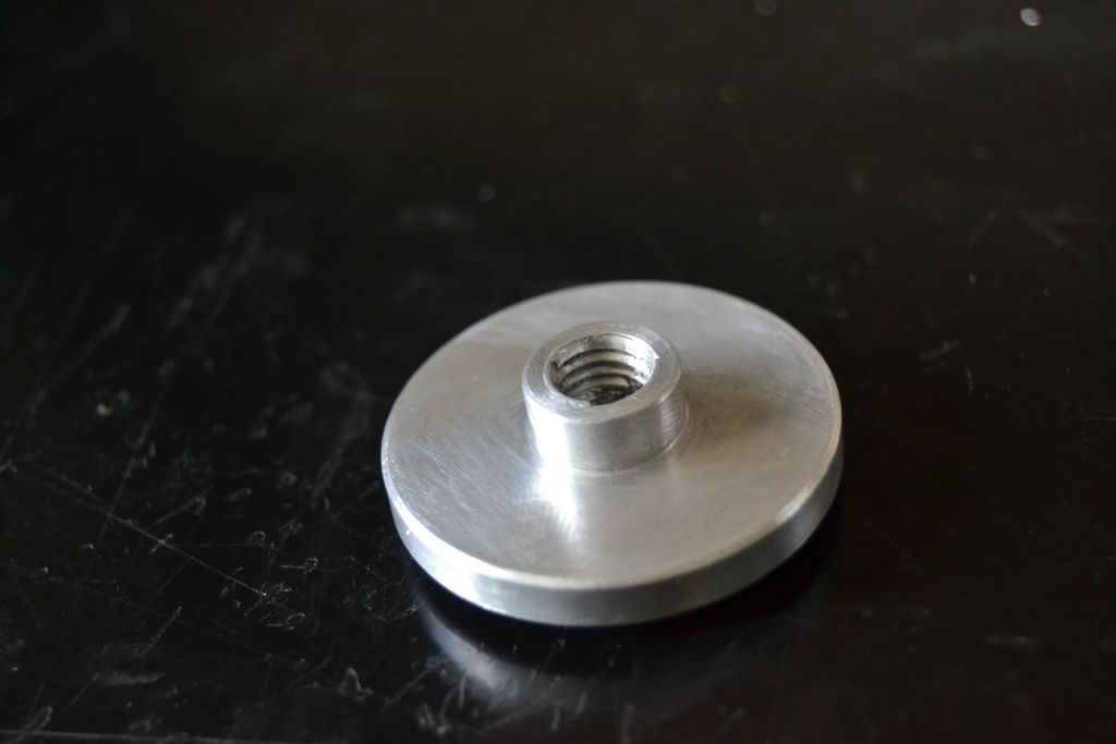

        Having then parted off the guide I began on the cylinder end cover, firstly by turning to diameter and facing the end then drilling out the central bore for the piston rod.
        Part of the central bore needs opening out to allow a thread to be cut to accept the brass guide.
        Next job part off leaving a short raised spigot to fit align in the cylinder.
        My parting tool doesn't have enough reach so the last bit was hacksawed then filed by hand – leaving this.
        Not a very good photo but you get the idea how it looks once drilled and fitted. Still needs a bit of polishing up but the fit is good and I'm hoping all is going to plan

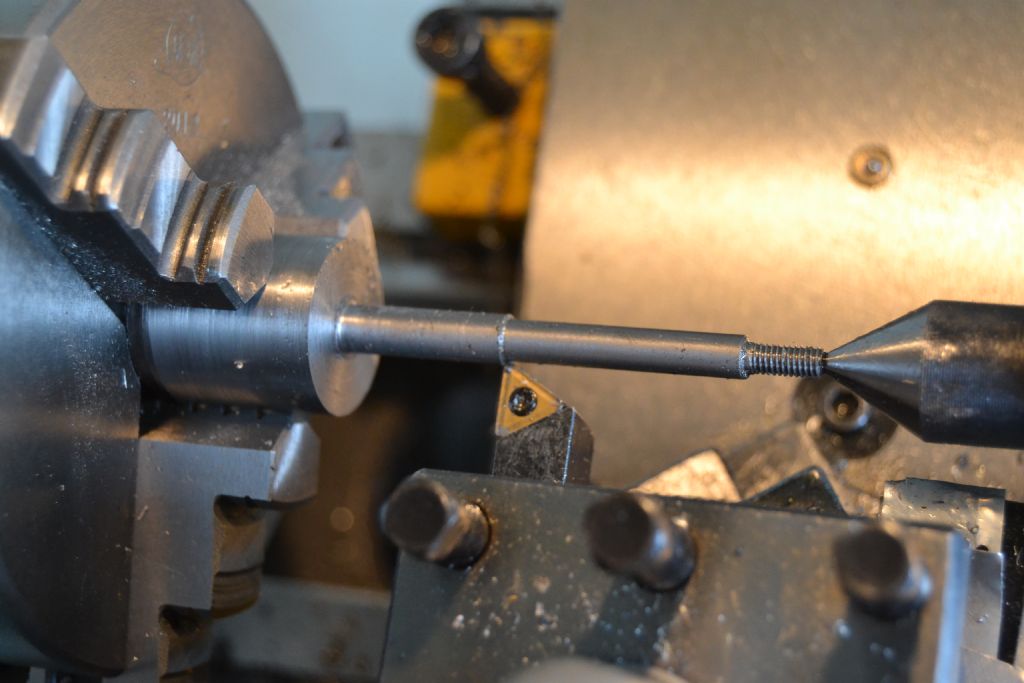

                    With a lot of distraction today I didn't get as much done as I expected, I had intended to try and complete the piston rod and the piston itself. I only managed to get the rod done but it's now complete and as I took photos I thought I may as well post them.
                    The rod is simply a silver steel rod with an M3 thread for the piston at one end and an M4 thread for the crosshead at the other. I had hoped to try and make the piston and use it as an arbor to support and drive the rod held against a tailstock centre. I thought this would allow me to kind of machine the piston and rod as one item ensuring good a good concentric fit. However because of the way the piston is threaded at one side only I decided it was going to be easier and (hopefully just as good) to make a temporary steel arbour to turn the rod.
                    First I cut an M3 thread in one end of the silver steel.
                    Next job, make a small hole in the other end for the tailstock centre and turn to size for an M4 thread – this will be the crosshead end.
                    I then made a temporary M3 threaded arbour to both support and drive the rod for turning – this was the procedure I had considered using the piston for but decided against.
                    It's the first time I've ever cut silver steel and found it a bit tougher than other materials I'm used to. I was hoping that by turning it down to a diameter of 4mm over a 60mm length that it wouldn't flex or try to climb over the tool bit. I found it worked well using a carbide bit, the finish wasn't great but I just wanted to get close to the required 4 mm dia then use a better tool tool and finish of with fine emery paper.
                    Once close to the diameter I started just using emery and a drop of oil till I got a good fit with the cylinder end cover and guide.
                    Finally arriving at this.
