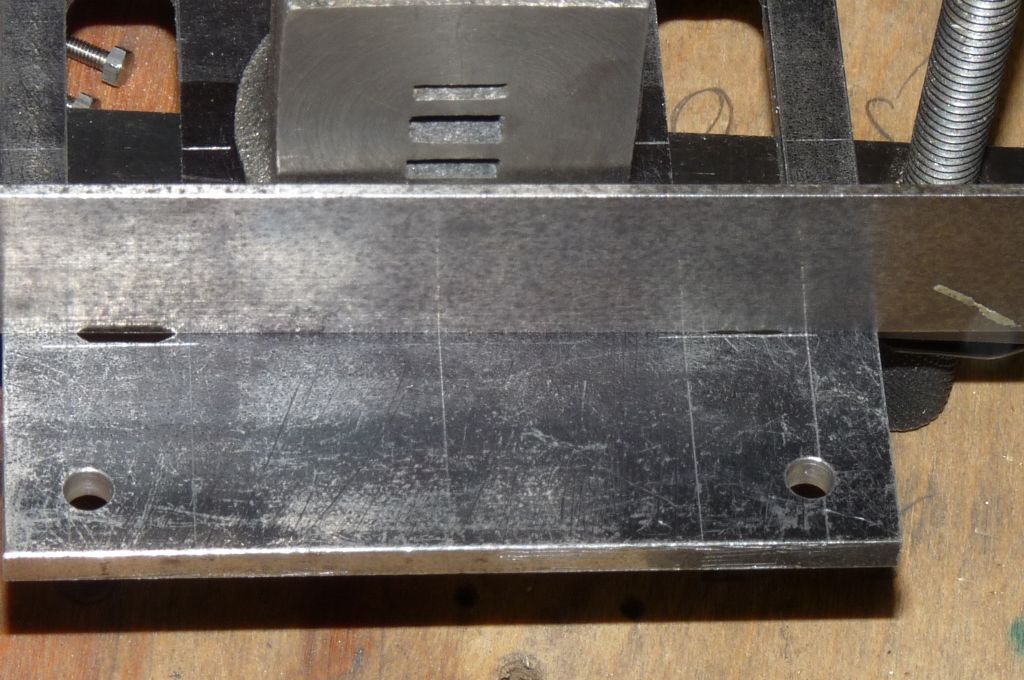

          #195176
          Steve Withnell
            @stevewithnell34426
            I got fed up tripping over that unfinished James Coombes, so took another swing at it –
            I've left the crankshaft over length whilst I get the eccentric and governor drive pulley fitted.

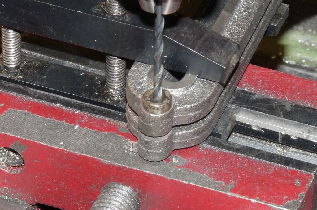

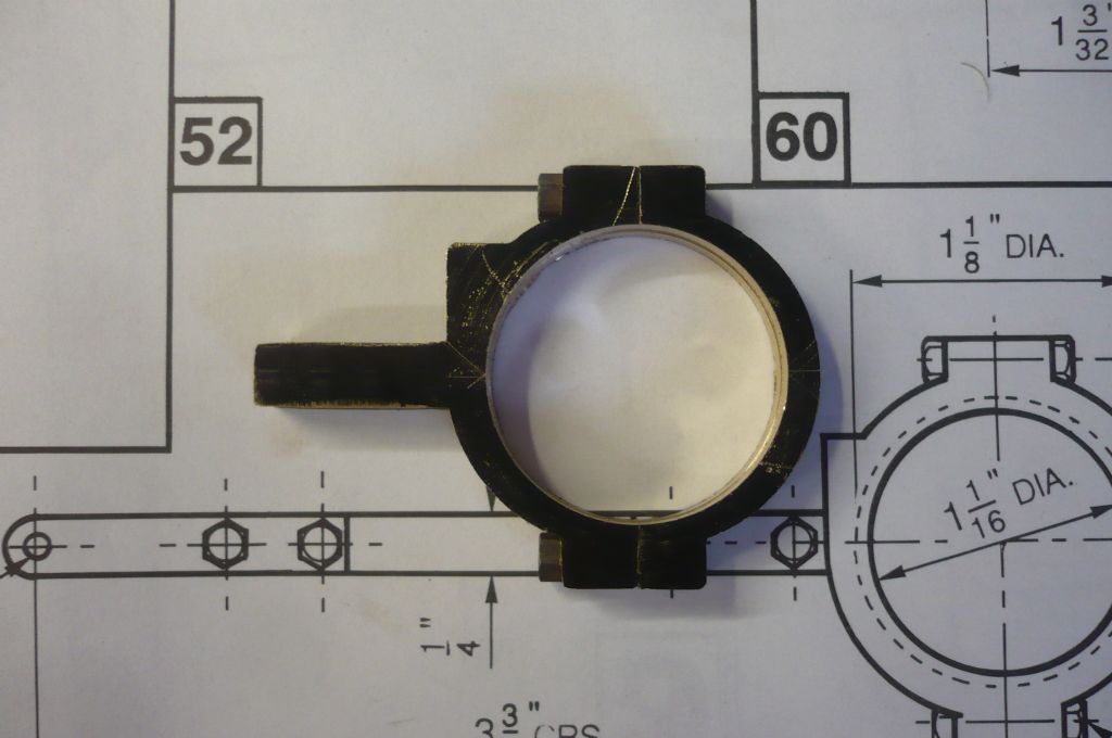

            Making the strap – same method as I used for the Victoria. When I made the straps for the Victoria, I split the extrusion with a thin slitting saw- this approach makes a nice tidy job, but leaves far more material in the strap than is required. It means that the outer of the strap looks quite 'egg shaped' and not concentric with the sheave.
            For the Coombes I used a hacksaw to split the strap extrusion and the cleaned up the two halves in the lathe, so now the strap will 'look right'. Well almost. The issue is purely one of aesthetics, no issue mechanically.
            I make the initial hole with a slot drill.
            Here is the tool I use for producing the groove to take the sheave rib – This was made from an old number stamp. I'm not sure how you can do jobs like this without grinding a bit of steel to the right shape.
            Now I've started, trick is to keep up the momentum!
            Steve
            Edited By Steve Withnell on 27/06/2015 20:46:16
            Edited By Steve Withnell on 27/06/2015 20:49:37

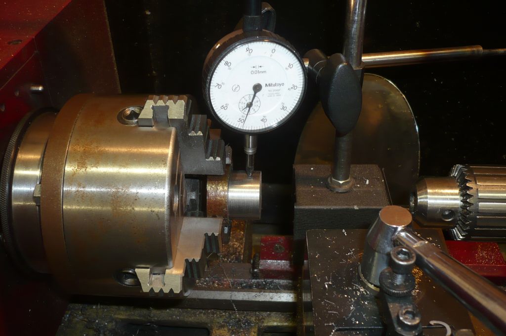

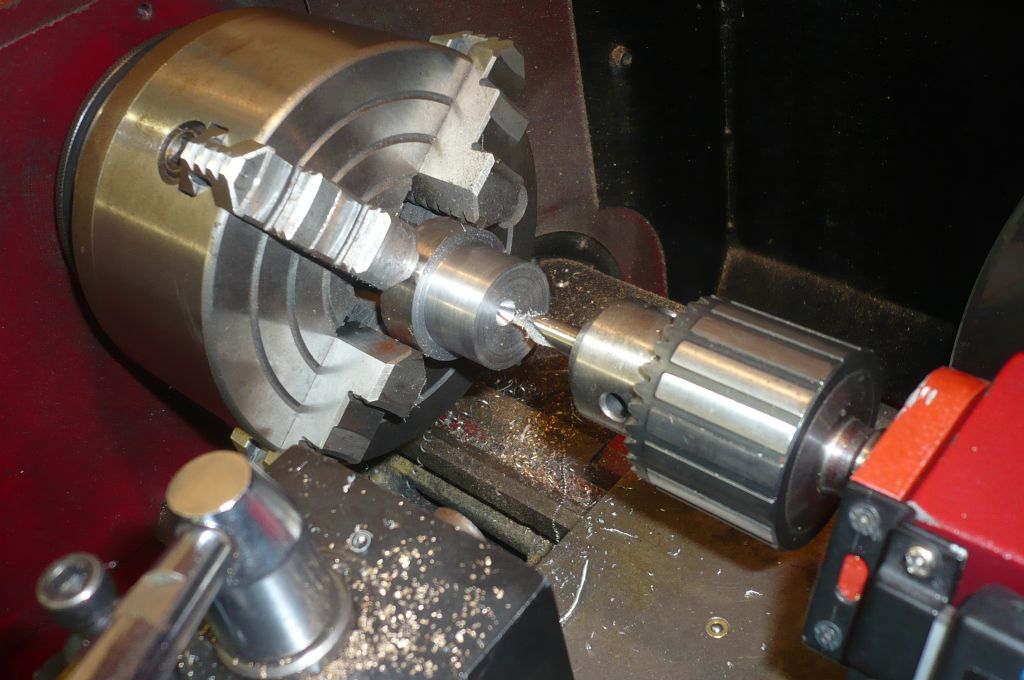

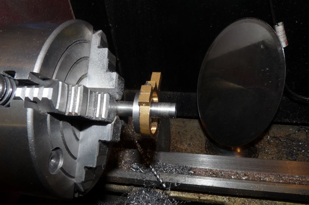

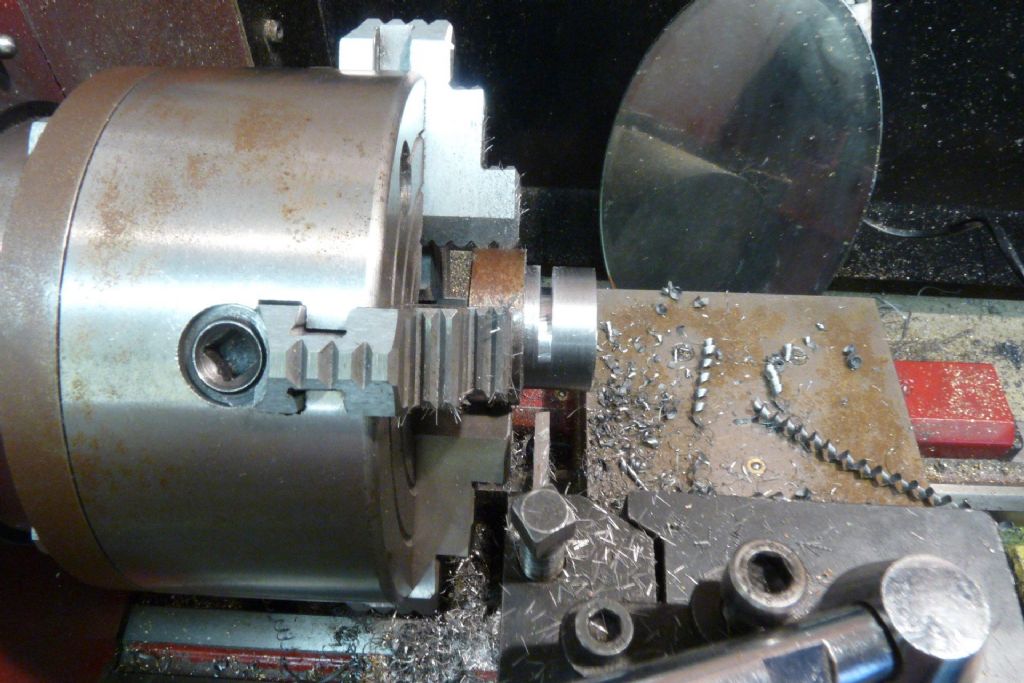

                              #196508
                              Steve Withnell
                                @stevewithnell34426

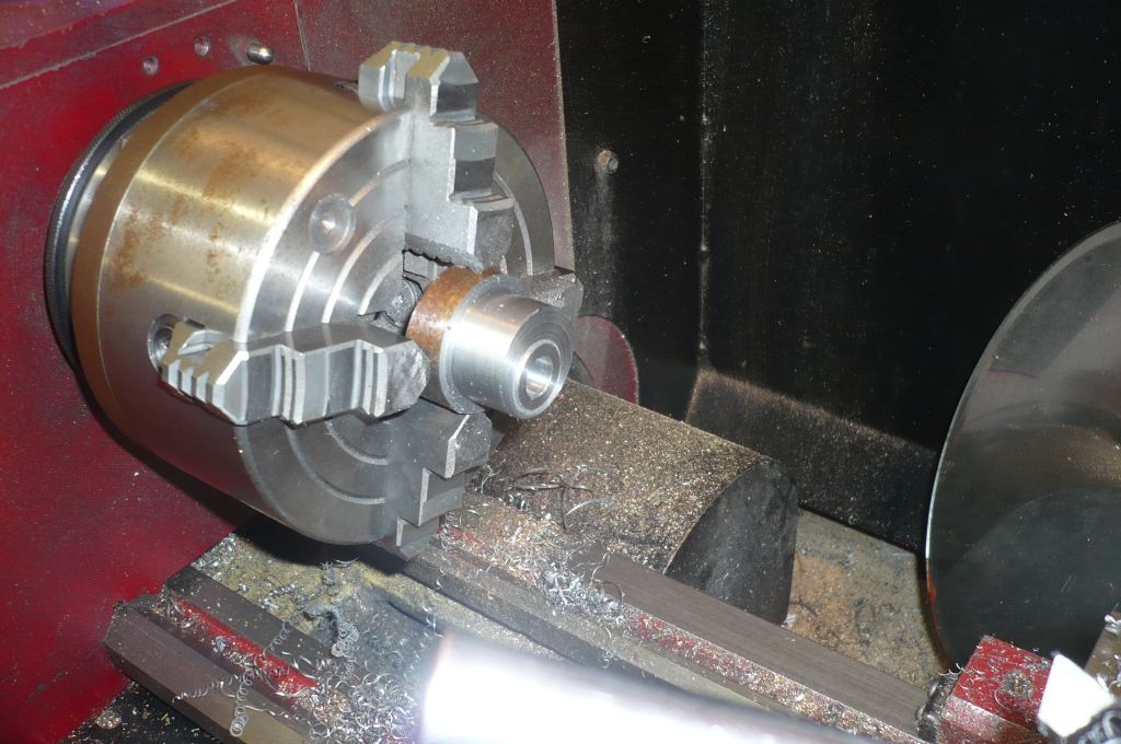

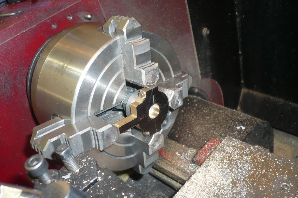

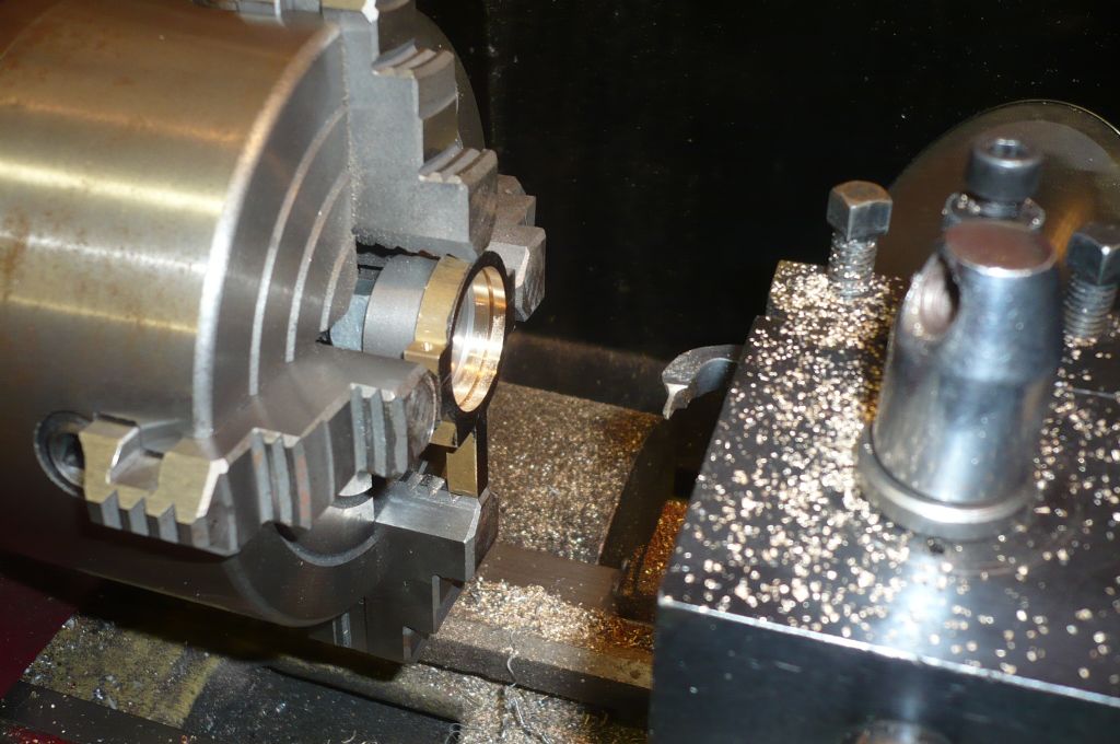

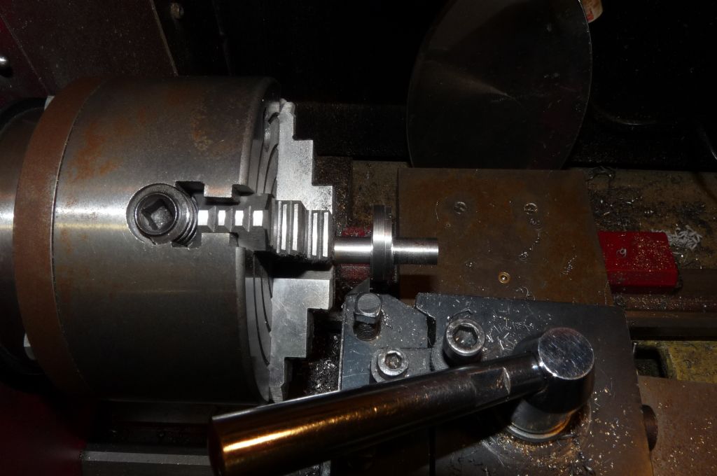

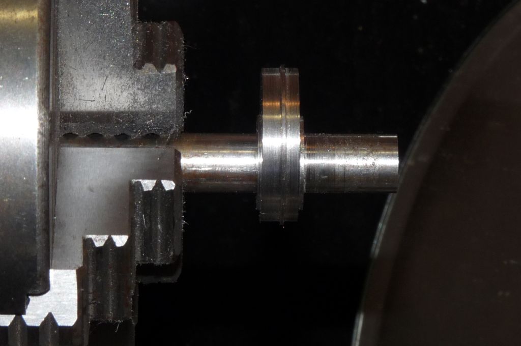

                                Made some new studs, a right fiddly job – 7/16" long, 7BA. Only six though, could have been worse. Anyway, the sheave has been finished. Because the finished engine will be fitted with the Stuart governor the sheave has no boss, this makes room on the crankshaft for the governor drive pulley.
                                The sheave is turned to its outside diameter from a short length of steel bar:
                                Then I set the eccentric throw:
                                And then bored the hole for the crankshaft so it's nice fit, then turned the little cheek that acts as a spacer:
                                Next step is to part off – on the eccentric. This is advice from Harold Hall's build of the Stuart V10, the logic being that the parting tool will break into the crankshaft hole evenly around the circumference. He also strongly recommends the use of a rear parting off tool, which I don't have.
                                Parting off didn't really cause any evil demons to appear, slow and steady, show no fear…
                                In order to finish off the machining, I used loctite to fix the half finished sheave onto a short length of bar, here I've already turned the first side if the sheave:
                                Using the eccentric strap as a gauge to ensure the diameter is correct:
                                Now the workmanship is exposed:
                                The sheave is a perfect fit with the strap, nitwit put a very nice slot in the wrong place in the strap…However, it does not matter and only we know . Because the sheave has no boss now to take a grub screw, the grub screw is to be fitted in the centre (ahem) of the sheave. If you think the sheave is looking a bit of a funny colour, it's because the loctite needed getting pretty warm before it would give up.
                                So that's the sheave done. Next installment will be fitting the cylinder to the table.
                                Steve

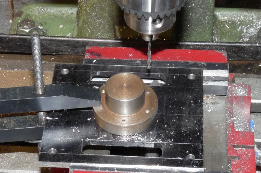

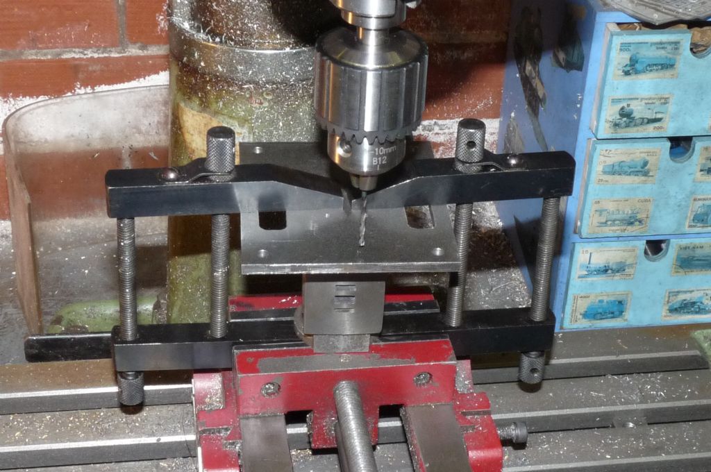

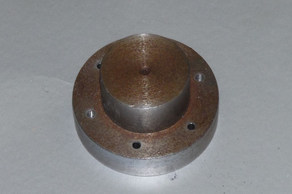

                                    #197067
                                    Steve Withnell
                                      @stevewithnell34426

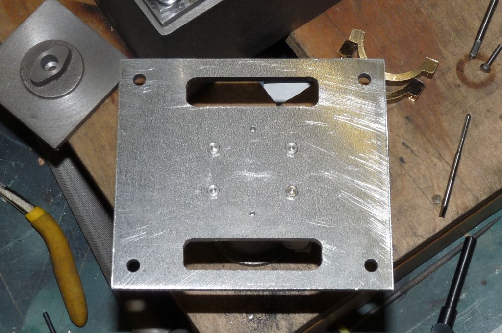

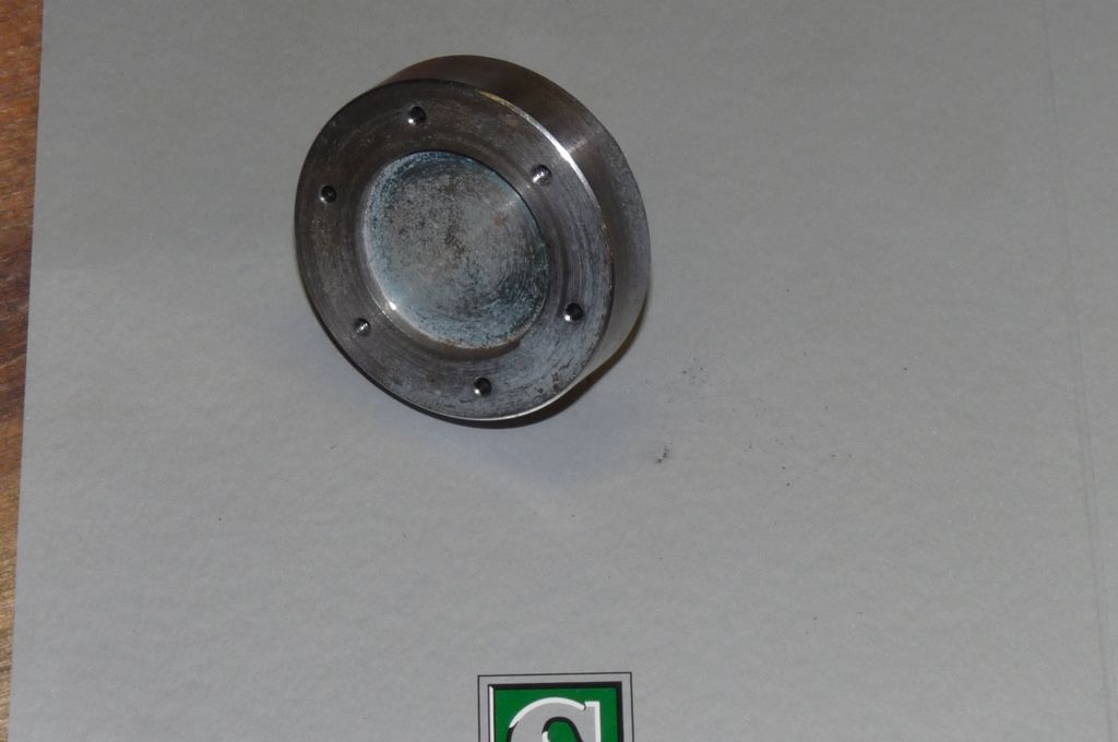

                                      Before I crack on with any more James Coombes build pictures, here is a very useful jig I made for the Stuart Victoria.
                                      The James Coombes and Victoria share the same cylinder, so the jig works for the JC too. First off I turned the spigot to the diameter I intended to bore the cylinder to. In this case that very popular metric value – 25.4mm.
                                      Since inner diameters are more difficult to measure than inner diameters, this is a simple gauge to test the cylinder bore.
                                      Then I mounted the sigot in the rotary table and drilled 7BA tapping size holes to the PCD indicated on the Stuart plan. Key point here is that if you bugger this up, it's just a short length of steel bar, not a very nice, expensive casting. Once the holes are drilled correctly, you then have a drilling jig, which reduces the chance of an upset with the cylinder by quite a bit.
                                      Then finally, the end caps needed drilling, so to ensure they were drilled correctly, I bored a shallow recess to take the inner spigot of the end cap and could again drill the end cap in exact alignment with the cylinder.
                                      Final trick is that because the jig is quite thick, having drilled the holes out clearance size, it can be used to keep the tap straight when tapping the cylinder.
                                      Bear in mind that even if you only have one cylinder, the jig will be used twice for the cylinder and twice for the end caps and once for the boring, so it has a lot of utility for such a simple thing. The next project on my list is a twin and I will definitely be making a jig to support machining the cylinders.
                                      Steve

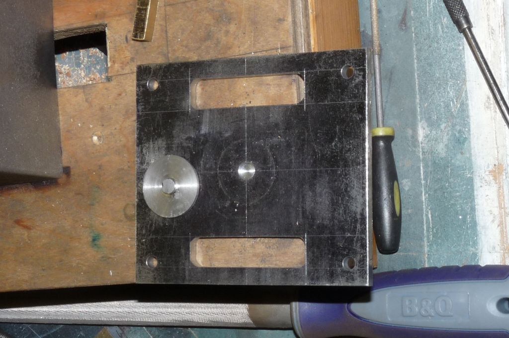

                                        Steve Withnell
                                          @stevewithnell34426

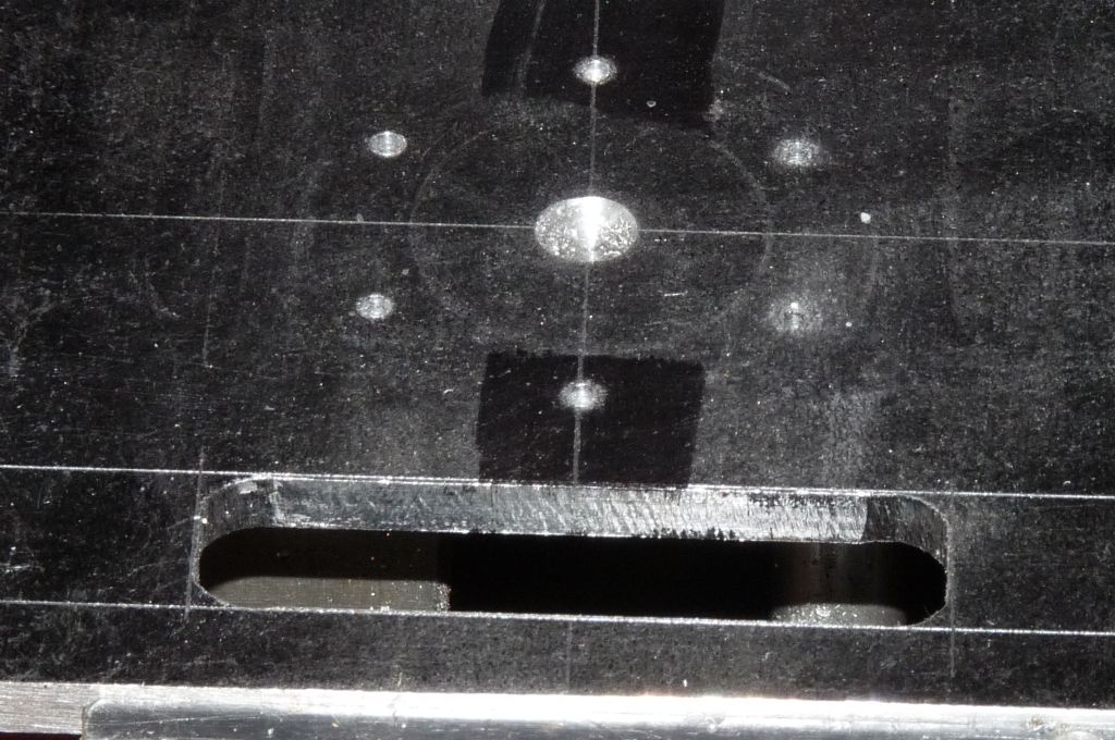

                                          Next step is to drill the "table" to mount the cylinder. If you remember, the James Coombes is a "Table Engine". It doesn't mean the engine sits on a table, like most models do, but rather that the Cylinder sits on an entablature – a table. The next challenge is to fix the cylinder square and dandy in the middle of the table, as it is the central, vertical axis through the engine.
                                          Not shown on the plan, but documented in Andrew Smiths guide to building the engine, he describes drilling a central 1/4" hole through the middle of the table, then making a little fitting which is a disc sized to the engine bore, with a turned spigot that is a push fit into the 1/4" hole. I didn't really like the idea at first and took a halfway house approach.p1030883.jpg
                                          I made a shallow 1/4" recess in the table and made a temporary jig to centre the cylinder
                                          Then I mounted the drilling jig over the jig so that's centred. The holes can be roughly centred against the marking on the table, but a final check is to setup to drill the rear most hole, then wind the table to the front most hole and the drill should pass right over that hole. If it doesn't, the jig needs rotating a bit. (Bear in mind the rear of my table plate is a datum and the rear edge of the vice is set to the axis of the mill).
                                          Then finally, the finished operation:
                                          The next thing I did was to drill through the table into the cylinder, the orientation is set by using a straight edge against the cylinder port face and the marking out on the table, and then clamping in down. The little jig is used again to to keep the cylinder central.
                                          Here is the work all clamped together and set up on the mill, for drilling through 7BA tapping size –
                                          Once the cylinder is tapped it can then be mounted on the table.  Two points to note here,  Stuart supply 3/8" studs,  which are too short,  so I made some 7/16" to ensure a proper hold in the cylinder (thanks to Clive on the stud length).   The clamps got in the way so I could not drill all six holes at one go,  and it had to go back on the machine to get at the final two.
                                          That's all for now folks!
                                          Steve

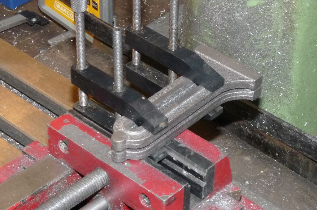

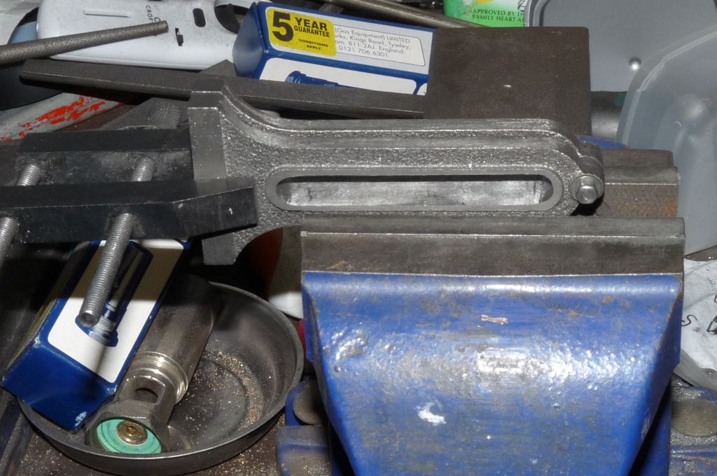

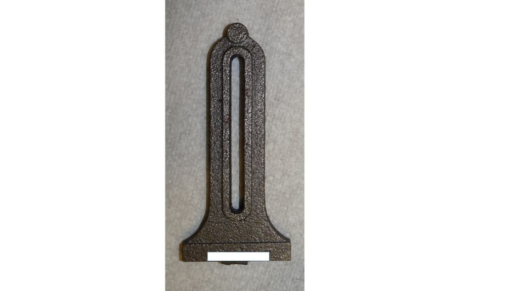

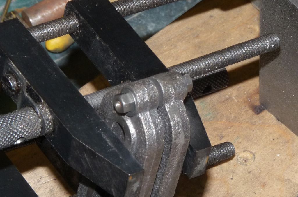

                                          #197190
                                          Steve Withnell
                                            @stevewithnell34426

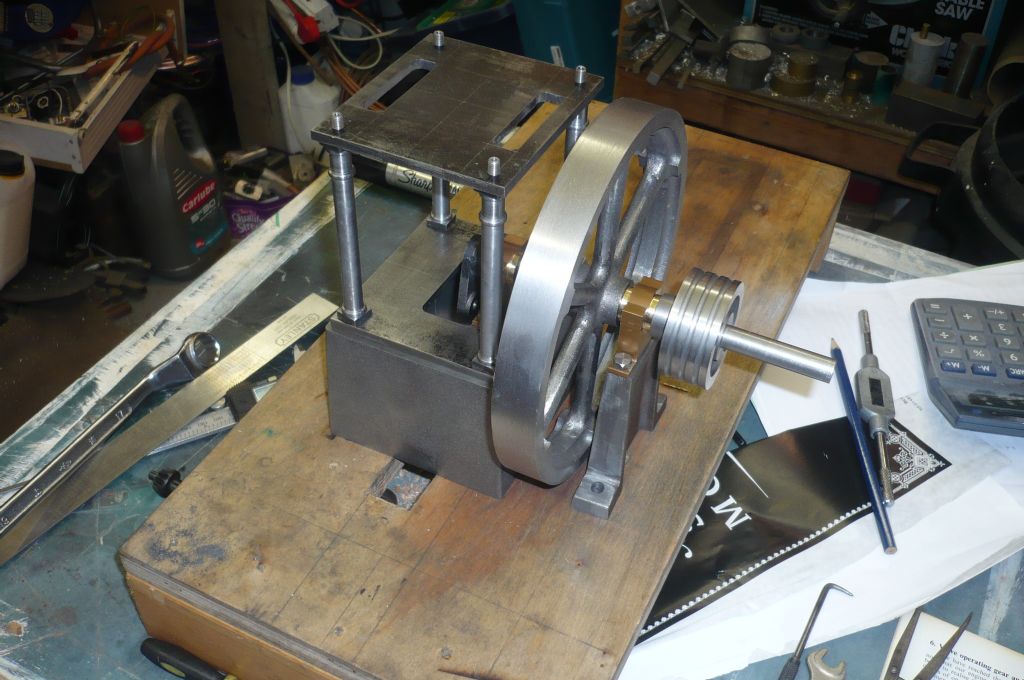

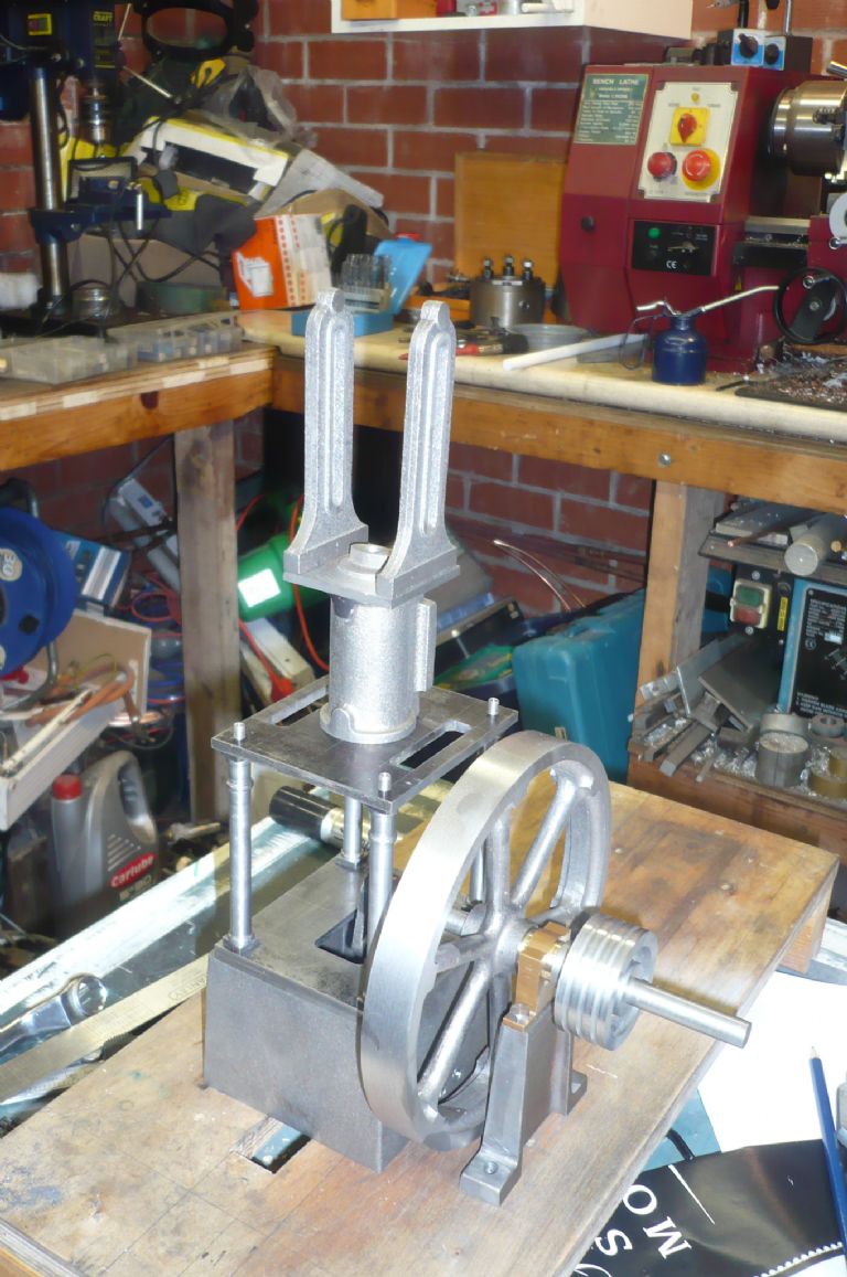

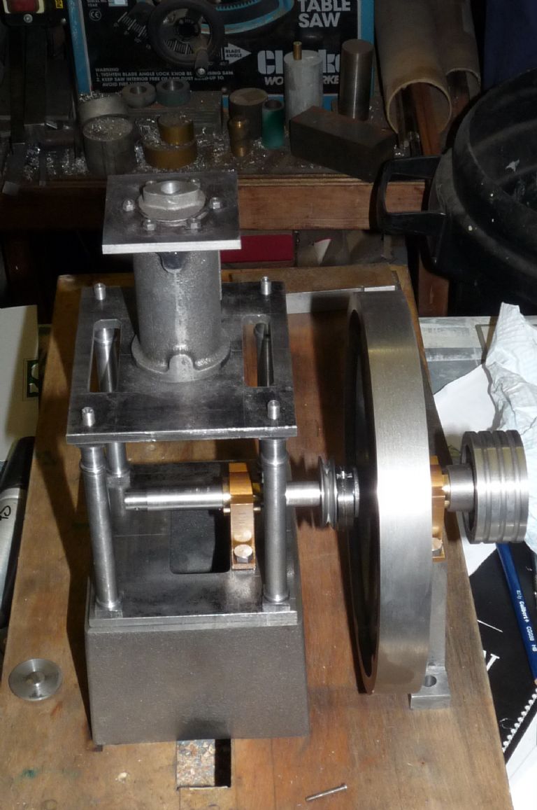

                                            So now we are here in the build:
                                            And I need to add the cross head guides (just perched on top to show the idea):
                                            What you get from Stuart in the kit are these castings. I've already had a whinge about how rough these are compared to the castings Stuart used to ship.
                                            First step is to give them a good fettling and get into a decent state. Then I clamped the pair together so I could drill a hole through the top and bolt them together. Difficult to see but now a lot of the rough edges have been filed flat (not optically flat, but homeworkshop amateur with a file flat)
                                            I then used a filing button to centre the hole – there is no where to measure from, so the hole just needs to be centred the best I could.
                                            Having made a short length of 5BA stud I then bolted them together so they are always aligned for the next operations.
                                            The next plan was to mill out the guide slots with an 8mm slot drill, but mine are not long enough, needs a long series type to go all the way through both guides, so resorted to filing them. This is really good filling practice!
                                            As the old boss used to say, "making good progress but more to do"… Problem with the crosshead guides is that they are a centrepiece for the engine, so not only have to work mechanically, but look good too…
                                            Steve

                                            Steve Withnell
                                              @stevewithnell34426
                                              Still filing… I keep rotating and flipping over the guides to try and keep everything square. I've also gone a bit over size – the centre part is just slack at 9mm, should be 11/64ths. Trick is not to make that worse whilst I get the ends to size. I am pretty close to done, I've been using the shank of a 9mm drill to gauge the size of the gap, so I think now I'll make the crossheads and use them as a gauge to finish out the fiing work.
                                              I've also now worked out precisely how I should have tackled this job!   Never mind,  filing is quite therapeutic…
                                              Steve
