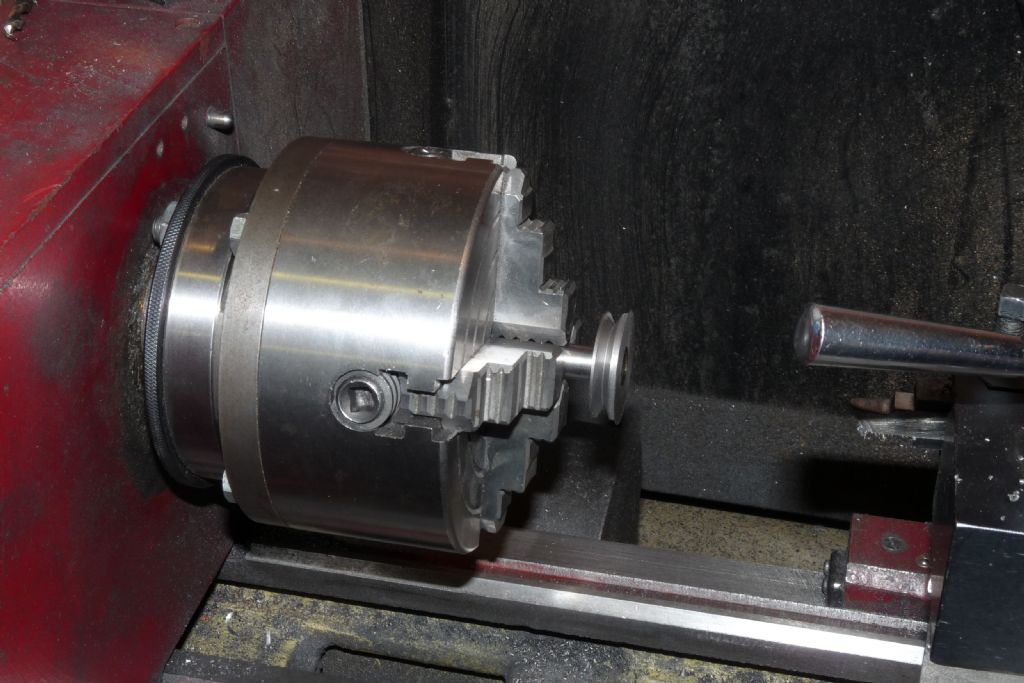

                        I was going to work on the cross head guides next, but discovered there are a couple more cast iron components to be turned. One is a pulley for the governor drive and the other is the piston itself.

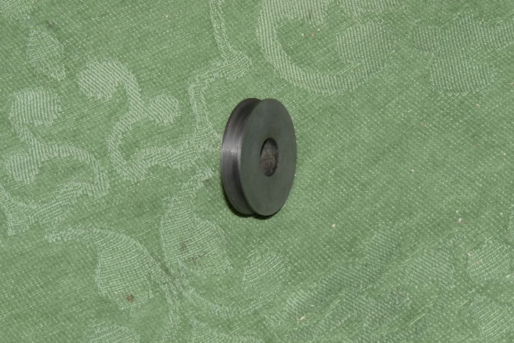

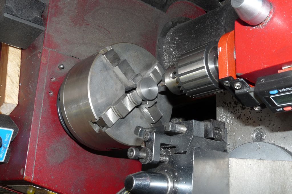

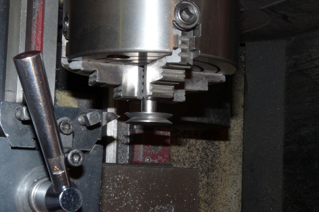

                        The pulley is made from a short piece of cast iron bar and I managed to find a very short piece of stock the right diameter. Having sought advice from the team in another thread, here is how I went about it. The pulley has a finished width of 1/4 inch and my piece of stock was just 12mm wide.
                        I had initially thought to use a tapered mandrel, but Jason suggested there might just be enough length to avoid having to make one. In this picture I've faced the front side and turned the outer diameter to size, then bored a hole for the shaft (there was an existing hole a bit off centre, so I couldn't drill and ream).
                        Although this is a four jaw chuck, it is a self centering chuck of much higher quality than the three jaw chuck that came as part of the lathe bundle. It's useful for square bar too.
                        I then decided to use a 60 degree single point threading tool to cut the "V". The "cheeks" of the pulley are only 1/32 inch, so when I turned the pulley over to face off the other side, there was not a lot of material to get hold of. I almost managed to get this done in one, you can see how little there machining is left to do. So then as Bob suggested, I loctited the pulley onto a piece of 7/16 bar and used the independant 4-Jaw to get it clocked to truth. The pulley is the minimum distance from the chuck that would allow me to get the DTI on the shaft. As you can see below. The pulley just needed facing off a little more –
                        Here is the set up showing the use of the single point tool. This is a form tool and so the machine is run very slowly. I had to run about 50rpm to avoid chatter. Here I'm just taking a light cut to ensure the "V" is square with the pulley on the shaft.
                        And the finally, the finished article: (well almost – it still needs drilling and tapping for a grub screw)
                        The loctite I used was "270", which is a "stud locker". I did degrease the shaft and pulley before using the Loctite and found that the bond was perfectly good to allow me to finish the machining after only a couple of hours to cure.
                        Once the machining was finished, I heated it up over a gas flame expecting it to drop off – which it didn't do. Although the Loctite residue was smoking it was still intent on staying put. I tapped the shaft out in the end, as I didn't want to overheat the pulley.
                        Steve

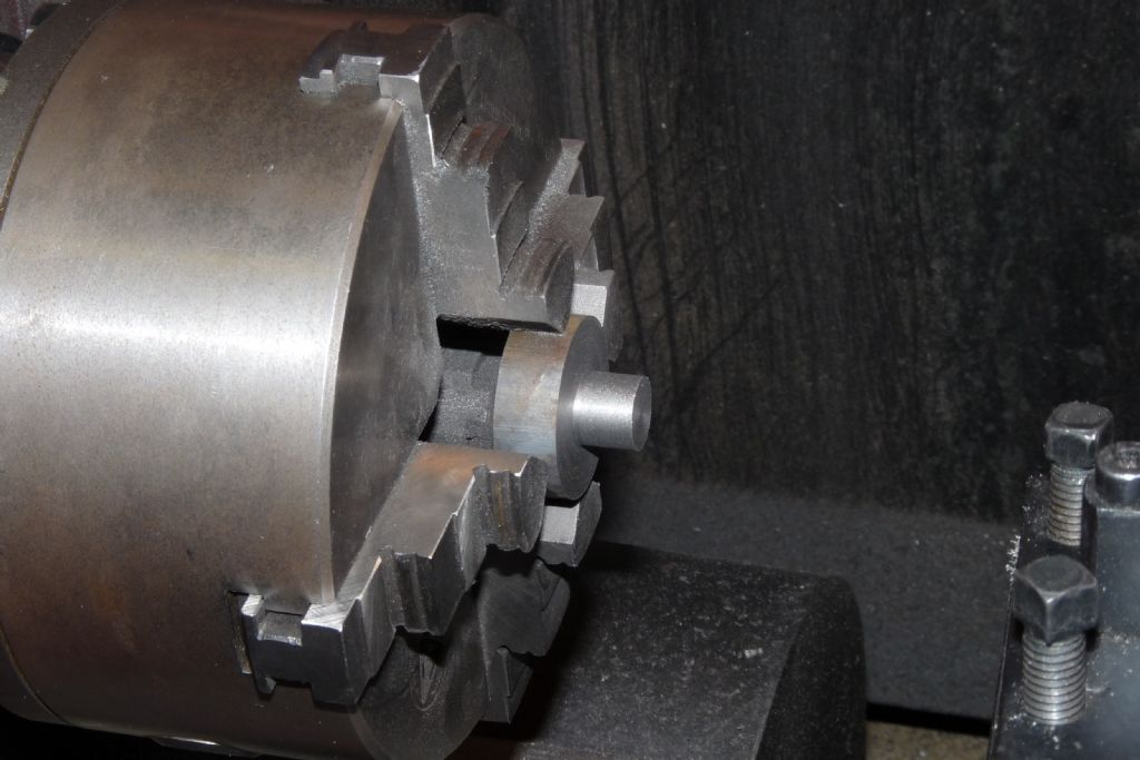

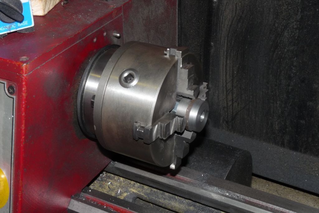

                          The last turned cast iron component (unless I missed one) is the piston. As shipped by Stuart, this is just a short length of cast iron bar. The process is pretty classic for piston making. The bar is chucked at about half its length, and a chucking spigot turned.
                          The piece is then flipped over and mounted by the chucking spigot and all the key machining is done with this set up. This means that the outer diameters and piston rod hole remain concentric, regardless of what the spindle / chuck runout might be.
                          First two turning operations are to face the piston to length (1/4 inch) and to turn the outer diameter to a gnat's more that the cylinder diameter, this will finished later.
                          Next I centre drill the piston and followed through with a 5BA (3.3mm) clearance drill.
                          The plan shows a 1/2 inch recess to accomodate the fixing nut at the end of the piston rod. This could be achieved using a little boring bar, but I used a 12mm (I don't have a 1/2 inch one) milling cutter to produce the recess. The diameter of the recess is not critical, just needs to be big enough to take the nut and a box spanner to tighten it up.
                          The next operation is to cut the groove for the "O" Ring to seal the piston in the cylinder. I did this using a parting off tool as a form tool and running the lathe very slowly, produced the groove. I made the groove a little deeper than plan, as with the Victoria I could not get the piston + "O" Ring into the cylinder.
                          With all that done, I cut off the spigot with a hack saw as close to the piston as I could, then mounted the piston in the lathe to face off the last remnants of the spigot. The piston does need to be "square" so the faces of the piston remain parallel, but it does not need to be concentric of course.
                          So now I have no excuse for not doing a deep clean and getting all that cast iron dust out of the lathe…
                          Steve

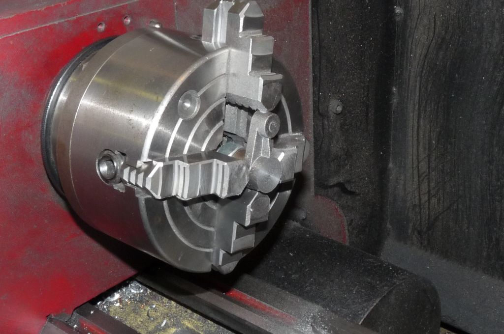

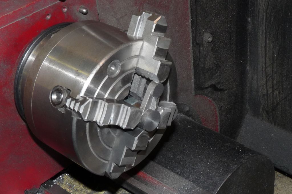

                              So now set up with the 4-jaw the first task is to face the eccentric strap sides, down to a thickness of 1/4 inch. Again, I'm using a backstop to keep the strap solid and square in the jaws.
                              A nice change from the cast iron, now the turning produces fountains of tiny golden chips!
                              The strap is not a casting, but a brass extrusion. It needs to been sawn into two seperate halves. When I made the straps for the VIctoria, I used a thin slitting saw on the Mill, being careful to remove as little material as possible. In fact, the extrusion assumes the strap will be hacksawed and filed to clean up, removing a significant amount of material.
                              The consequence of not taking enough material is that the outer edge of the strap is not concentric with the sheave. It makes no functional difference, but doesn't look as good as it should.

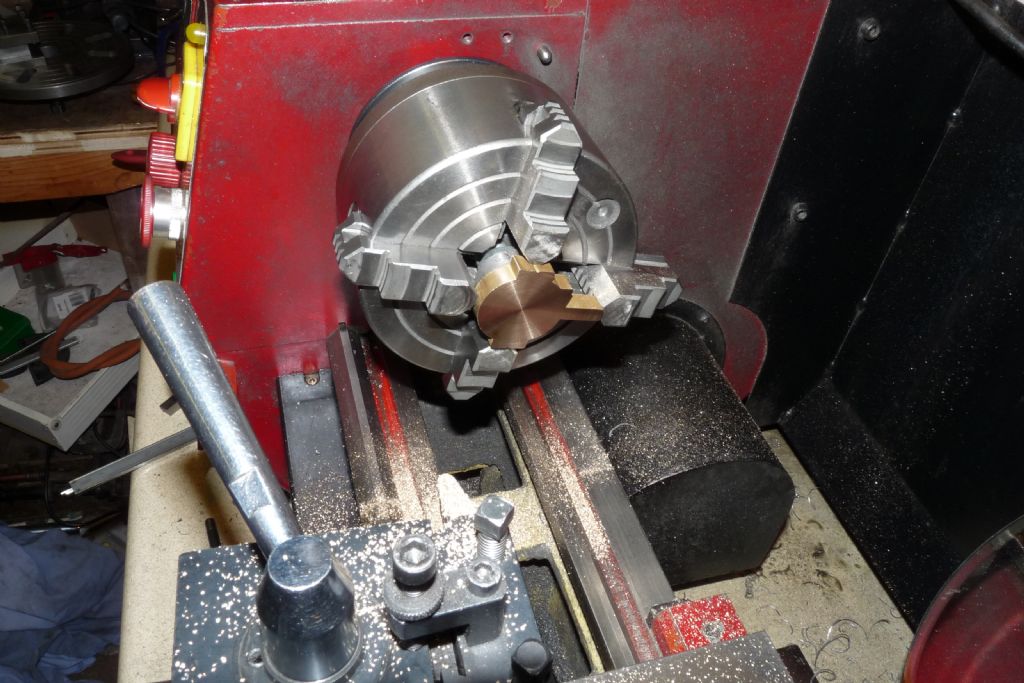

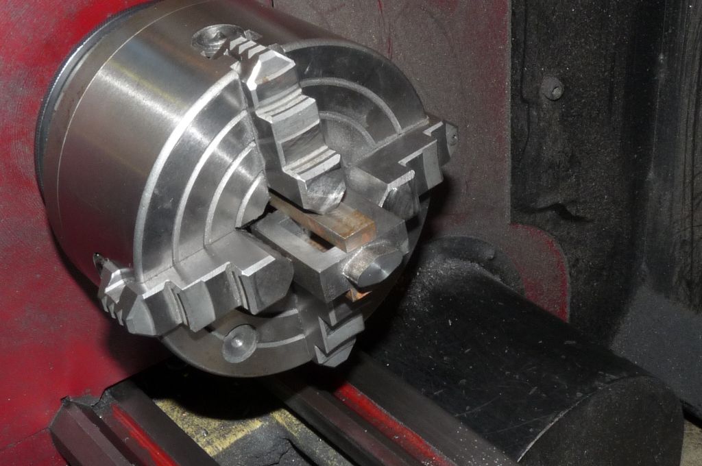

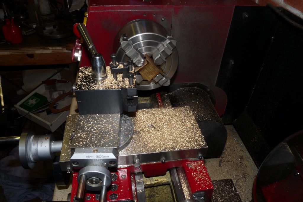

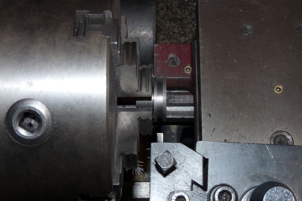

                                  Having faced down the eccentric strap, it seemed sensible to face off the bearing mounts to size too, as the setup is the same – press the workpiece against the backstop –
                                  Then face off both sides to dimension. There are two of these to do, once cleaned up, they can be marked out for boring the holes for the crankshaft. On the Victoria, I bored these holes over size and press-fit a phosphor bronze bearing, because it is harder wearing than plain brass. However, I think it overkill so will stick to plan for this engine. If the engine wears out the brass bearings, well I can fit PB bearings as a mid-life update
                                  Plenty of brass chips too –

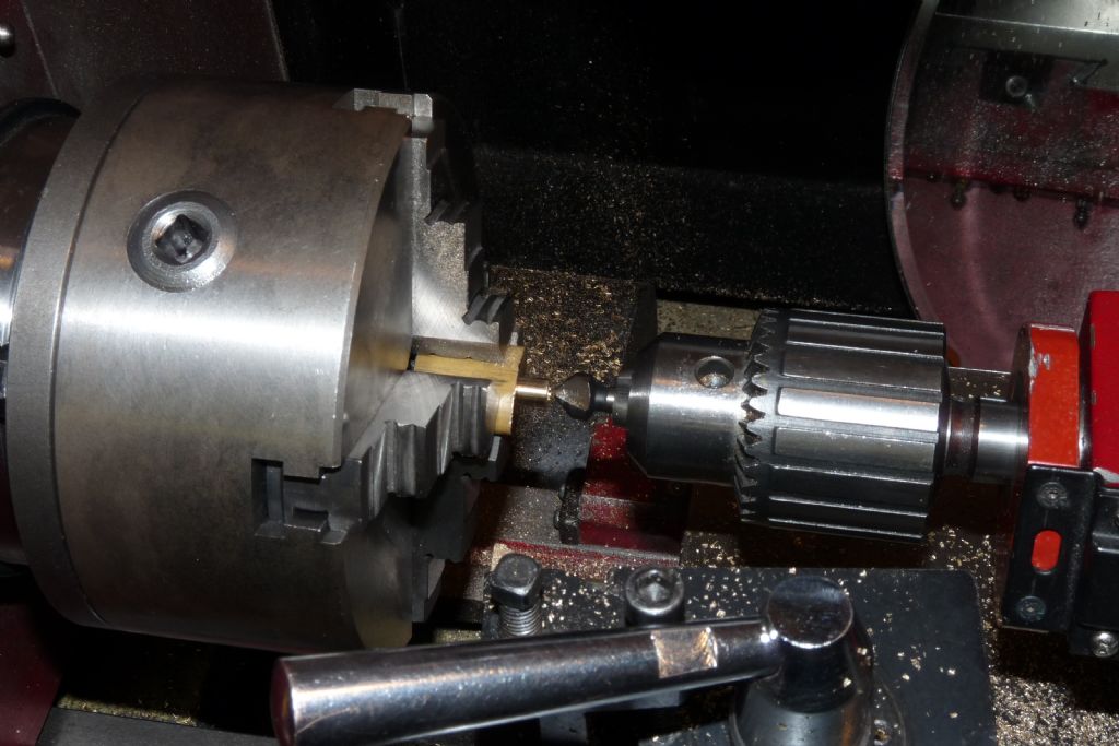

                                  Next on the list is to make the glands for the piston rod and the valve rod. These are machined from a brass oval extrusion. The nice thing about having a self centering 4-jaw chuck is that it self centres oval materials too.
                                  This is a spare bit of brass from making the Victoria. Having faced off the outer end, it's just a case of turning it down to produce a 1/4 inch diameter section, 1/4 inch long, then to drill, ream and countersink the opening.
                                  Finally, it needs parting off.
                                  That's the valve rod gland done, the gland for the piston rod is the same process, but with a couple of different diameters to cater for the larger piston rod.
                                  Because all of these operations are done at one setup on the chuck, run out is not a problem, all the machined surfaces being concentric.

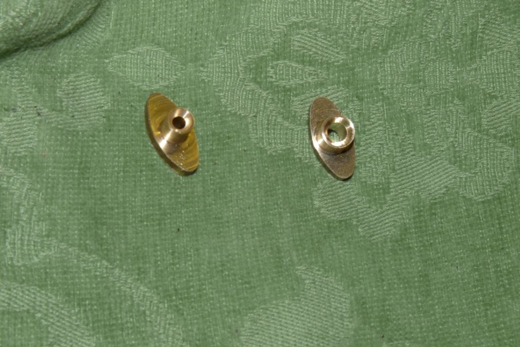

                                  #157324
                                  Steve Withnell
                                    @stevewithnell34426

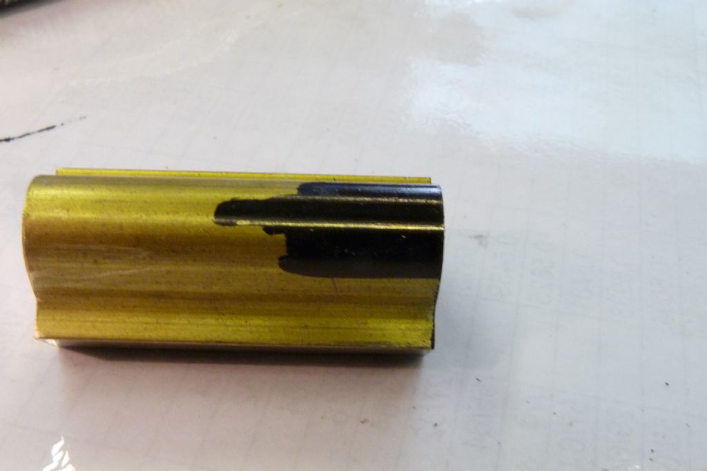

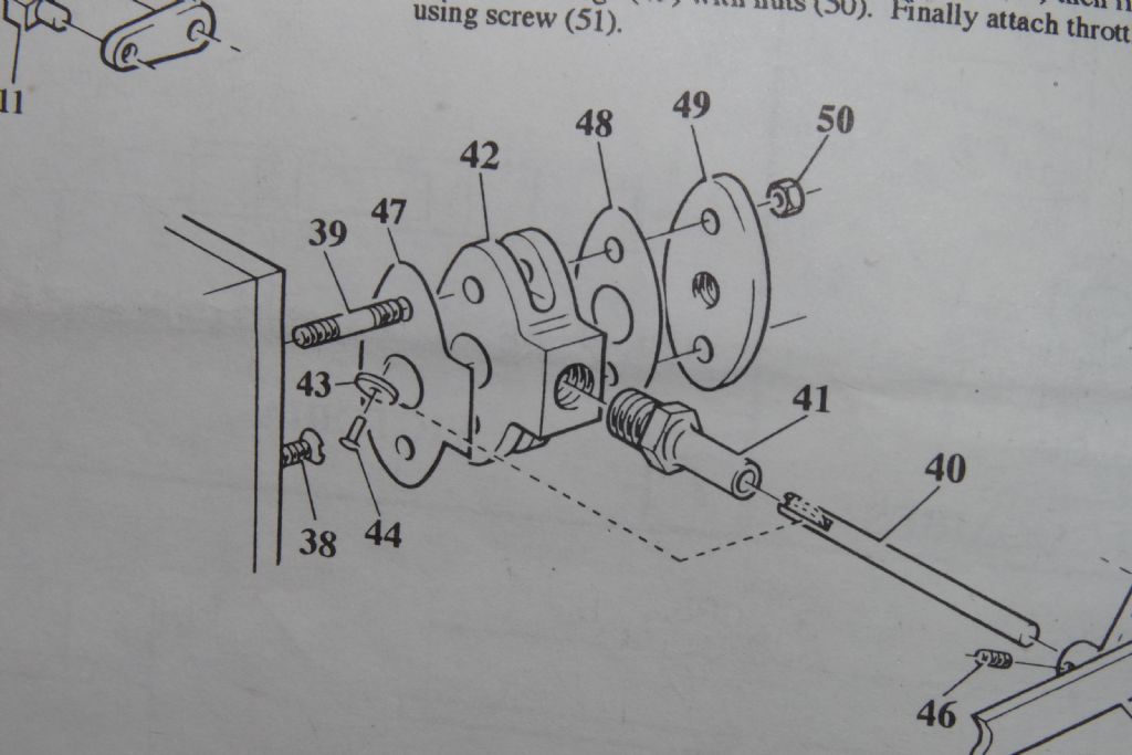

                                    Moving to the Governor plan, the inlet valve arrangement is quite clear.

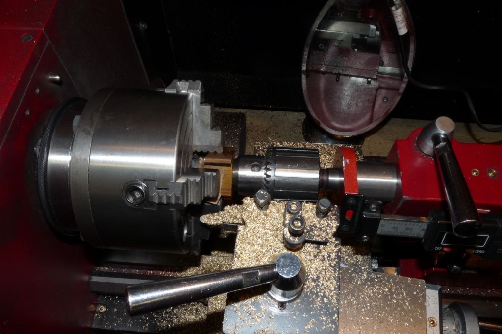

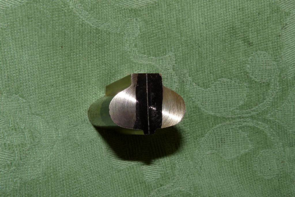

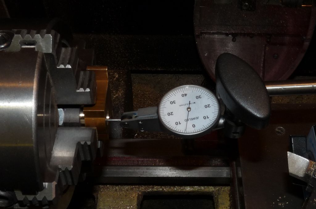

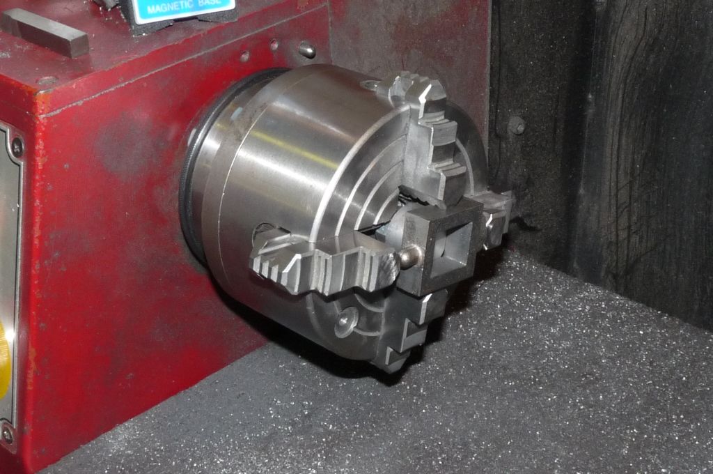

                                    The components 42 and 49 are machined from a brass extrusion. Finding the vertical centre line is quite straight forward, the horizontal centre line, less so.
                                    The elliptical section is not regular, so to find the centreline, I blacked the sides of the extrusion, then using a square on the wide flat section as a reference, I used the blade of the Sqaure to scrape a line which is then the high point of the section:
                                    That allows the horizontal centre line to be drawn. Next step is to use the 4-Jaw independent chuck to set up the centre of the extrusion. The 4-jaw self-centering chuck can't be used, as the elliptical section is not regular. A round nose tool is used to produce the shaped section.

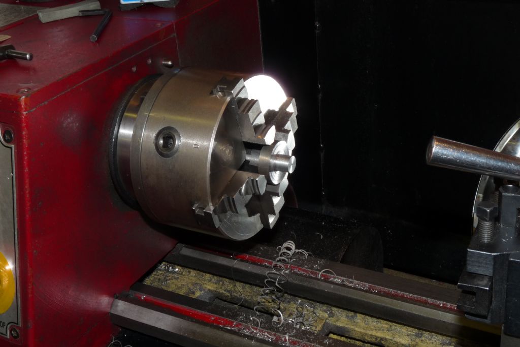

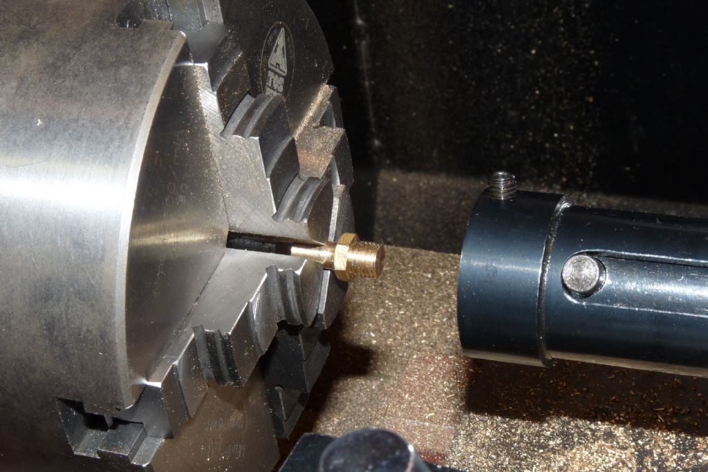

                                    Having drilled and tapped the inlet, I had planned to part off the flange, but I need a new parting off blade to achieve the depth of cut, so that will have to wait for now. The plan is to drill the mounting holes prior to parting off, so that the alignment with the body of the valve would be good.

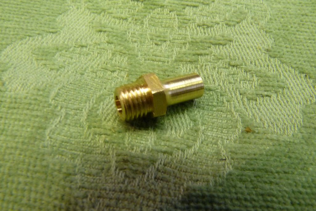

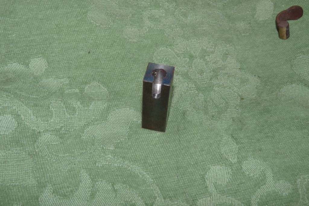

                                    Sticking with the brass bits for now, I moved on to component 41 in the diagram above. The material in the kit is a one inch length of brass hexagon, .36 inch across the flats. The machining sequence I used was to turn the straight section first, then to use that to as a chucking spigot. I then turned the end to be threaded, drilled and reamed the through hole and then ran a die down the section to produce the thread. I used a parting off blade to create a groove between the hex portion and the end of the thread.  This sequence is used to ensure the through hole is concentric with the threaded portion.   Any runout is then with the straight section which will not affect the functioning of the valve.
                                    The problem I had was that the die would not cut the full length because of the length of the taper section in the die. Turning the die over, the same taper section. Solution I used was to grind away one side of the die so that the taper was eliminated. Problem solved. The other problem is a mistake of my own making. The thread is specified as 3/16 x 26TPI, which I assumed was cycle thread (BSCY). However, it turns out to be brass thread (BSB). SInce I have the matching BSCY taps, it doesn't matter particularly.
                                    The finished part looks like this:

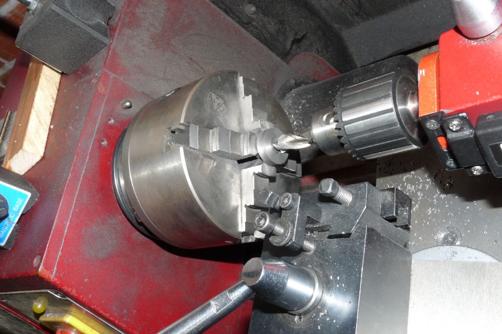

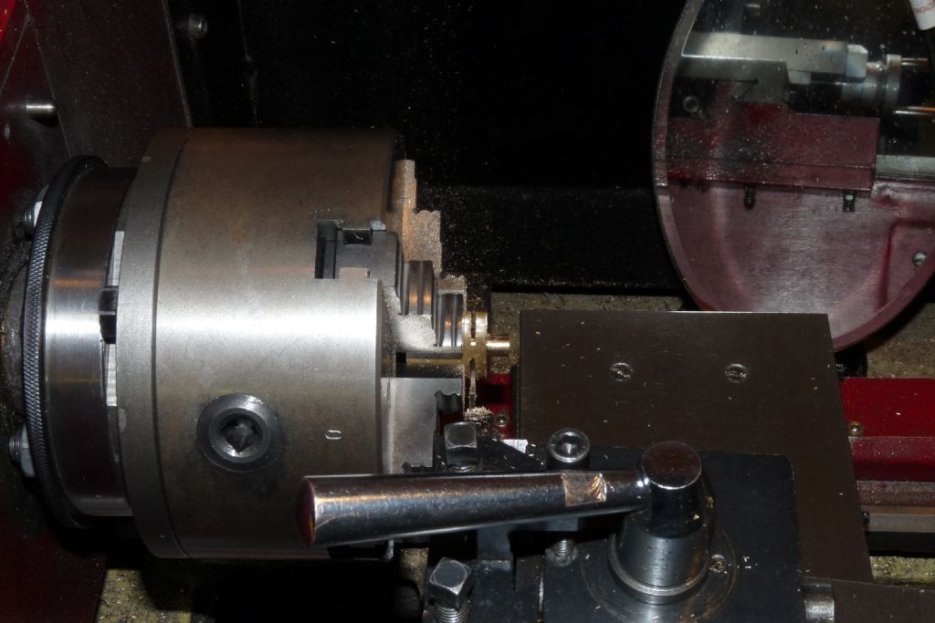

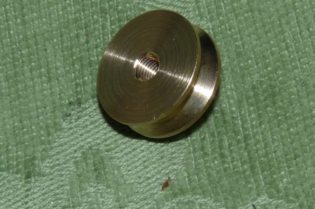

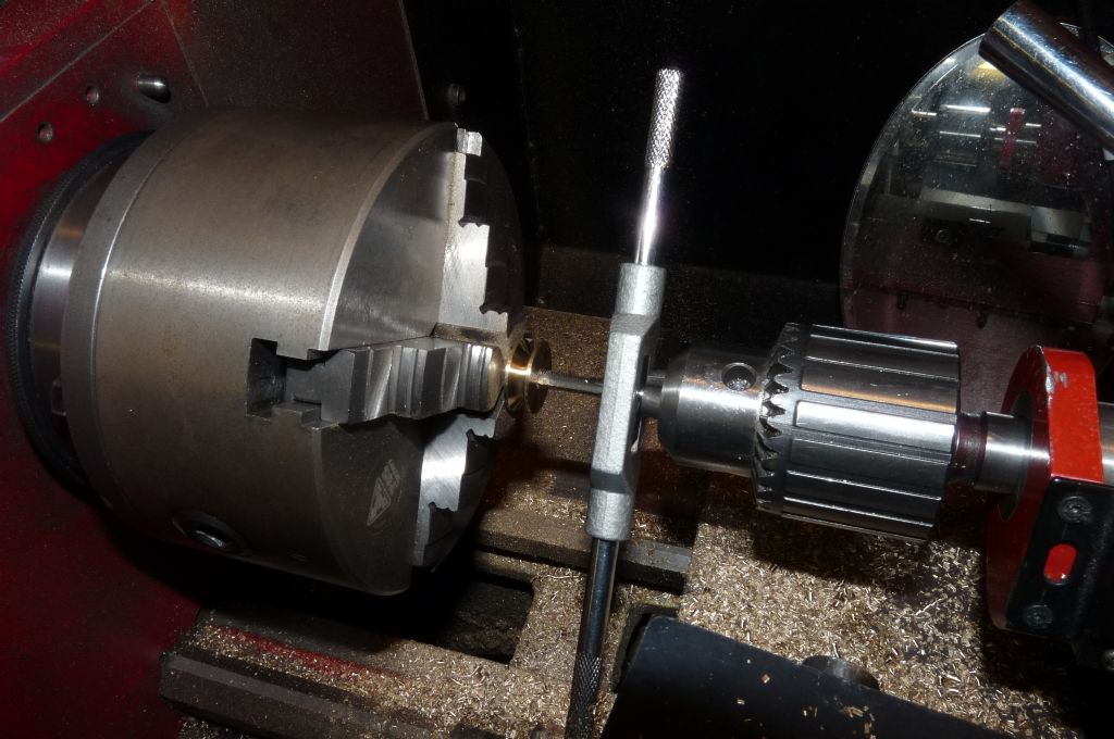

                                          Drifted off plan a bit, the brass pulley is part of the governor, not the engine, but anyway. The process is the same as the cast iron pulley I described earlier, except I had more material to work with. This pulley also has a 3/16 x 40tpi threaded hole through the centre. I've turned a little spigot to hold the blank and once more used a 60 degree single point tool to cut the groove for the drive belt.
                                          Using the tailstock to centre the tap:
                                          Cut off the spigot and face the side and it's done:
                                          I managed to drop it on the floor and apply a couple of scratches, so it will need a polish up before fitting.

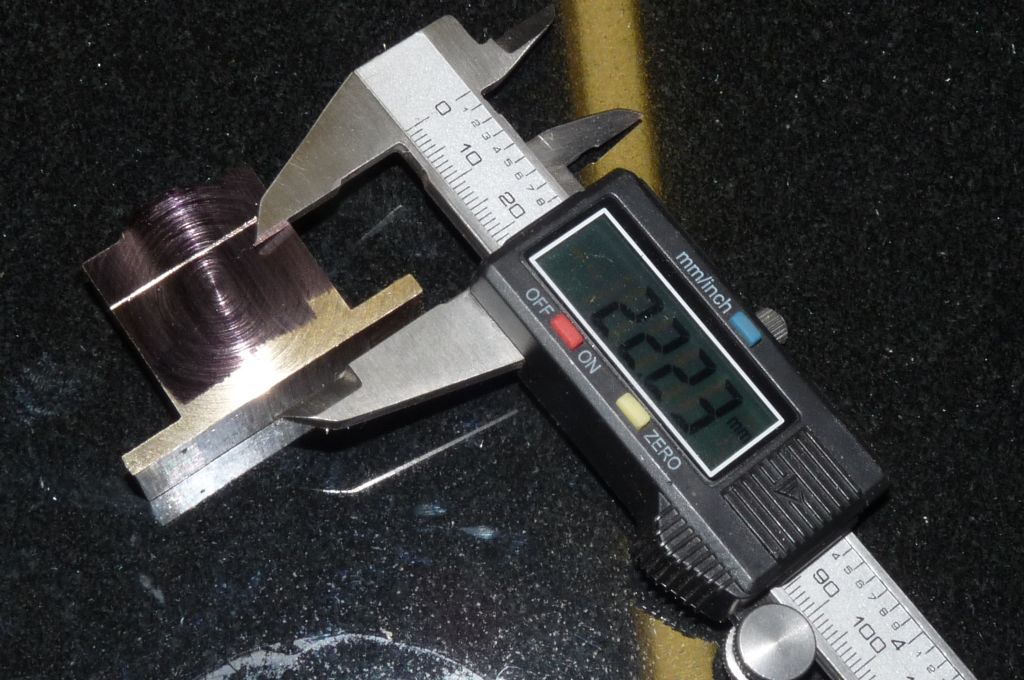

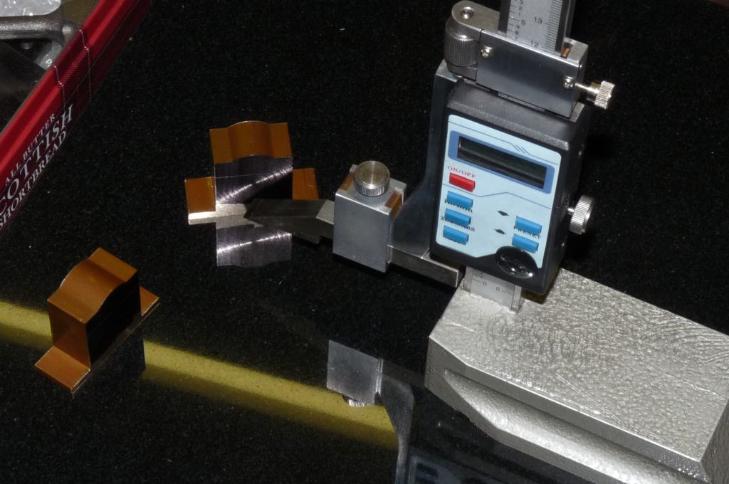

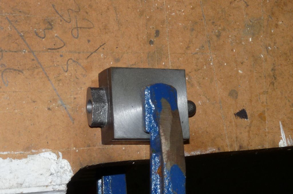

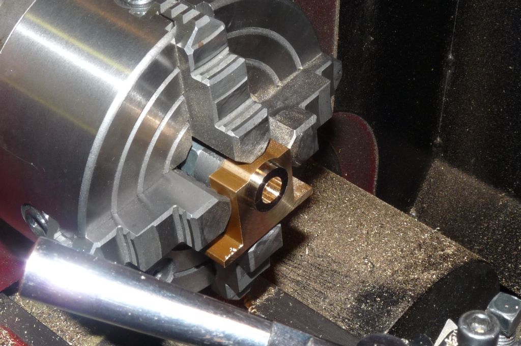

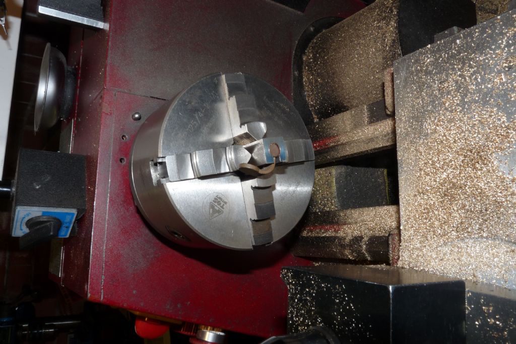

                                            First task on the bearing blocks is to mark the centre for the bore that will support the crankshaft. I've used a digital height gauge sat on a Sainsbury's granite cutting up board as a base. The cutting up is accurate enough for this, but not for anything requiring close tolerances.
                                            One tip from Master Bodger Stevenson, is to grind back the top jaw of a digital caliper to create an "odd legs" caliper (on the basis these things are as cheap as chips now). I tried my odd legs caliper against the centre line from the height gauge and they agree nicely.
                                            I then set the caliper to half the width and scored a vertical centre line to create the centre spot for the bore. The block is then set up in the 4 Jaw chuck,  utilising the backstop.  First I drilled the bore in stages to 10mm, to create a reference, should anything slip when facing down the bearing block. Once the facing operation was complete, I then bored the hole to size. The external diameter of the bearing that protrudes from the block is not marked on the plan. I chose to machine down to 18mm and the depth of the protrusion to 3mm (as opposed to 1/8th on the plan).
                                            Setting up for boring. This is one instance where I've used a carbide tip tool. I normally use HSS, but this little Glanze boring bar uses small tips which are quite sharp, though not as sharp as I try to keep my HSS tools. Although I have a nice 7/16 reamer, I want the bore to be a little tighter on the crankshaft than the reamer will produce, so I bored to a "custom" fit.
                                            Once the first side is complete, then it's just a case of flipping the bearing block over and clocking to truth.  The backstop helps keep the block square:
                                            Once that side is done, the result looks like this. If you look at the photo, you can see where I've tested the cut for fit before committing to a full boring pass.
                                            Once I've completing the other one, I'll move onto the eccentric strap.
