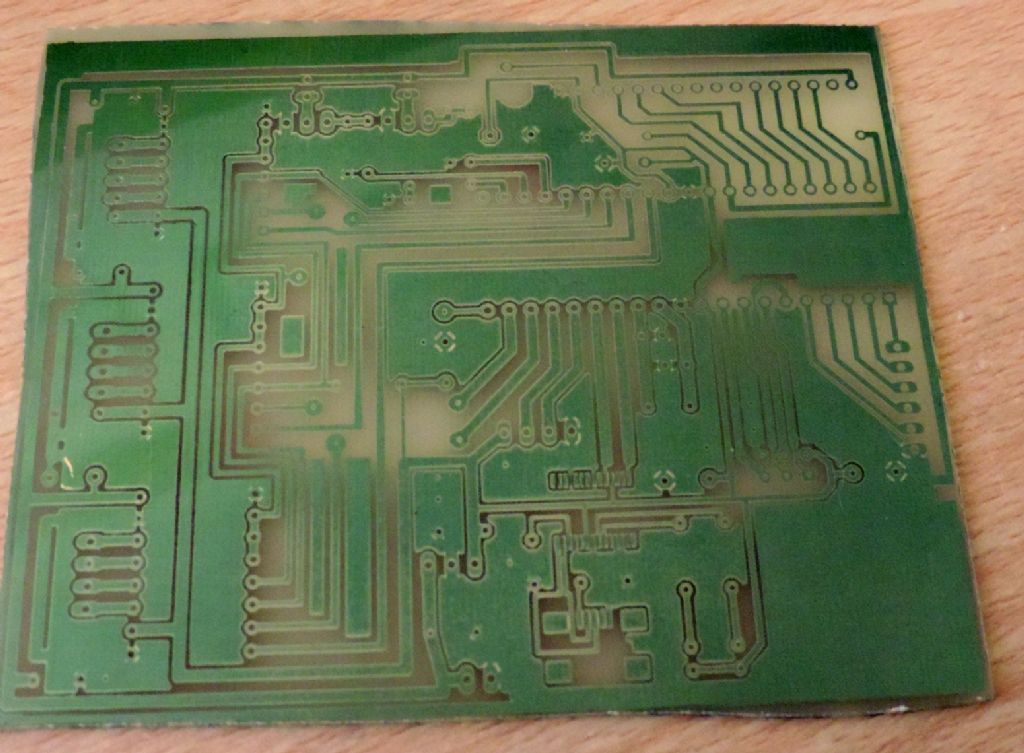

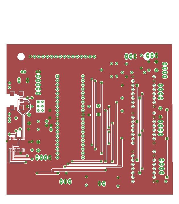

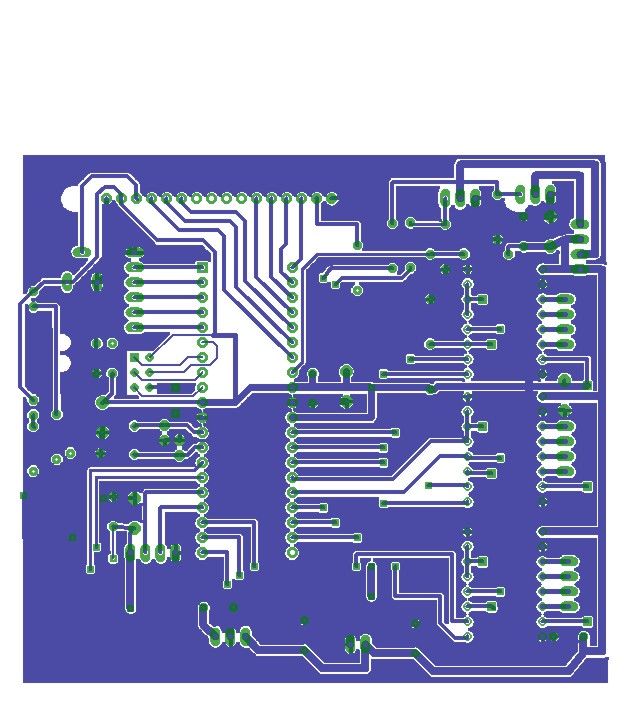

                          #214135
                            First stab at a PCB.
                            I will need to increase the stand off a bit as 100% accuracy in lining up top and bottom hole isn't guaranteed.
                            #222447
                              Well, I went to make the PCB today – and sods law says I only have singel-sided board!
                              Now cramming it onto a single layer.

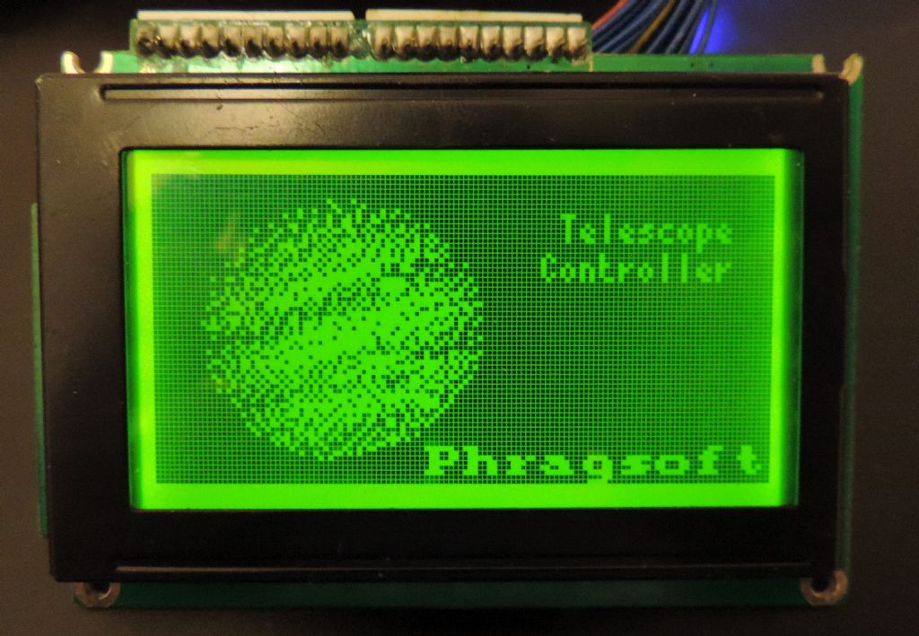

                                  Quite a bit of progress, but I haven't been posting it.
                                  I have redesigned the PCB as instead if a 16×2 alphanumeric display, I will use a 64×128 green graphic display from an old project instead which can display a lot more information, including proper lists of targets.
                                  I have a nice project box made up, with five colour-coded XLR socket on the back: RA, DEC and focus steppers, guide port and dew heaters. On the front the display, chunky brightness control (for ease of use in a hurry), power and an XLR socket for the control handset. The handset is a nice small project box with five coloured push bottoms – I found out why they were cheap on eBay – the bodies have a tendency to melt during soldering!
                                  Found a lovely little unipolar stepper for focus and it had six solder pads, two joined together. I split them and it's magically become a bipolar stepper so I can run it from a polulu, but that's right down the road.
                                  Not much more I can do with hardware until get some molex connectors – I don't want a board tied to the box with dozens of wires. The steppers are fitted to their 'gearboxes' and just await wiring. So for the time being I've started on the software side.
                                  Here's a pic of my 'splash screen' for now.

                                    #237239
                                      Impressive work, Neil yes
                                      Just one little negative point, if I may … It is generally accepted that Red is a better colour for use in a dark environment.

                                          Posted by Michael Gilligan on 02/05/2016 21:29:15:
                                          Try finding a RED 64 x128 LCD display! Swapping out the LEDs on these waveguide -type displays isn't a trivial exercise.
                                          That said, there is a counter-argument that as the eye is more sensitive to green than any other colour, you can set a green display much dimmer than a red one and a display doesn't have to be very brightly illuminated at all to be readable at night – much dimmer than my red torch. My existing unit uses a 2×16 green LCD and it doesn't cause me any problems.
                                          And having said all that… I have a QVGA full colour display that I might drop in instead, which would do a very good job of red text/lines on a black background. But then I will probably want to add an SD card to display colour pictures of the objects…
