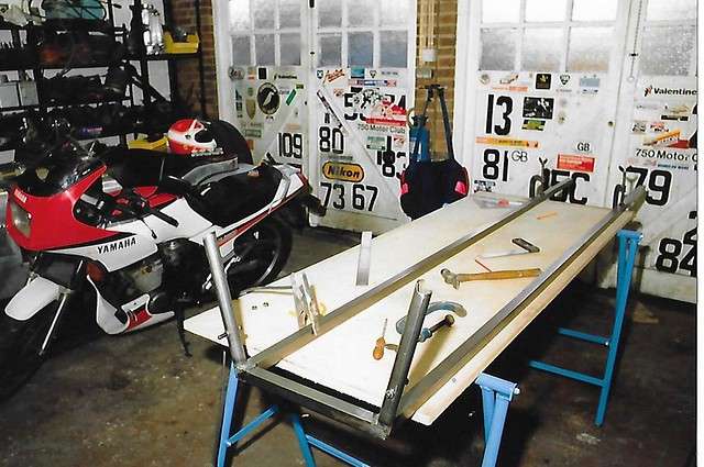

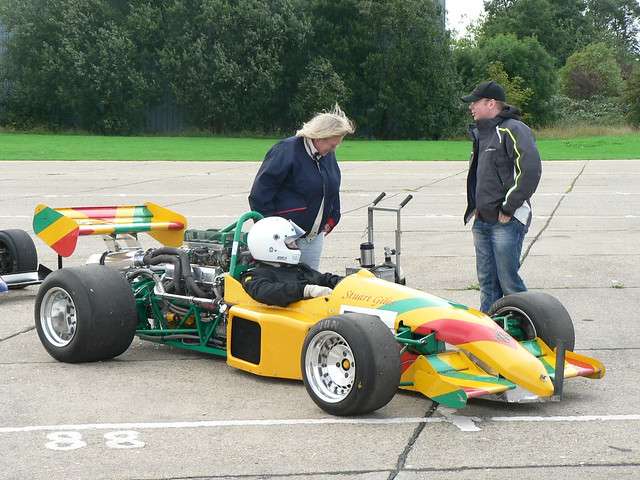

            Well, I built this car from scratch…
            40504184241_1a3a0f2968_z[1]
            26634152268_6ee128f908_z[1]

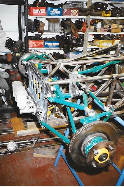

            It’s a hillclimb & sprint racing car. I started here:
            53399709424_4991e56965_z[1]

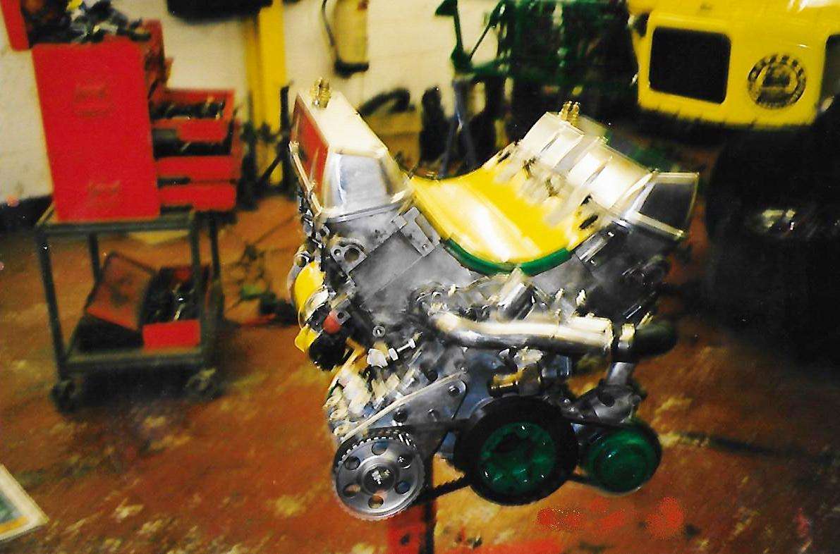

            Through here:
            53399579083_c12099470f_z[1]

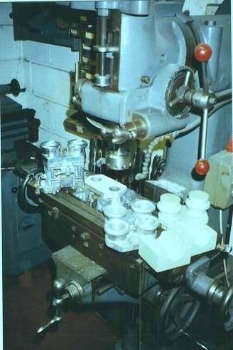

            And here, I did the pattern making and machining for the car’s special castings; these are the carburettor tops with their pattern and corebox. I did the bellhousing pattern as well; there being nothing available commercially as I wanted to mount the hybrid Renault 25/30 transaxle ‘upside down’ in order to acheive the minimum driveshaft angle.

            The car is very quick, sadly I’m not at all a quick driver, but it has been great fun to build and is a real buzz to drive. I’ve laid it up for the present as ‘the powers that be’ upgraded the rollover protection requirements a few years ago, and as my roll bar setup forms an important structural part of the spaceframe chassis, changing it to comply will require a full strip down of the car.

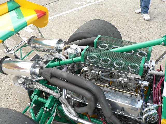

              That is very nice. Is it a small block motor. I remember a lot using the Renault 25 gearbox transaxle for kits. The Lambo replica guys used them. They got in very short supply back then.

                Ford 351Cleveland motor?

                  Easy mistake to make with the motor having a front mounted distributor. The motor is Rover V8 based. The rocker covers are from a TVR “Tuscan Challenge” motor, making it less easily recognisable. Once I’d chopped off the Rover water pump and adapted a Ford V6 water pump the unit became much more compact. That “dry sump” oil pump is also from a Tuscan Challenge motor.

                    A 5.7 litre beast.
                    Steve.

                        Hi Robert. It is a Ford 351 Ci Cleveland  motor with rover rocker covers & other bits fitted.
                        Not sure but biggest Rover V8 i have seen was a highly modified Griffith taken to 5.2 litres. Merry Christmas to you & your family.
