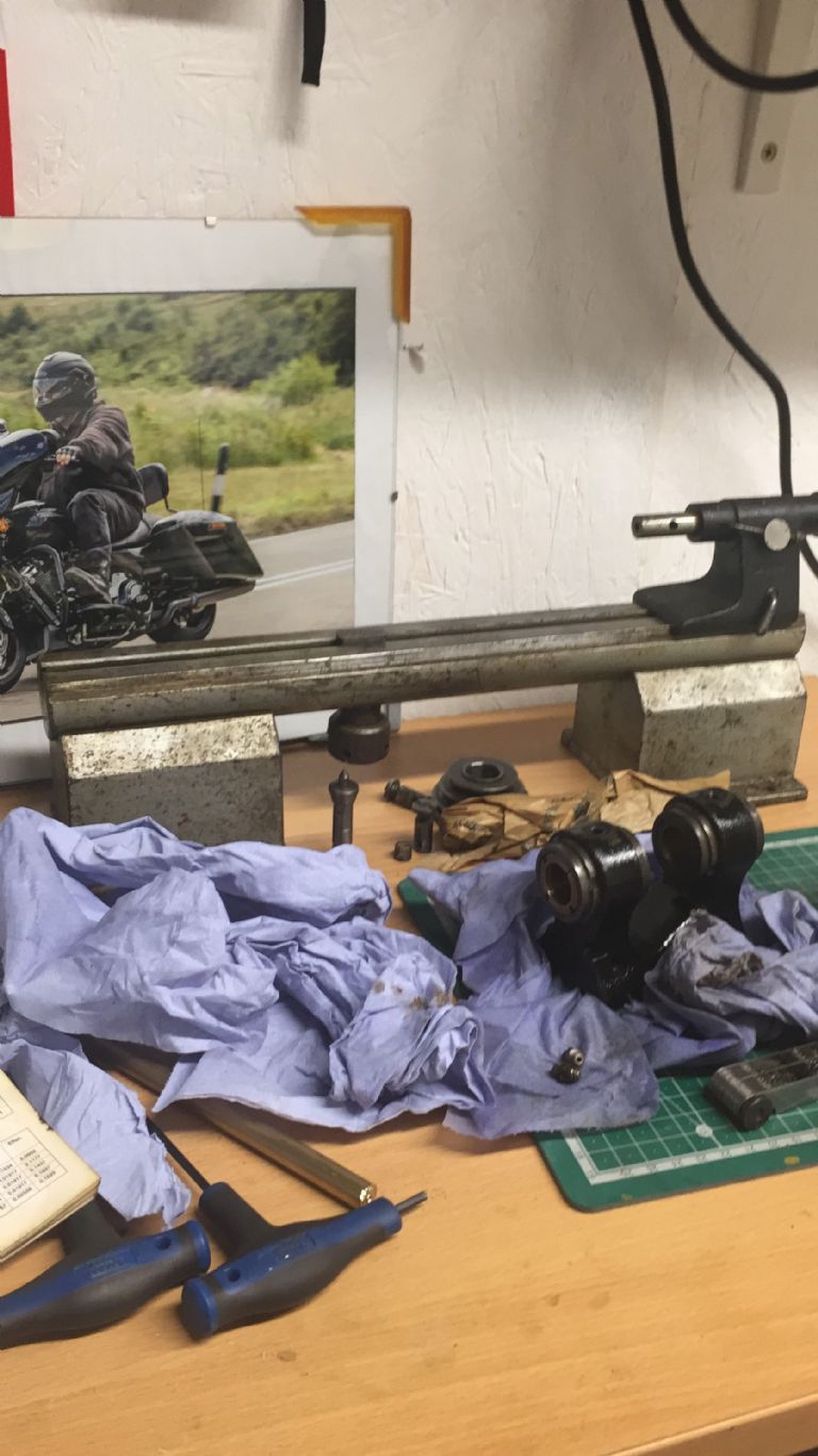

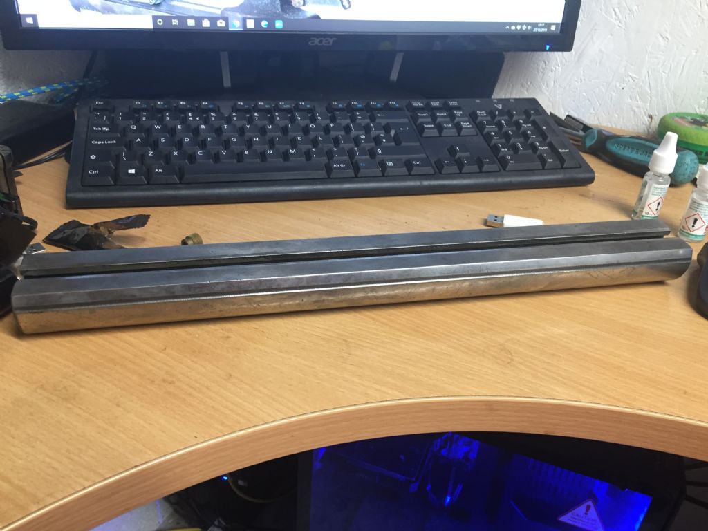

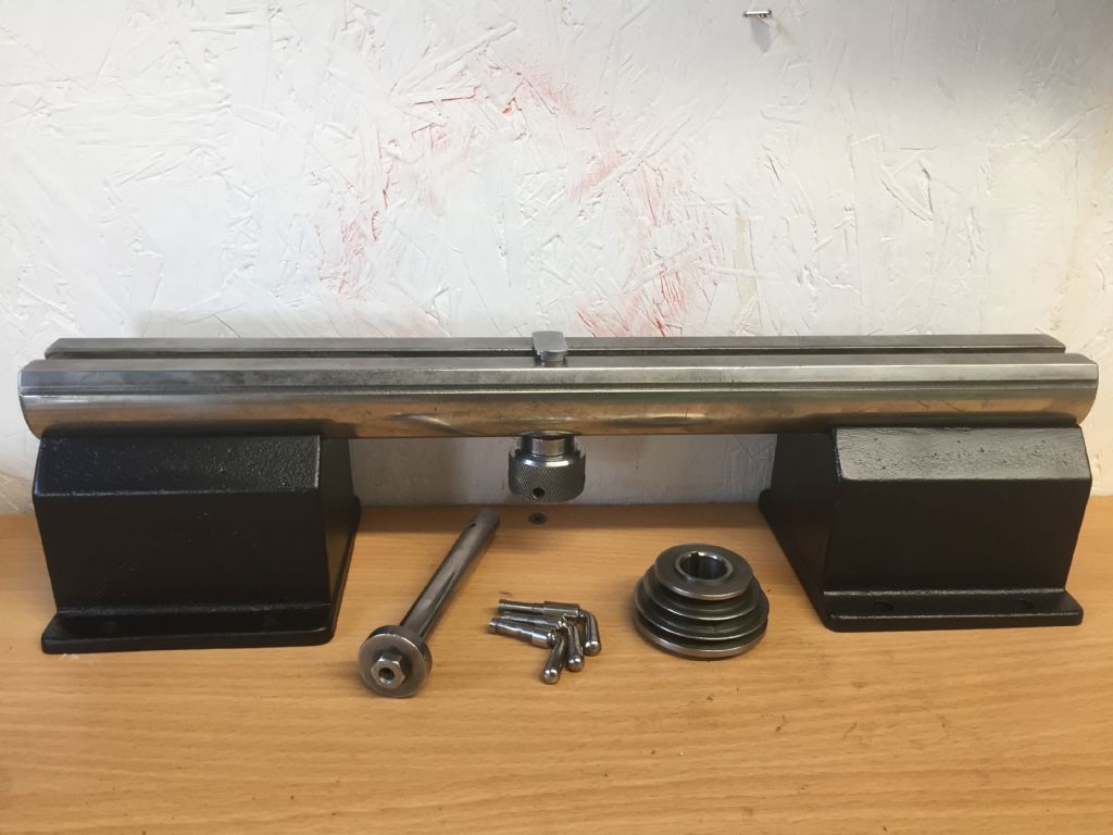

                                                I Decided to strip it down and give it a fresh coat of paint. I used paint stripper to get all the old paint off.
                                                Then used an Etch primer and finaly an enamel matt black spray.

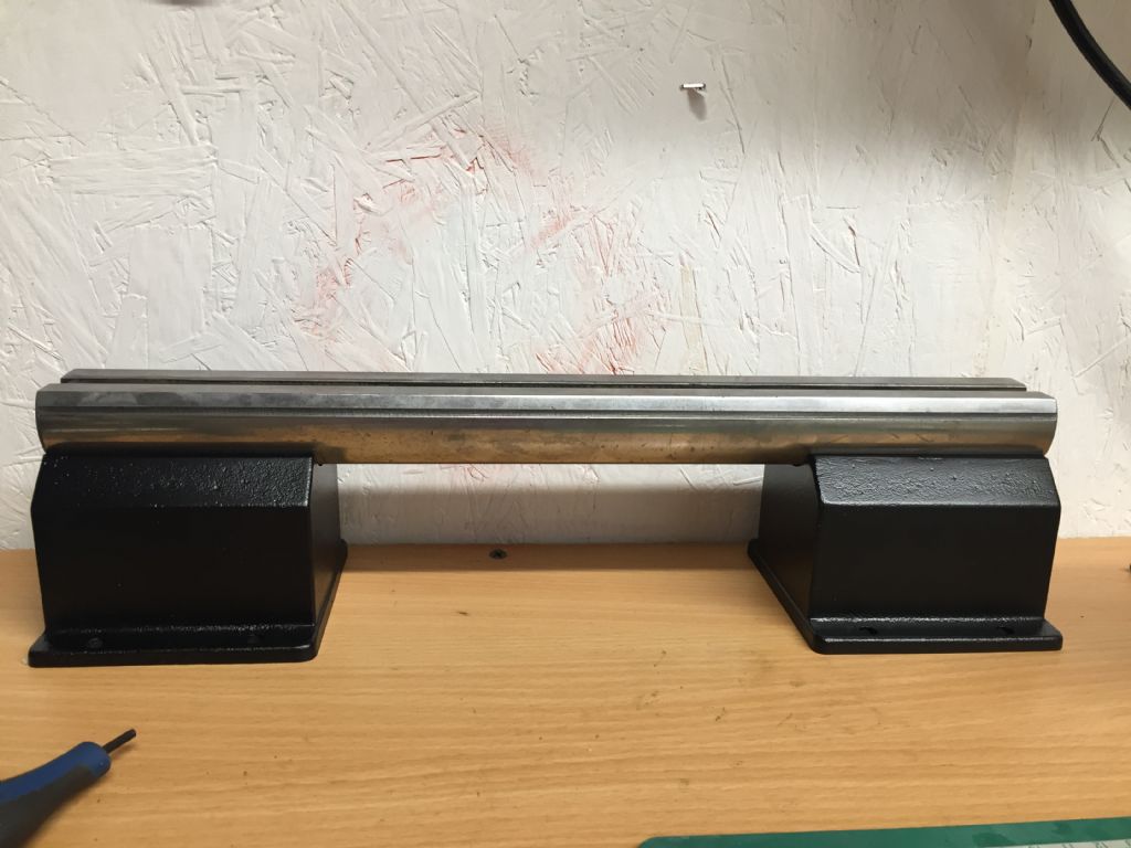

                                                The bed I decided to run through the buffer and just keep it polished.
                                                Upright photo of bed.

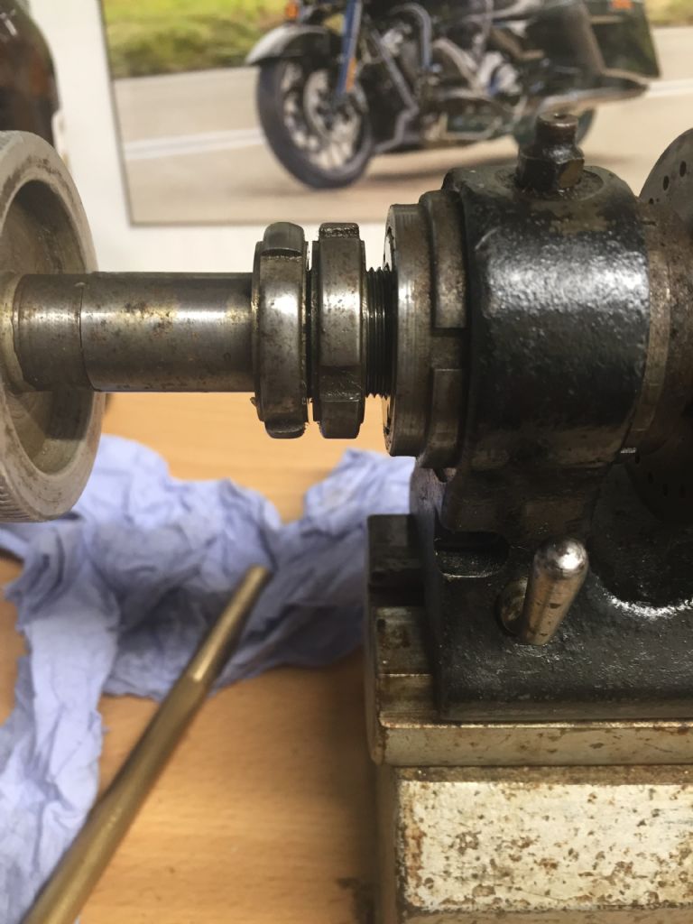

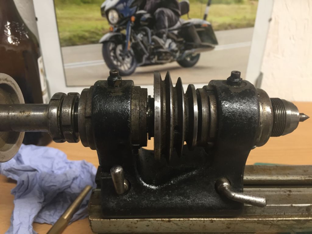

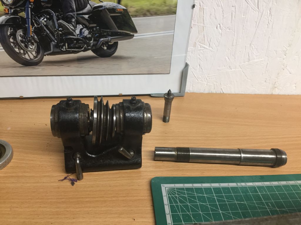

                                                1. First out was the spindle.
                                                To take the spindle out I needed to undo the two retaining round nuts at the rear by the draw bar (left). This was done with a brass bar and a bumping device.
                                                The spindle required a tap with a nylon hammer as the bearings were tight. Also I ensured not to loose the key in the shaft that locks the pully on to the shaft.

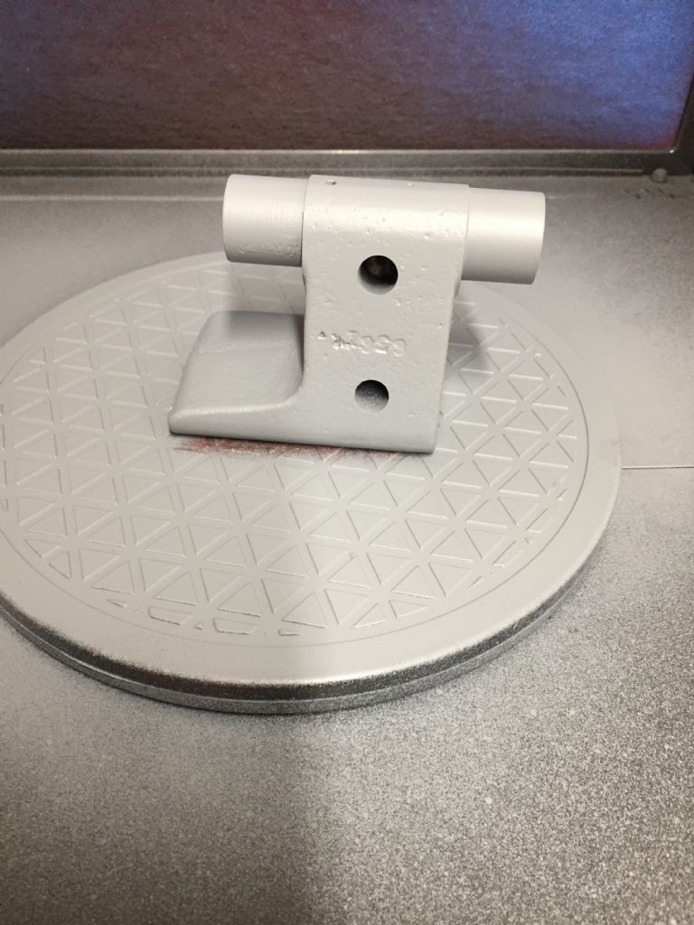

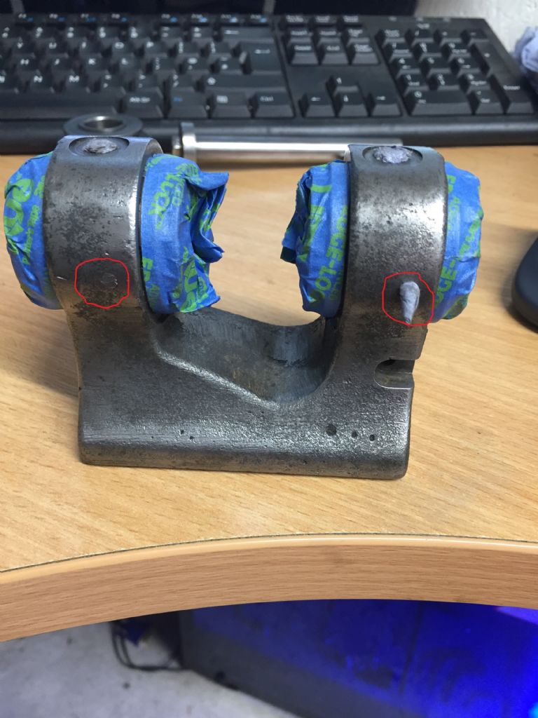

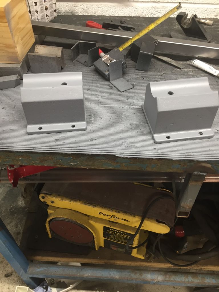

                                                2. The two bases were removed from the bed and stripped of paint and etch primer applied.
                                                3. The bed was stripped of paint and then subjected to the buffer.

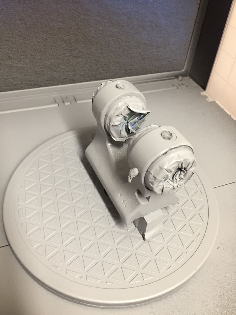

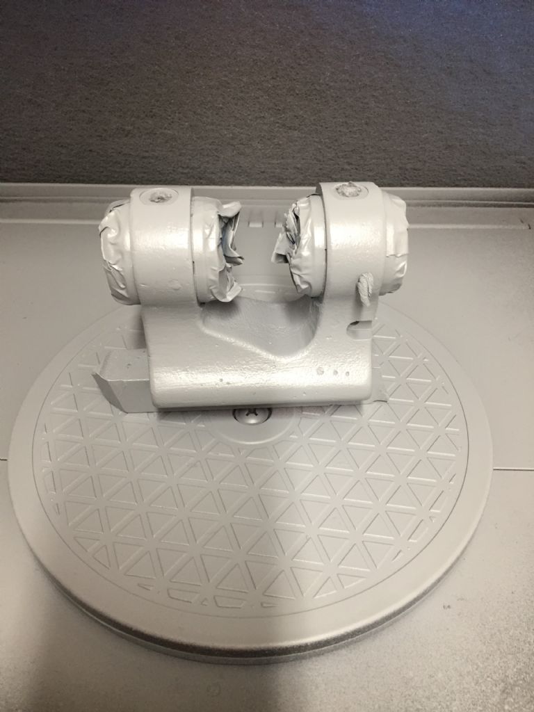

                                                4. Headstock stripped and masked for priming.
                                                The red circle on the right is marking a hole that I was unsure of until I started to put it back together. The circle on left outlines what looks like to be a plug. At this stage I choose not to remove the bearings from the headstock.
                                                Headstock all masked and holes plugged.

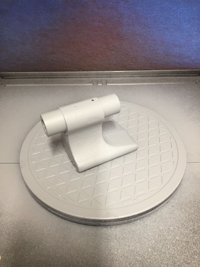

                                                5. Etching Primer added to headstock and tailstock.

                                                  6. Bed and feet now back on.

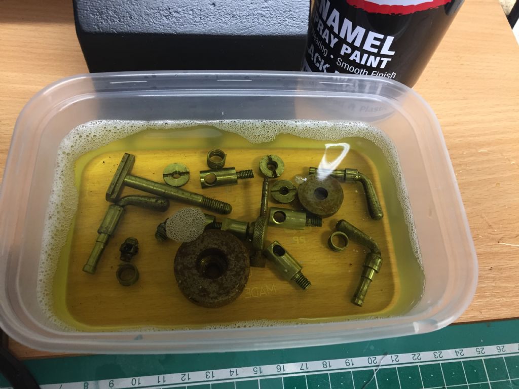

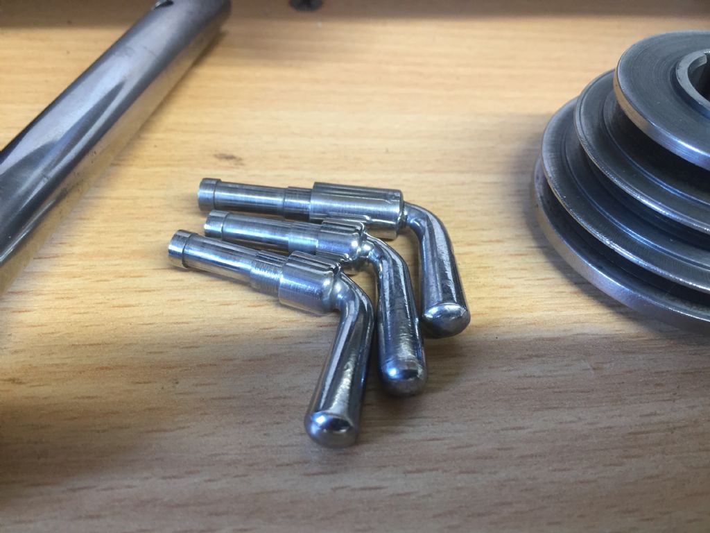

                                                  7. Rest of little bits in Evaporust

                                                    8. A few more items cleaned and polished.

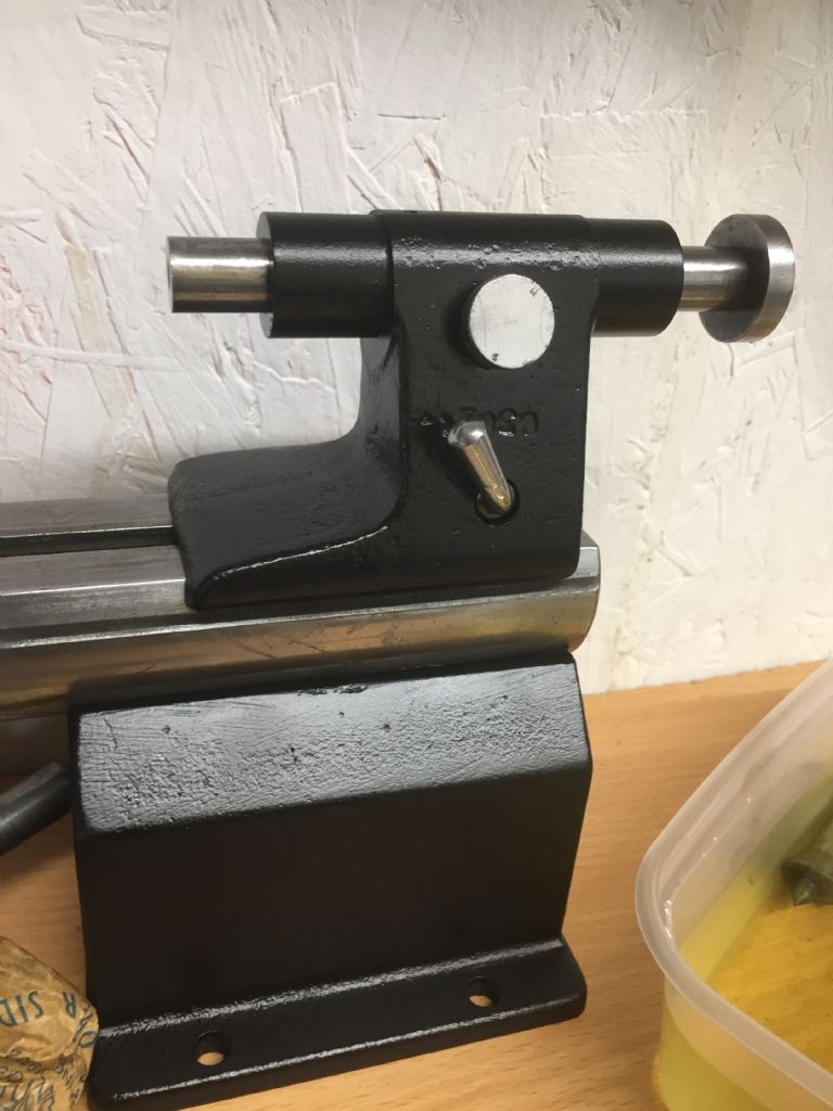

                                                      9. Tailstock back on. The tailstock is on in reverse at the moment so you can see the locking handle.
