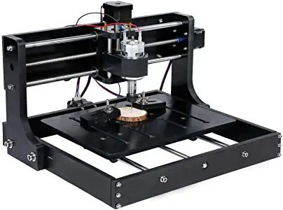

                                                  #505682
                                                  Paul Lousick
                                                    @paullousick59116
                                                    Hi Mick,
                                                    I have just seen an add On Amazon (Australia) for CNC routers and engravers which might be suitable for your grandson.
                                                    Paul.
                                                    **LINK**
