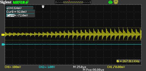

                Found an 12V LED power supply and looked at it with my oscilloscope.
                As can be seen about 160mV of noise on 12VDC which is poor. However zooming in on the waveform shows it to be decently sinusoidal (ie clean). The not very stable base frequency is about 700kHz and it's modulated at about 70kHz, both easy to filter.
                I used one of these on an Arduino project without bothering to clean up the PSU. The Arduino and a motor controller both work fine – their input filtering is good enough.

                  I have a similar one wired up to a laptop charger and digital I/V meters. Extra filtering easily reduced the ripple to below 10 mV p-p. The most difficult part of the project was removing the control pots from the board!
