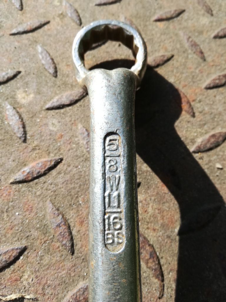

        Hi, here's a photo of my 5/8 W-11/16 BS which is A Bedford No.RW2022 and it has a 11/16W-3/4BS on the other end. I've had this for 50 years, but don't use it much now, however didn't use the 5/8W end very often, except for only for holding, while using the other end. These were advertised in the 1964 Buck and Hickman catalogue. there are also two scans from the same catalogue and you can see King Dick also did this size (DDW2100). One thing about spanner sets, is they don't always include all the sizes that are available and normally contain the preferred sizes or the ones mostly used and if you need the others, you had to obtain them separately.
        Regards Nick.
