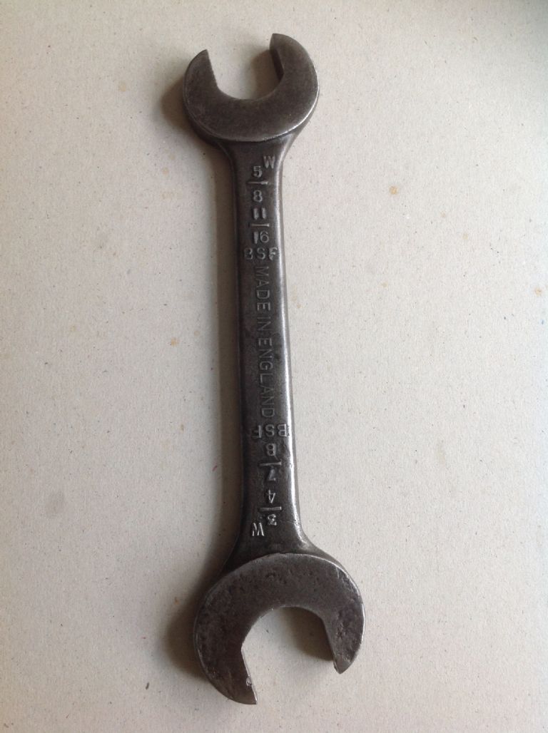

                                Bill Phinn
                                  @billphinn90025
                                  Posted by Andy Pugh on 12/09/2020 12:17:30:
                                  Posted by Michael Gilligan on 12/09/2020 07:42:14:
                                  Simple logic suggests that a spanner for 11/16” BSF should fit.
                                  I don't think that 11/16BSF appears in BS1083 or BS190. None of our sets (King Dick and Britool) seemed to include it. And if you go to the bolt shops they don't have that size (though taps and dies are readily available)
                                  Pictured is the spanner that at the moment I probably use most of all the spanners I possess [for the flats on my ER25 collet chuck]. It is a very good fit, partly because the jaws of the spanner are exactly the same thickness as the width of the chuck's flats.
                                  ETA: It is the 5/8-11/16 end I use.
                                  Edited By Bill Phinn on 12/09/2020 13:29:02
                                  #495427
                                  Andy Pugh
                                    @andypugh44463
                                    Posted by Bill Phinn on 12/09/2020 13:27:14:
                                    It looks like a BS190 spanner, so yes, it will fit an old 5/8"W bolt head. My point was that modern Whitworth spanner sets do not always include the 1.10" AF size.
                                    I haven't yet found a BS1083 table that lists the "new" 11/16"BSF spanner size. I strongly suspect that it doesn't exist and so to deal with BS190 5/8" bolts you need to find a spanner made before 1951.

                                      Bill Phinn
                                        @billphinn90025
                                        Posted by Andy Pugh on 12/09/2020 14:52:22:
                                        Right.
                                        What might we expect it to say on it? 1 3/32"?
