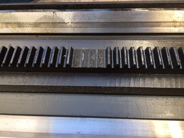

      I wonder if anyone could tell me the teeth pitch of the table drive gear/table rack – the machine is old and been abused such that there are teeth missing on both the rack and the drive gear , and I am wondering about replacing both . I don't imagine parts will be available off a shelf for this WW11 machine so getting new cut would be the only way… Unless I could retrofit similar parts for a modern surface grinder

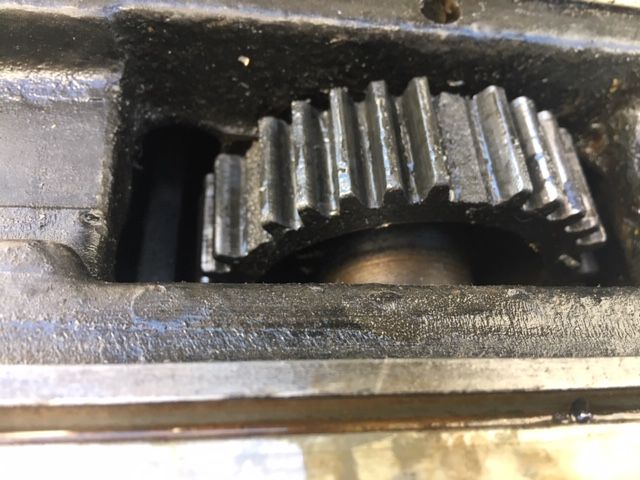

              The rack has a clump of 4 teeth missing and the gear has 3 teeth missing each separated by 5 good teeth – it looks to me that over a period of time the gear has been jumping the rack gap as the table shuttles back and forth at speed, and slamming into the good tooth at the end of the gap until another gear tooth gets knocked off. Ie. can only get worse.

                As a temporary measure you could perhaps move the rack along a bit if you are only using it for small items. Since both are damaged both need replacing so you could go with anything and nowadays a metric pair is probably cheaper.
                As for identifying the pitch as you have the item you are better placed than us to identify it. Place a rule along the rack and measure the number of teeth in one inch, or two inches if not a whole number. Once you have the pitch you can calculate the DP or Module for a replacement of the same general size as you won't have to go for an exact replacement when both are being changed.

                  Ok, doing the Pete Rimmer method (setting calipers to 3.142 inches and if an exact number of teeth then counting the number of teeth) I see that the rack pitch is DP10. Should I assume PA of 20 on the basis that Hardinge USA prefer PA20 to PA14? Actually it makes no difference as long as they both have the same PA….

                      If you are handy with a file, a few grub screws fitted in those tooth spaces could be profiled to run. A standard gear repair method for some of us – as long as they are not high speed.
                      Diameter in inches divided into the (number of teeth +2) will provide the DP of that gear.
                      If you could put up with less travel you could scavenge a group of 4 teeth from the end of the rack and graft them in to replace the broken ones.
                      Filling the gap with braze and recutting the teeth is another option for a repair.
                      But, as Bazyle , changing both for new gives you the option to go for a more modern set.

                                            The pressure angle doesn't matter one jot if you're replacing the rack and the gear.
                                            If the rack is only broken in the one spot and the budget was tight I would cut that rack right at the broken part then grind the two ends so that they ended right in the bottom of the tooth valley, then flip two two halves round so they meet in the middle. Pin and bolt the two bits in place and buy or make a new gear. if the travel is lumpy over the join then shim or grind it to suit.
                                            I'd offer to cut the gear for you but I can't do 10DP on my hobber.

                                                    Being a Brown and Sharpe, it would seem likely that the gear is DP rather than Mod.
                                                    Measure the OD over the "unbroken" teeth, in inches. Count the number of teeth (N ).
                                                    OD = (N + 2) / DP or putting it another way
                                                    DP = (N + 2) / OD.
                                                    For a Module gear, the calculation would be similar, but using mm instead of inches.
                                                    HTH

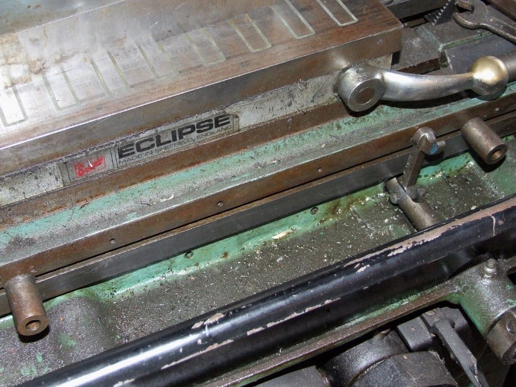

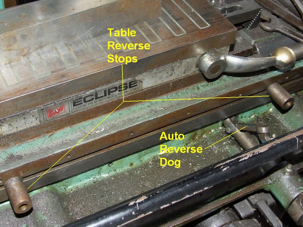

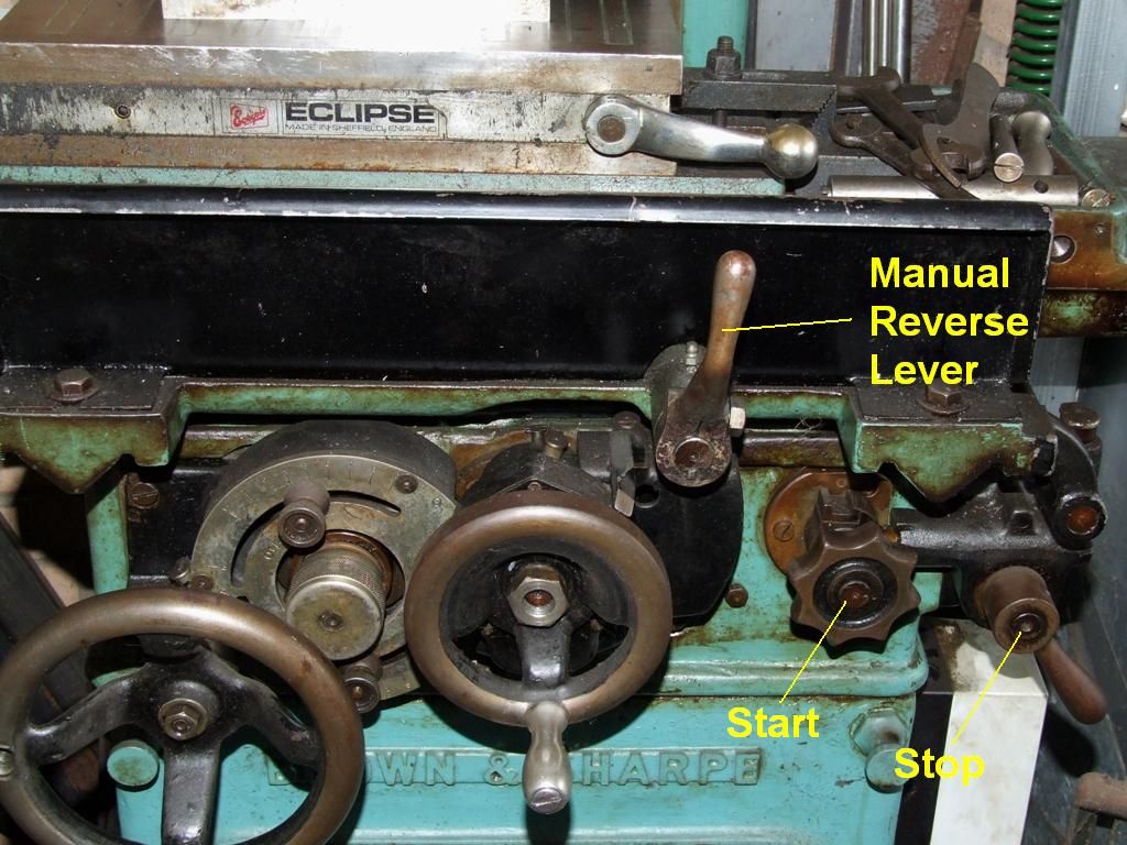

                                                      I wonder if my grinder might be different? It simply says Brown and Sharp and No.2 on the plate. Here are the basic table controls:
                                                      To start the table feed the knob labelled Start is turned a few degrees clockwise and then let go when it springs back to the original position. This engages a pin held in the horizontal casting between the Start and Stop controls. As the Start knob is rotated the Stop lever also moves slightly but also returns to it's normal position. To stop the table feed the Stop lever is knocked anti-clockwise; it only moves a few degrees before disabling the feed. Once the table feed is active the table direction can be reversed manually by moving the Manual Reverse Lever from side to side. This picture shows the table reverse stops and reverse dog in the manual position:
                                                      For auto table reverse the reverse dog is moved to the vertical:
                                                      It's important that the reverse dog is between the stops; it can get exciting if it isn't! Standard table speed is 33ft/min and there's a fair old clonk, and the machine shakes, at each reverse.
                                                      Andrew
