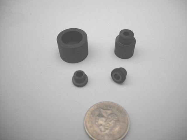

                                        To make bushes from Carbon Impregnated Teflon, you can machine it from solid, but having turned a few you have a whole pile of swarf, now this stuff is expensive, so I made a mould, this gets stuffed with Teflon, and packed down, next the mould is heated to blue (steel mould), when it is cool the core gets pushed out along with the bush. These bushes will out last most of the rest of the motor.
                                        The first motor I used one of these bushes (1992) still has the original bush. After 1000hrs of running, I had to make a new crankshaft with larger crank pins (3/8" instead of 1/4&quot, a couple of months later I went to reassemble the motor, a BETA type and found that the Teflon had swollen, and the displacer rod would not fit, I had to ream it to make it fit. I think the bush had got some oil on it during the previous year of fairly heavy use. After all these years the motor now needs a new hot end.
                                        Ian S C3/8
