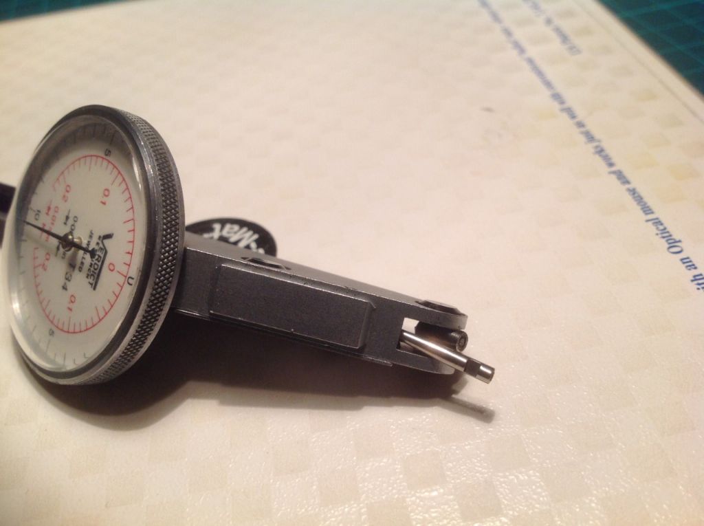

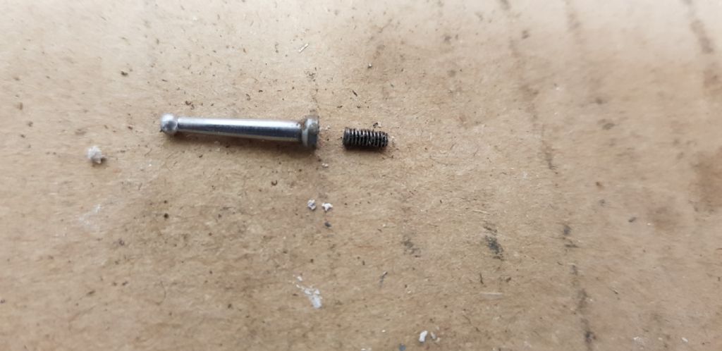

        In spite of literally keeping it in cotton wool when not in use, compromised dexterity has led to me dropping my Verdict Metrinch DTI on a concrete floor and snapping the stylus clean off at the base.
        I would be grateful for any suggestions on how to remove the remnant of the stylus from the screw hole, or otherwise make good the damage.

        Steviegtr
          @steviegtr
          I did exactly the same thing. I got 2 sharp pointed scribers & at 180 degrees to each other managed to with a magnifying glass , twist the broken piece out.
          I repaired it by using a short piece of a small drill bit & bonded it in. It has worked ok since.

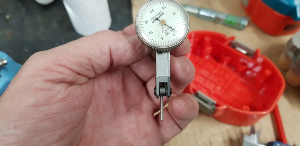

              Bill Phinn
                @billphinn90025
                Many thanks for the replies, especially to Steve for the suggested extraction method.
                Yes, a scriber has done the trick! Took a long while to wind it out enough to get some jewellery pliers on the stub and turn it a bit more quickly. Fortunately it hadn't been screwed in too tight.
                For the record, it's a 10BA thread. Now I just need to identify the right stylus to replace it with. I've got all three that go with this model [Metrinch T34] and the broken one is the 0.080" ball tip. MSC Direct's website seems to sell a big range of styli but the descriptions are hopelessly inadequate. Fortunately there's a good guide to the styli on Verdict's/MJ Allen's website so I think I've identified the right one on MSC's site. Buying from Verdict/Allen direct doesn't seem to be an option.

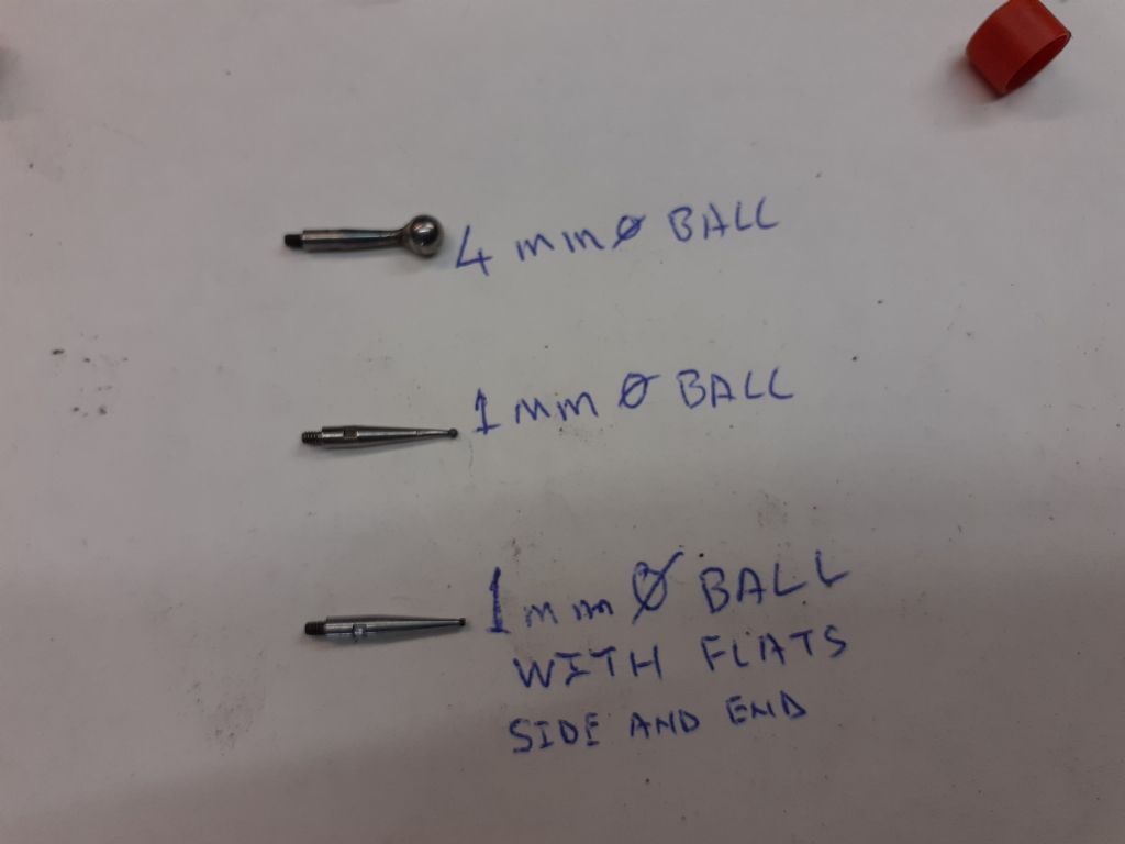

                        David George 1
                          @davidgeorge1
                          In the past I have repaired and made stylus for various dial test indicators as long as you know the thread size and the length of the stylus in question it is a fiddly but easy job. I would make bent stylus, diferent tip diamiter sizes an eavan longer length (although they were only for comparison) stylus. I would turn the blank and thread and either solder a ball bearing on to the stylus or bend the shank to suit the job in question, maybe U or Z shaped to get round inaccessible areas. Sometimes the stylus would be a disk which I would solder on a ball and then grind the sides to the required thickness, maybe 30 to 50 thou to measure a small step which a ball tip would not get to.
                          David
                          Edited By David George 1 on 26/10/2020 07:56:15
                          #503513
                          David George 1
                            @davidgeorge1
                            A few I have left.
                            David
