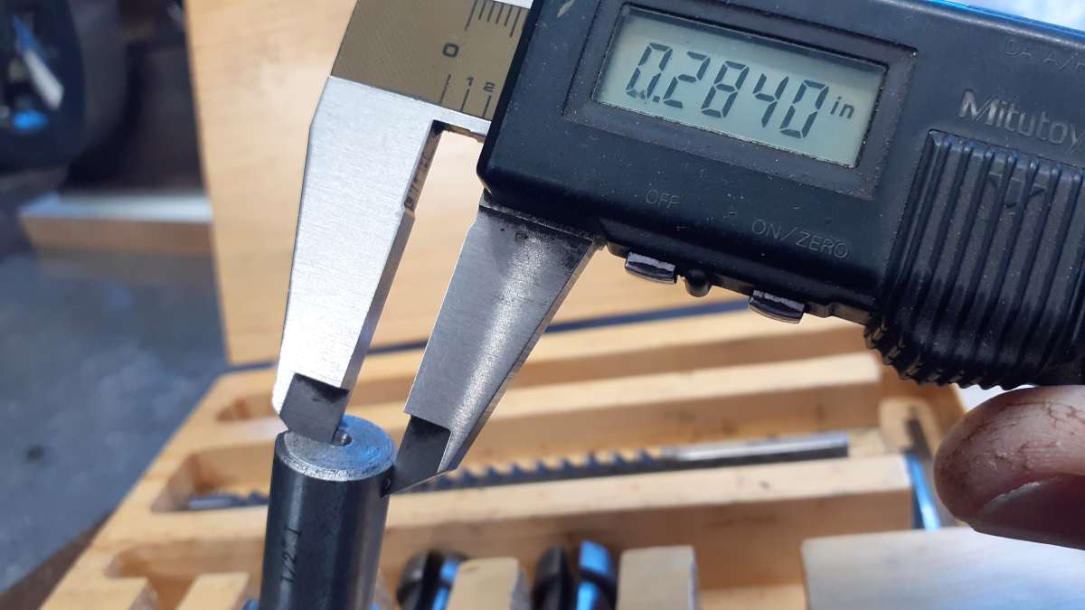

      Following on from my broach question I have purchased a 1/8″ broach type A as recommended. I need to make a guide for the broach the diameter I know but the size of the slot width but the depth I do not
      Do I measure the widest point plus the shime and the deduct the depth of the slot to be cut to get to the correct depth of the slot.
      Or is there some material out there that would give dimensions

        My 1/2″ one has 0.284″ metal left so looks like the slot is 0.216″ deep
        20240523_201010

          Just go deep enough so that the guide on the broach enters the hole.
          Use lots of lube on all surfaces when cutting.

            Thank you all I will go and look at the broach when I have made the guide I will try it in some Ali first
