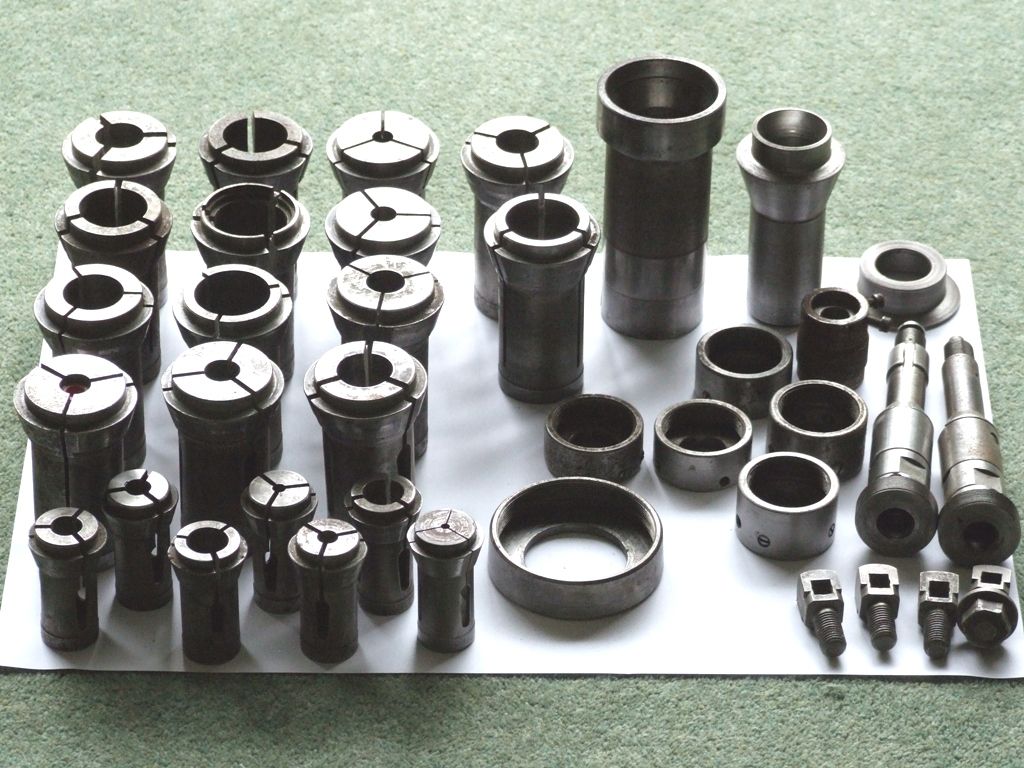

                    Here's the first lot of tooling:
                    Most of this lot is in good condition and gives me some things I didn't have before, including a threading unit for small dies, for use in the tailstock capstan. There is quite a pile of custom tooling in the bottom right corner, which isn't much use, as I have no visibility of the jobs they were used for. There are two puzzles, one I've no idea what the small V-belt is for; I don't think it is used on the Britan. Neither do I recognise the item bottom left as being for a Britan. It's an adjustable holder for parallel shank tooling, and would have been used on a capstan lathe, but not made by Britan?

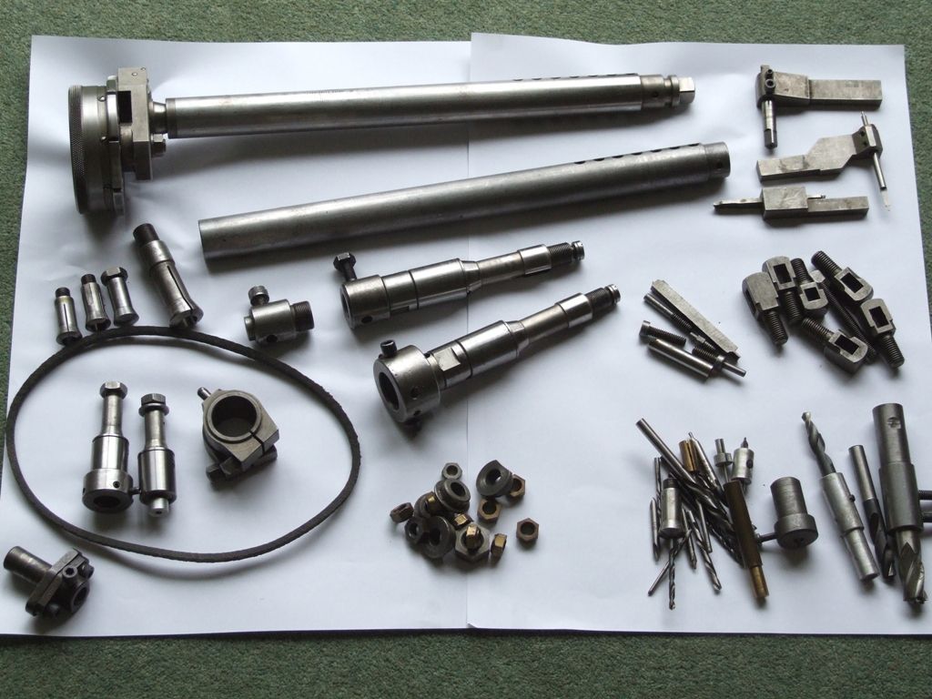

                    Here's the second lot of tooling:
                    This is a bit more of mixed bag. There are some round collets that are duplicates, and some that I'll keep. The one square collet is a duplicate, so that'll go back on Ebay. The hex collets are a bit of an odd collection, including 0.709" A/F and 0.820" A/F. In case you didn't know they're the A/F dimensions for 3/8" and 7/16" BSW nuts and bolts. The drive bracket for using the hydraulic feed via the tailstock is useful as a spare, as I understand these are a weak point, given that the casting is aluminium. One thing I was really after were the two roller boxes, bottom, slightly to the right. I can make one good roller box from the two, and I'm sure the second body will sell. There's only one set of rollers, but it'll be simple enough to make a second, smaller, set from silver steel. There is also a revolving centre for the tailstock, but so far I have miserably failed to work out how to change the centres. Anyone got any ideas? As before there's a collection of 'special' tool bits, but also some useful bits of HSS. And as I was sitting in the car after collection, the seller knocked on the car window and gave me a box of new, old stock, HSS tool blanks, mostly by 'Eclipse'.
                    Overall, I'm pretty pleased with my purchases, as they expand my collection of tooling to nearly all of what was originally available. If I need extra collets I can always make them, using the existing ones as a pattern. Now all I need to do is work out what I'm going to keep, what I'm going to sell on, and what I'm going to bin.

                      Hi Andy, handy box of tools you've got. Vee belt might be one of the aux belts. The toolholder in the first photo is one I have not seen before. Never heard of a drive bracket braking either. HSS tool blanks will need 1/2" cutting off the end, I'm guessing that they are 4" long at the moment. Quick tip, when you grind up the tools, put like on like, ie, a part-off tool on both ends or a turning tool on both ends. That way, you won't swear when you find out that the p/off tool you want is on the other end of that speical turning tool you've just set up. How about running a oxy torch over the spare square collet to make it soft, ready to machine out when required. You prob only get a few quid for it on ebay. Have fun. Dave. Sorry about the lack of spacing in this post, my 'return key' is not working!

                        Dave: Thanks for the notes. I'm pretty sure that the toolholder bottom left in the first photo is nothing to do with the Britan; but you never know, it might come in handy for something. I wasn't aware that there were aux V-belts on the Britan? The belt is very small, about 6mm by 5mm. I forgot to mention that in the second picture, bottom and to the right of the roller boxes, there's what looks like a blanking plug, with a O-ring. It looks like it could be a Britan part, but I've no idea where it goes if it is?
                        It seems a shame to mangle an existing collet, so as an experiment I've put one collet (1/4" square), and a couple of boring bar holders on Ebay. I'm not expecting to get killed in the rush, but a few pounds here and there would help. I've also got a few duplicate round collets to sell, although I'm not sure how much demand there will be for a 1/2" round collet, stamped 0.016" oversize, call it 13mm may be! As and when I need special collets it'll probably be easier for me to make up a batch of blanks from bar rather than trying to modify an existing collet.
                        I've worked out how to get the centre out of the revolving centre body; 'it wiv a 'ammer! Well, more like a gentle tap actually. As far as I can see the centre shanks are ground to a very good finish and are a tight 'tap' fit into the bearings.

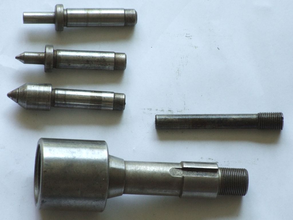

                              Dave: Brilliant! You're absolutely right, the mystery bung does indeed appear to be from the pneumatic bar feeder tube. I can't see I'm ever going to need a spare, but I will clean it up and tuck it away in corner of the Britan tooling draw in the workshop.
                              Thanks for the confirmation of changing centres. Here's a picture of the revolving centre:
                              The female centre seems in pretty good condtion, the other two centres less so. The bigger of the two male centres has two rather neat concentric rings in it. Presumably this was not standard. In due course I'll probably clean up the centres. I am slightly puzzled by the threaded screw that goes in the back of the centre. If you nip it up then the centre stops rotating which seems pointless. I wondered if it was a means of ejecting the centre without tapping via a brass drift. I did try that but I think you'd badger the screw slot on the end in pretty short order. Using a brass drift seems much better.
                              Again you're correct, there is indeed a small V-belt from the auxiliary motor driving the hydraulic pump. I'd better stack the belt along with spare drive belts I got when originally purchasing the lathe.

                                Re:Bung. No idea why you have a spare. It's never going to wear out, is it?
                                Re: revolving centre. The threaded screw is something which I have never seen. We used to drift ours out with a brass or ally rod. Not done on the machine but over a vice or hole in a flypress. As we had three or more revolving centre bodies we didn't change them too often. The were three male and three female centres as standard equipment. NONE had concentric circles from new, yours are worn. As it's a revolving centre and damm hard to wear (because it turns, unlike a fixed centre) I guess that it was in use and somebody got careless and hit it with a tool, probably the back edge of a turning tool.
                                I made-up some special 'bungs' that I pressed the centres into, this allowed me to machine far larger dia tubes etc.
                                Quick tip. When setting the machine, set the revolving centre first. Then you will know where and at what length to set the stop/s. Then set the tooling to the available spare space.

                                  Dave: I've got no idea why I've got a spare bung either. It just came with the collection of other tooling. I doubt it's saleable, but sods law says if I get rid of it I'll need it.
                                  Ah well, the threaded screw will have to remain a mystery. The screwdriver slot has evidence of use, but as to what for, who knows. I've got a flypress so I can use that for inserting and removing the centres. The smaller centre is just plain worn. The two rings on the larger centre look very neat, almost as if they were machined. No doubt your explanation as to cause is correct. It'll be no problem to machine it back to pristine condition. The female centre looks to be in pretty good condition; presumably it didn't get used much.
