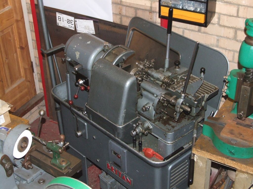

        It is at a rather jaunty angle so that the tool capstan lever clears the bench, bottom right, albeit with a bit chiselled out of the bench leg. I can also still fully open the entrance door, always a plus, and the bar feeder is still able to extend through the door into the hall. At the moment the Clarkson T&C grinder is in the way, but it is only temporarily sat where it is. Once I've moved it, time will tell if the Britan is in the correct place. If it needs straightening up I'll have to make a new lever with a bend in it to keep it clear of the bench. In the bottom right of the drip tray is a small red plastic tea strainer. The previous owner was at pains to explain that this was to catch small parts as they were parted off!

          My first thoughts on your photo are, can the cover drop down on the right hand side of the lathe? If it can't , pull it out, drop the cover and move it back. You will need to get in there at times. Also don't forget, the suds tank can only be removed from the back of the lathe for cleaning etc.

            It is possible to open the drop down cover sufficiently to see what is going on. If I ever needed to remove the auxilliary motor pack I'd have to move the lathe; but I'll worry about that if it ever happens. A minor reason for have the lathe at an angle is so that I can remove the coolant tank. Speaking of which, I've now got the coolant running. it took quite a while for the coolant to appear at the nozzle. The previous owner muttered about priming the coolant flow if the lathe hadn't been used for a while, but I'm afraid the technique went in one ear and out the other.

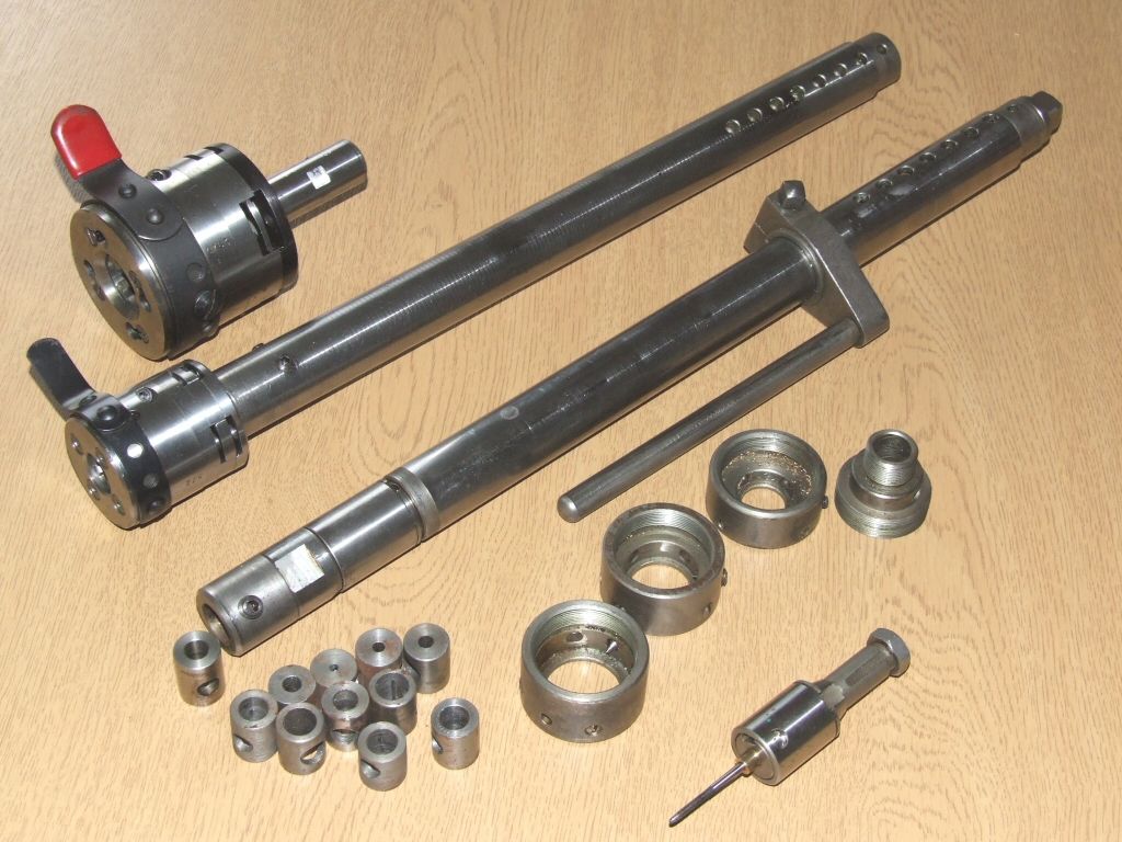

                          Right, now onto threading, here's a picture of all the threading equipment I got with the lathe:
                          Starting at the top are 1/2" and 8mm Coventry dieheads. I'm familiar with Coventry dieheads, and use them with the capstan unit on my conventional lathe. Presumably on the Britan these use the second shaft on the tailstock and utilise a stop, as shown on the lower shaft, to prevent rotation. My main question is about feeds, presumably the dieheads are used at low spindle speed and fed by hand until the dies bite. After that I assume that stops are set to allow the diehead to pull off and release the dies as normal?
                          The lower shaft I assume is also used in the second slot on the tailstock? At the moment it is set up with a self releasing holder for taps. Most of the small 'collets' below the shaft appear to be home made and are presumably for holding different sized taps? Again, I assume that the feed is by hand, until the unit reaches a stop and releases the tap. Next to the collets is what I take to be an adaptor for holding split circular dies. Does this screw onto the adaptor above in place of the tap holder?

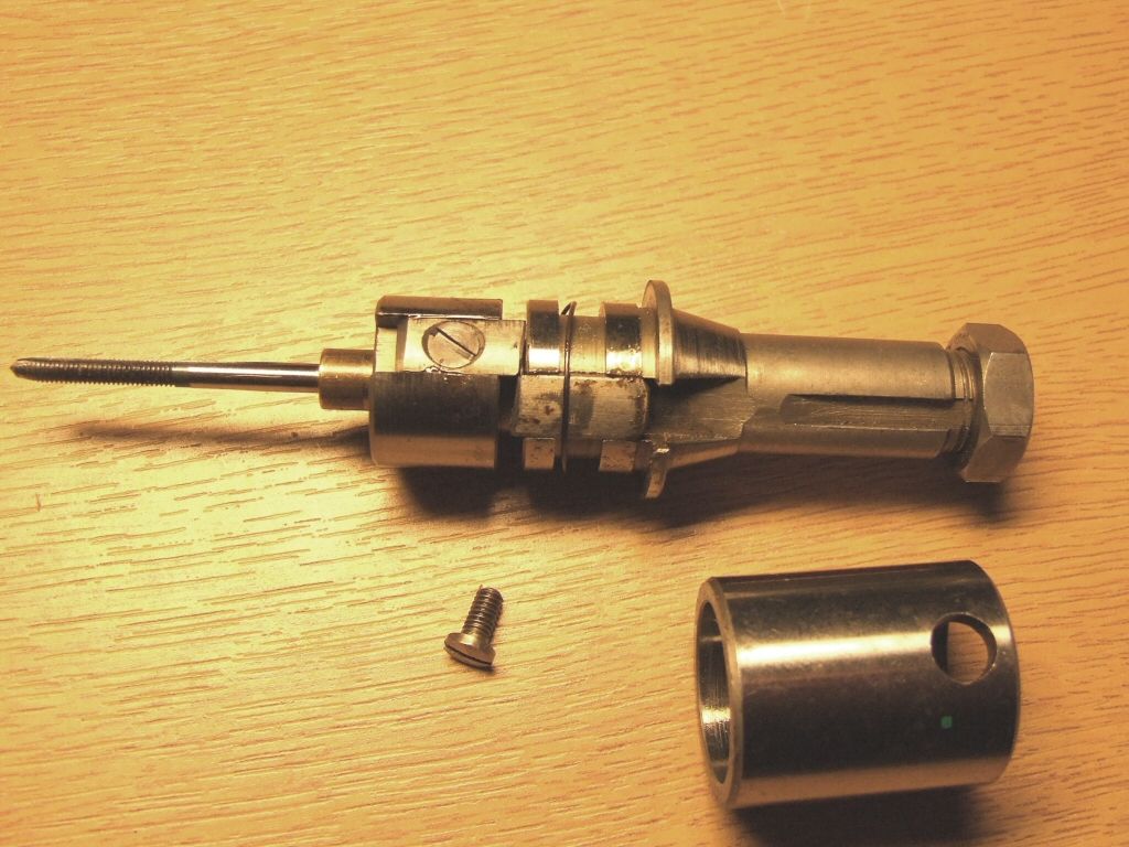

                          At the bottom of the picture is what I assume is a self releasing tap holder for use in the tailstock tool turret? The tap in the holder is held in a split brass collet. I don't have any others of these in the bits and pieces, so presumably it is just a case of making one's own to suit as required?
                          Regards,
                          Andrew
                          #103040
                          websnail
                            @websnail
                            Hi Andy.
                            Re: lathe height. If you are not bolting the lathe down, just stick some timber under it.
                            Re: Coventry dieheads. You are correct in how to use them. Put the lathe straight into reverse and slow at the same time. Run up the thread. Put the lathe back to forward and fast in one hit. Job done. Set the stop 'short' at first and work your way up to any shoulder. Quicker than re grinding the die sets. Remember, if you scrap a part due to thread not quite set properly, unlike a centre lathe, the next part can be made in seconds.
                            The lower shaft does indeed go in the second tailstock position. You are correct again. We almost never used these, as we perfered to use a dedicated tapping head in a drill press.
                            Re: Split dies. You have got 3 die holders but the body it screws onto is missing. Have another look in your pile of spares. The tap holder does go in the tailstock turret. There was also a die holder that fits in there. Both the die and tap holders have one way dog clutches.
                            Yes, you make up your own.

                              Is the body for the split die holders the right most part, under the lower shaft and to the right of the three split die holders? One of the split die holders was screwed onto it, but I took it apart for the purposes of the picture.

                                  Hi Andy, I found a way to blow up your picture.smiley
                                  Re: die holder. The die holder does indeed screw onto the adapter, which in turn screws on the shaft after the tap holder has been unscrewed. There are at least two sizes (lenghts) of the adapter.
                                  There were/are, both left and right hand slip dog clutches (interchangeable) for left and right hand threads. All our smaller ex threads were done using the turret die holder, it's faster. As I said earlier, almost all our tapping was done off the machine.
                                  Re: Covenrty die heads. Direction depends upon if left or right handed thread being cut. With a standard right handed thread, you cut the thread in reverse. ie, the SAME direction you use on a centre lathe.
                                  Remember, the lathe runs in the OPPOSITE direction to a centre lathe in normal use.

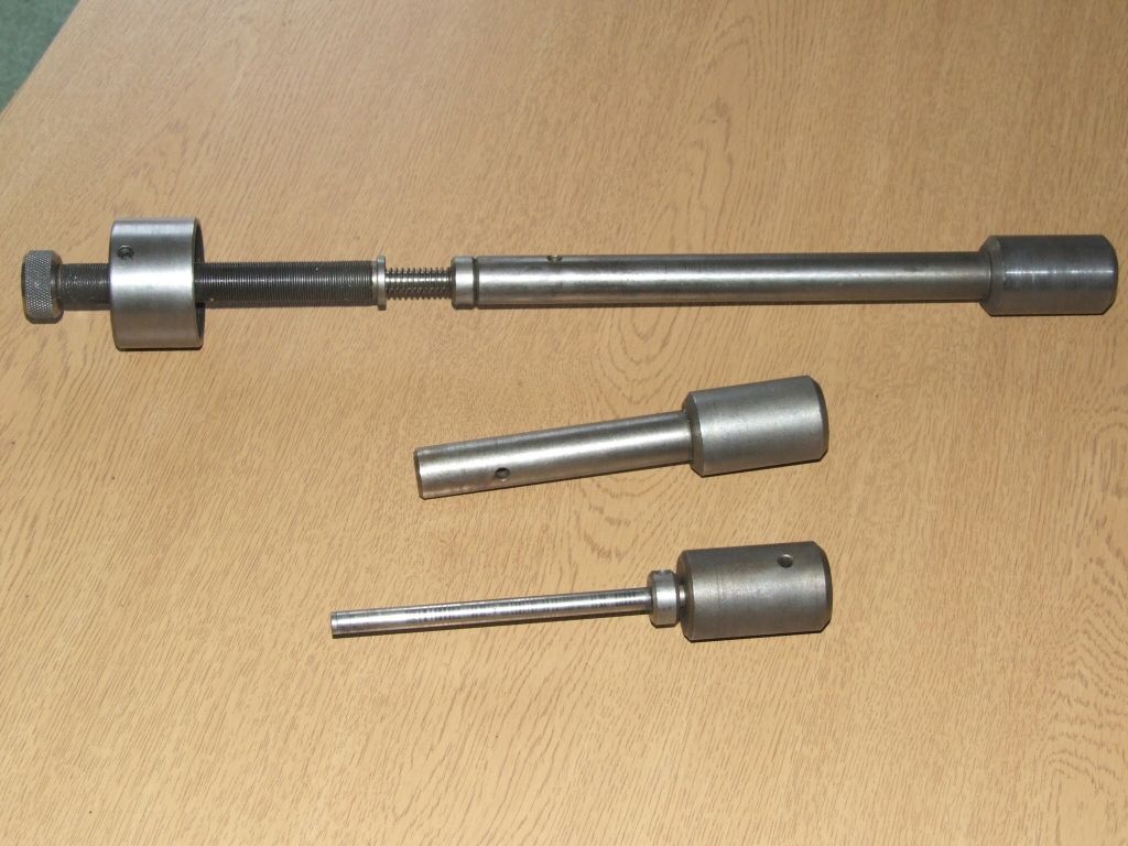

                                    Right, next question, if you don't mind! Here's what I assume are the backstop parts, for second operations:
                                    I wondered what the two lower items were when I collected everything; presumably they're extra backstops, of different lengths? I think I understand the principle of the backstop, but I'm not sure how it is fitted. On the top shaft presumably the collar on the left screws onto the headstock spindle on the left hand end? At the moment there seems to be a plain collar at that end on the spindle, although it does have a couple of holes for a pin wrench.
                                    I'm keeping an eye out for Britan tooling, although I think it's probably a forlorn hope, as what tooling is likely to be around will probably be associated with a lathe; or nobody will have clue what it is!

                                        Re: Taps. All were hand taps with spiral flute. Spiral point taps throw the swarf forward and in this case straight into a blind hole……….broken tap. Yet another reason for tapping off the machine.
                                        Re: Back stops. There are two ways we used backstops. You have got the 'pucka' stops and you're right in how they work. We found them far too limiting, so we made up a bung, which was a good sliding fit for the spindle bore and had a shoulder. It also had a 3/8" bore and a threaded hole at right angles for a cap head screw. Method of use, tap the bung into the spindle bore, take up the little play with a match box lid size of paper. It won't need much tapping but tap it up to the shoulder. We had a selection of 3/8" steel bars, all of which had various turned ends. Pick the one you want, through the bung and nip it in place.
                                        The second method. Make up a bung to be a free fit inside the collets around 1 1/2" long. Stick a M10 tapped hole in it. A turned and faced 6" lenght of studding and a M10 nut completes the back stop.

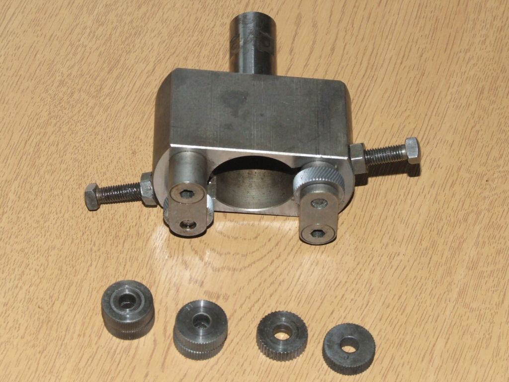

                                          Now onto knurling; here's the knurling tool and a few spare knurls:
                                          It's unfortunate that a couple of the knurls seem to be singles, but that's life. At least knurling wheels are readily available. It seems clear how the knurling tool works, in principle at least. The two screws and nuts at the sides of the tool are used to swing, and set, the diameter of the work for the knurling wheels. However, any practical hints on how to knurl will be most welcome. Presumably the knurl wheels are set to form the knurl in one pass? I assume that some experimentation is required?

                                            Andrew, I cannot see that the knurling will be any different from when using a calliper type knurl holder on a normal lathe. With the calliper however the knurls move inwards evenly and the whole thing will "float" about centre. However with your device as each knurl apparently is individually adjustable by the screw and nut system and the holder is fixed on the centre line, you will need to take care to ensure equal engagement. Apart from that it should be quite straightforward.
                                            #103309
                                            Anonymous
                                              KWIL: Yes, but! I'm not sure I've ever used a caliper knurling tool; if I have it would have been at RAE Farnborough back in the 1970s. Hence the question.

                                                Hi Andy.
                                                Choose your knurls. Mount in the holder. Turn, face, undercut etc as the job requires.
                                                Set the wheels just shy on diameter. Set the length on the tailstock stop.
                                                Kiss the knurl wheels on the dia, then move both screws the same amount to balance the load.
                                                We would knurl in forward slow (just move the long front lever to the right) touch the stop and just pull it back off again, then move the lever to the left for fast.Do not reverse spindle.  Always with suds. Depending what material your knurling, some 'welly' is required. They is/was a black handle/knob that fits on the end of the shaft to help. We never used feed, to knurl.

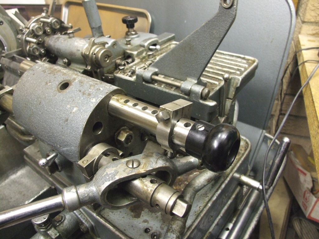

                                                  Thanks for the information on knurling. Is this the black knob you mean?
                                                  I've got one of them, although presumably it can be moved between shafts, or I could make some more.

                                                    That's the knob. Yes, it fits any shaft.
                                                    The shaft in the photo has the WRONG stop on it. You NEED one, with a built in mini shaft, which goes into the smaller hole between the two shafts shown. If you don't use the right stop, it will just spin at spindle speed as soon as any tool touches the work peice, taking your hand with it.frown
                                                    You are also missing the shaft lock, that lives in the other hole you can see.

                                                      Thanks for the tip on the stop with a secondary shaft; fortunately I do have one. I had noticed the missing shaft lock. For some reason it is sitting in the wooden collet rack along with the tailstock capstan collets. I do not know why it was removed, unless it had a reputation for getting in the way if it wasn't being used, or had a tendency to fall out if a shaft wasn't fitted? Which of course raises the question, when was it used? Presumably it locks the second shaft, the one with the black knob? The only time I can think it would be used is if the shaft contained a centre for supporting long work?
