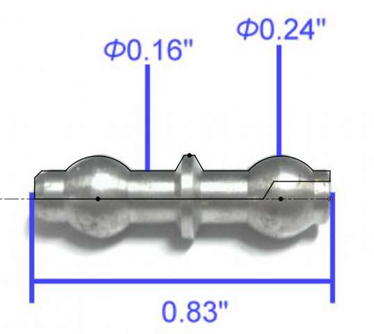

      So mine broke, seems like a common occurrence. It was also a total nightmare to get out, another common occurrence. So I don’t have a whole part to copy, does anyone have a full drawing?

            It’s the classic knee mill with the 2J head. If you had one and broken it you would know  🙂
            Here’s what it looks like: https://atrumpparts.com/image/cache/data/MIll/CNC%20Bed%20Mill/E5FC/HEAD%20STOCK%20INFRASTRUCTURE%20(3)%20ASSEMBLY/10-05-67%20(2)-1000×1000.JPG
            All that’s left of mine are the two balls, I’m sure I can figure out the rest but a complete drawing would simplify matters. I also need to figure out what material to use. I think I will go for a softer material than the original, perhaps a 8.8 or 10.8 bolt.

                  So use the photo of the part you found to scale the missing dimensions. There is adequate information there to make a very good attempt at it. That is your most pronto and most cheapskate option.
                  Your original request requires someone to dismantle their own machine, accurately measure the part, make and upload a drawing of it and reassemble their machine. That is neither a quick nor a cheap option if you allow that their time is equally as valuable as your own.

                    Honestly it’s simple to do if it’s not broken. You need to remove one slotted screw and pull it out with a 4-40 bolt. But I was just hoping somebody had made such a repair in the past and kept the drawings.
                    No biggie, I always figure it out in the end. Except when I don’t…

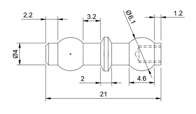

                      This should do the trick:
                      2025-01-01_211320 2025-01-01_211702

                        After some measurements I increased the diameter to 6.3mm, the bore seems to be 1/4″. And it works again, except for the fact that the feed is broken so I really could have solved it with a straight pin.
