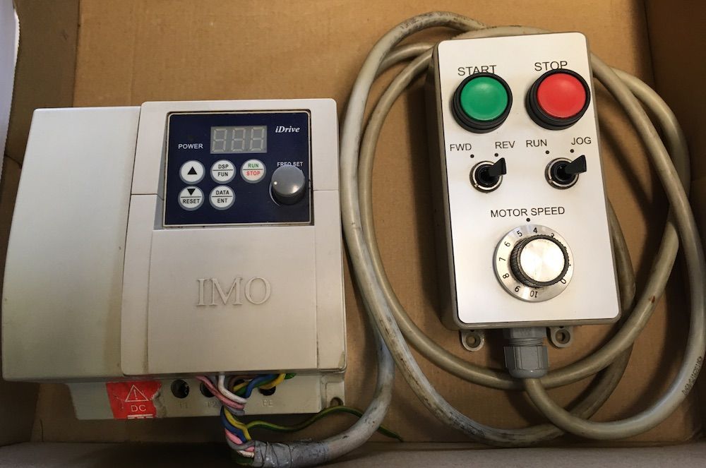

      Sounds like Zan has done what I briefly considered doing when I got my Bridgeport back in 2004/05 but VFD boxes were way to expensive then. (Especially when a proper, commercial, 440 V output static converter surfaced at £35 and I had a motor in stock to make it a rotary.). I expect his circuit will do you just fine.
      This is an example of a commercial VFD set up for a Bridgeport as supplied by Power Capacitors UK (the Transwave folk).
      I grabbed it a few months back as the price was right and it was just down the road but I'm unsure if its exactly what I want so I might sell it on. That one is a vector drive unit and the guy who sold it to me said he didn't have any motor heating issues at low speeds despite not having an extra fan to help keep the motor cool. The man who used the Optidrive also made no mention of needing an extra fan.
      I'm given to understand that modern Vector Drive inverters are much better at giving the motor exactly the right amount of power at exactly the right time so low speed heating isn't such an issue in machine tool use as it was with the older Voltage/Frequency types.
