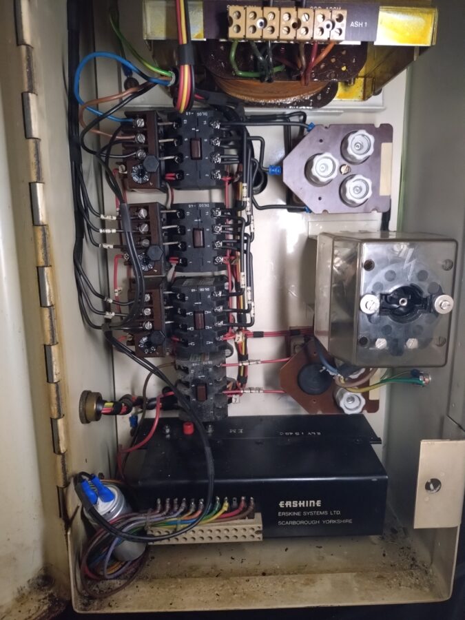

                                            #739545
                                            Fulmen
                                              @fulmen
                                              Had another try today. Gave the contactors a dash of switch cleaner and checked all the screw terminals I could see. I also gave the adjustment wheels a spin, but the result was the same. All contactor magnets loose power
                                              Here’s the panel:
                                              I think it’s safe to assume it’s original and unaltered.
                                              Bottom contactor is for the Erskine PSU and doesn’t seem to have any overload protection. Second is for the mill head, third for the optional slotting head and the top one is for the coolant pump. And yes, it has dawned on me that I should swap over to the slotting head circuit, I’ll try that next time (it seems to reset eventually).
                                              #739573
                                              Les Jones 1
                                                @lesjones1
                                                Your picture does not show the wires comming out of the transformer connector so I can’t trace the wires from there. The botom sets of contacts on the contactors will be the maintainer contacts that hold the power to the contactor coils on.
                                                I SUSSPECT that the single fuse at the bottom right could be a fuse for the low voltage supply to the contactor coils. Make sure that is screwd in properly.
                                                Also the resolution of your picture is not good enough to read the lables on the wires.
                                                (The picture pixelates when enlarged.) You will have to trace the wiring to the contactor coils via interlock contacts and stop buttons.
                                                Les.
