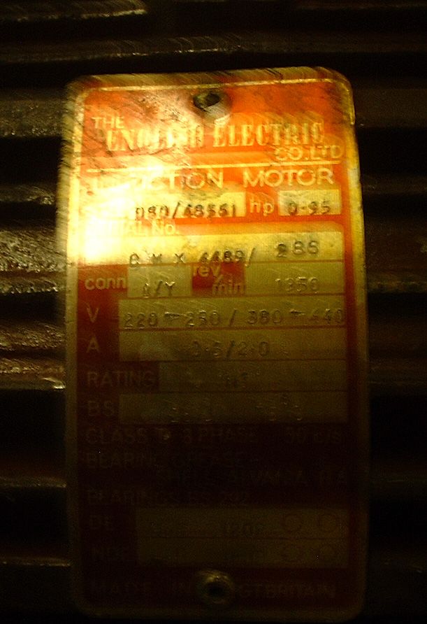

      Hello i hope someone can help.
      I am new to this site and hope to become more knowledgable and able to contribute.
      I am relativly new to model engineering and have recently acquired a Bridgeport Mill 1j head, from the serial it appears to be made around 1968. (I maybe wrong though)
      My initial question is how to power it from a domestic single phase 240v supply in my garage.
      The main motor is 3 phase, made by the English electric company and rated at 1 hp.
      From reading various websites/articles I think I will have to power the motor with a VFD of some sort. But 440v or 240v?
      I have taken the motor off the mill and it appears to be dual voltage. i.e. it states 220v / 440v on the stamped plate.
      What I dont know is how to wire it (if possible) to accept a VFD 3 phase 240v?
      Is it by re-wiring the drum switch?
      I have read about STAR and Delta mode but this is where I cannot work out what to do with this motor, if indeed these modes apply to this kind of motor.
      Any help in the right direction would be appreciated.

            To see if it is easy to change the motor from 440 volts (Star configuration) to 240 volts (Delta configuration) we would need to see a picture of the connection box on the motor. I would expect to see 6 terminals (Plus an earth terminal.) in the connection box. If it is configured for 440 volts I would expect to see three of these terminals linked together and the three others going to the reversing swtch. To insert a picture from your album click on the camera button on the top line of buttons above the box where you type the text of your message. You then select the picture from your photo album. The drum switch WILL NOT be connected between the motor and inverter but it could be used to switch the control signals to the inverter (Probably 12 or 24 volts) to reverse the motor.

                  Hi Rob, The cheapest way will be to use a 240 Volt VFD and rewire the motor to delta. You do have the right sort of motor to be able to change it. The change has to be made on the motor itself. Where the cable goes in, there is usually a small plate held on by a couple of screws. Take it off and you will find a number of terminals, linked with small links with two holes in them so they just fit over the terminals. Now, with luck there will be a diagram on the back of the cover or inside showing how the links should be connected for star and delta mode. It will be in star mode as it came, and this will link the three coils to one common point. In delta mode the three coils will be linked in a triangle. You may find that one of the existing connections is made with two links, one on top of the other. This is because star mode only needs two connections while delta needs three.
                  In the existing star mode, there will be three incoming power connections, each connected to one end of a winding. The other end of all the windings connects together to the neutral connection. There should also be an earth connection to the frame of the motor. When it is connected in star mode, then the end of each winding will be connected to another winding, and they both connect to an incoming phase. Because they are now connected in a triangle, there will no longer be a neutral point, and you will find that the VFD device does not provide neutral on the output side. This is fine. The earth should still be connected as normal.
                  The VFD should connect directly to the motor, eg not through any existing switchgear, as it is not usually recommended to switch the output of the VFD. An isolating switch ahead of the VFD is still a good idea, although if it is going to plug into a wall outlet then simply turning off at the wall and unplugging will be a good way to isolate it when you need to.
                  If you find that the motor does not have the strapping diagram inside the cover, it might pay to get someone who knows about such things to look at the strappings for you.Or else take a photo and put it up here. You do want to get this right for several important reasons, like not cooking the motor, the VFD, or yourself…not necessarily in order of importance!
                  This is a really good conversion to do, since not only do you get the full performance of the motor, you get a variable speed, and the maximum speed can be higher than the motor would normally have provided. Generally motors can be run up to twice their rated speed without problems, although you might want to check what the spindle is rated for too.

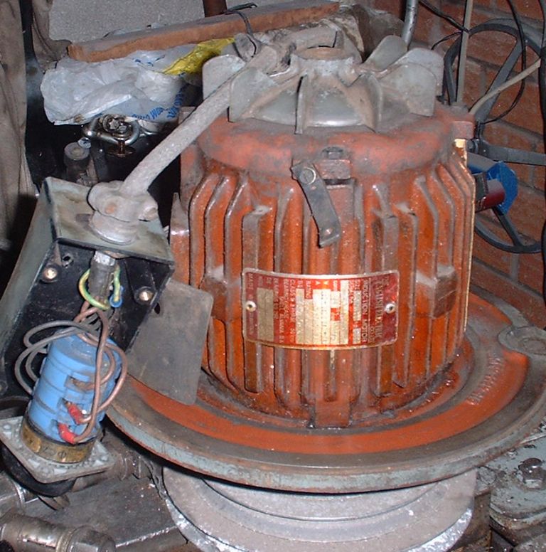

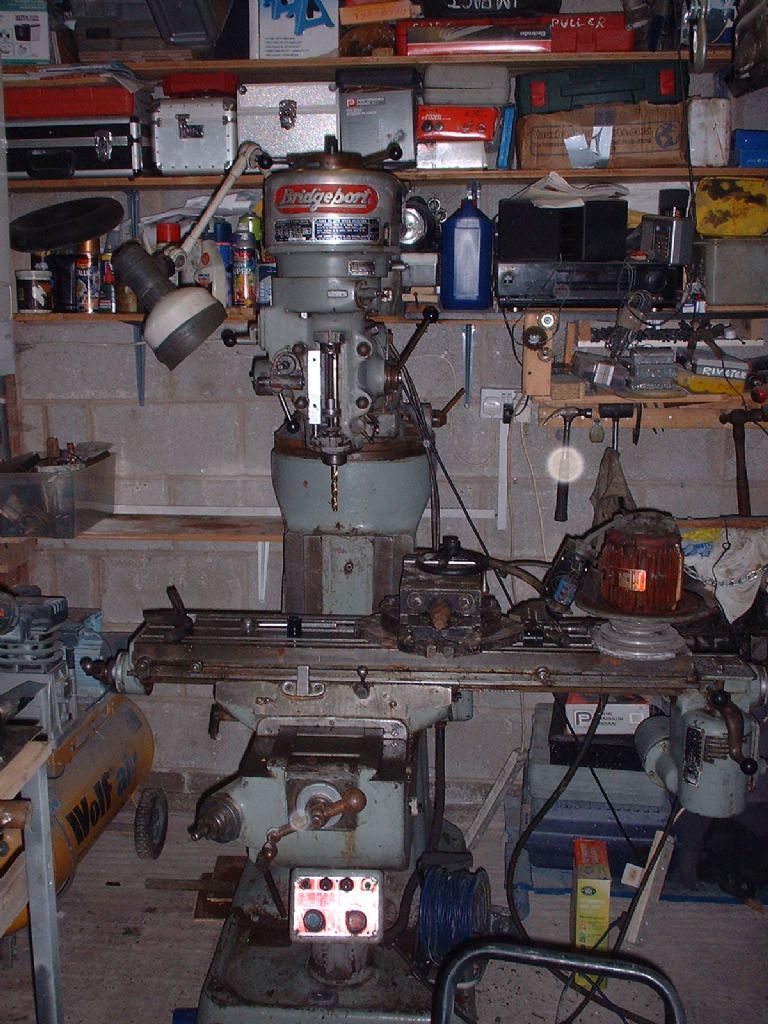

                            Hi thanks for all the replies, a wealth of info already.
                            I havemanaged to access the album I created with photos to make things easier to know what I have
                            1. The first photo is mill
                            2. The second is the motor with drum switch connected
                            3. The third is motor with switch disconnected showing the 3 wires coming out – no terminal box?
                            4. The fourth is the best shot I could get of the rating plate on side of motor showing what I understand is its dual voltage capability.
                            Hopefully I could be advised on what is best way to go with powering etc.
                            Many thanks again for peoples time and advice

                                  Les Jones 1
                                    @lesjones1
                                    Hi Rob,
                                    From the pictures of your motor it looks like there are only 3 wires comming out of it so it may have been rewound at sometime. If this is the case it makes configuring it for 230 volts more difficult. You would have to dismantle the motor and find the ends of the 3 windings to allow it to be connected in delta. I have seen reports of people running the coolant pump from single phase by using a suitable value capacitor to provide phase shift. I have not tried this myself. For the feed motor 110 volts supply you should be able to find a suitable 230 to 110 volt transformer. (There might even be a 230 volt tap on the primary of the existing transformer.)
                                    Les.

                                        Rob27
                                          @rob27
                                          Hi Martin
                                          In the end for my Bridgeport I bought a 1HP 240v to 415v VFD (with on/off/rev speed pot control pendant) from Drives Direct on ebay.
                                          I did look at getting a rotary phase converter but I have limited space in my garage and found the flexibility of a VFD (variable speed) suited my needs better.
                                          it has worked fine for the 3 years since I have had it.
                                          Since then I have seen cheaper VFDs (240v – 415v) from ebay than the one I got from Drives direct.
                                          Hope this helps
