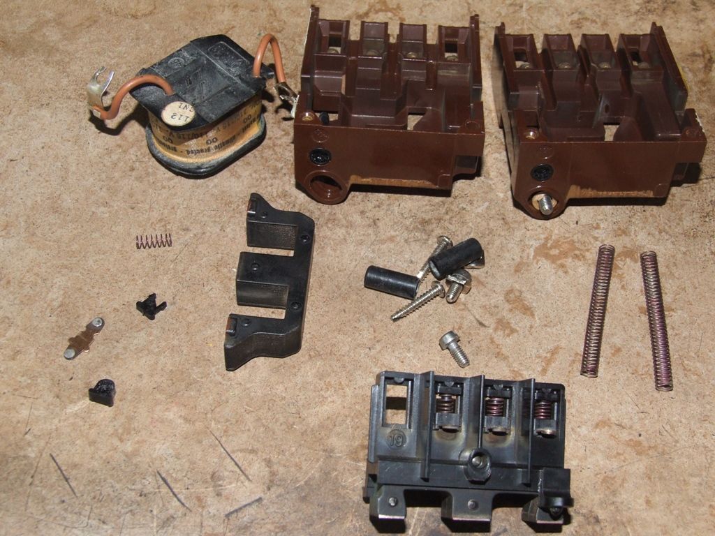

      I've seen contactors fail to hold in before due to dirt on the core preventing said core closing properly, but they normally buzz before complete failure. After fudging the lock out, so I can work on the live control box while it is open, I decide to take the contactor out and dismantle it. The contacts are quite pitted so I clean everything up, re-assemble, and re-fit in the control box.
      When I hit the start button on the box at the front the main spindle starts, but stops as soon as I let go of the button. Basically the contactor pulls in, but fails to hold in. After a lot of checking I am sure that the auxiliary contacts are working and that the wiring in the control box agrees with circuit diagram in the manual, so the hold in should work.
      The contactor is 415V three phase AC, and the coil is 110V AC. Having been forced to read up a bit on t'internet it seems that AC contactors have a shaded section on the core to prevent buzzing at twice the supply frequency.
      So my question is thus: what happens if I have put the coil and/or half the core back in the wrong way round during re-assembly? Would this cause the symptoms I see?

                  #193443
                  Anonymous
                    Yippee! Fixed it, or at least fudged it temporarily!
                    I spent half the night puzzling over the schematics, and the measurements made, and came to the conclusion that they didn't add up. So the schematics must be wrong. I couldn't understand how the main spindle contactor was closing when the start button was pressed, but dropped out when the button was let go, even if the auxiliary spindle motor contactor was engaged.
                    Each overload relay has a fourth auxiliary set of contacts. These are shown all in series, along with the stop button in the schematics. However, the results of measurements indicated that there must be another switch in series with each set of auxiliary contacts on the contactors, exact as Frank said. That explains why the contactor operates when the start button is pushed, and the auxiliary contacts on the contactor close, but the coil is unpowered as soon as the start button is released. Sure enough on the main spindle motor thermal overload relay the auxiliary contacts are open, not closed as they should be. So I bypassed the overload relay aux contacts and away we went! For those that are interested here are the internals of the contactor during cleaning:

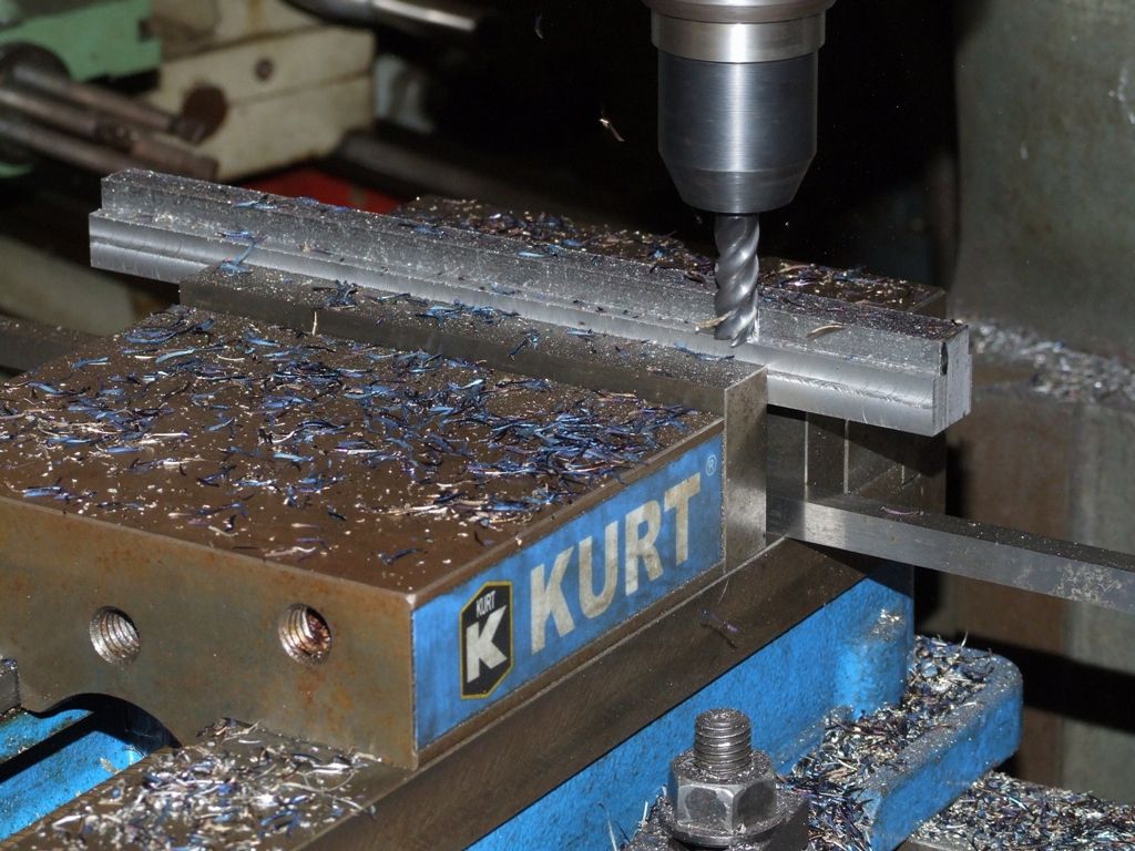

                    And making up for lost time this evening here's the mill in full flight; 1500rpm, 7.5mm depth of cut, 3mm width of cut and 500mm/min feedrate. Loads of blue swarf.
