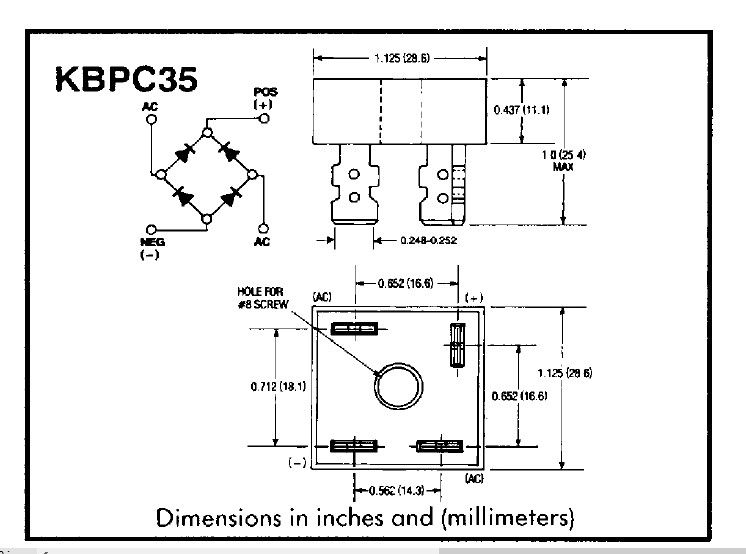

      I have a favorite, old battery charger that dates from the 1970s. It switches between 12v/6v, has a hi/lo setting and delivers up to 8A via an inbuilt ammeter.
      But the other day it stopped charging. I have some electronics knowledge, so I put a 12v 12w bulb across the output with a DVM in parallel and reasoned that as I seemed to be getting about half the required voltage perhaps the bridge rectifier had failed on one leg.
      I found a KBDC 3502 bridge rectifier on the web that was rated to 35A and 200V. That seemed to have the safety margins so I bought and installed it. But the charger is still not right. I seem to be getting the right volts if I put the output onto a charged battery (voltage rise from 12.5v to 13.4v) but it will not deliver much current. If I put the 12v 12w test bulb across the battery and charger the voltage drops to 12v and only half an amp seems to come from the charger.
      So have I got the wrong bridge rectifier and is it not switching fully? rather than a 200v maximum should I have got one with a 50v maximum. I don't understand rectifiers.
      I cannot see that there can be another fault with the charger. It is a transformer with switches and wires so either there is a circuit or it is blown, and since I can drive 0.5 amps through a bulb it can't be open circuit anywhere.

        what is the correct one for a 12v battery charger?

          That style or rectifier has been around for donkeys years and I've used several in the past to fix old style battery chargers with every success. Assuming you haven't been unlucky and been supplied with a faulty unit I have to ask if you are certain its connected the correct way round. Usually one terminal blade is rotated by 90° with respect to the others. That one is the + output and the one diagonallu opposite is – output. AC input is via the tow diagonally opposite terminals that are the same way round.
          If your DVM has a diode check function its relatively easy to verify that the innards are OK by disconnecting the rectifier and measuring between between the AC terminals and the DC outputs.

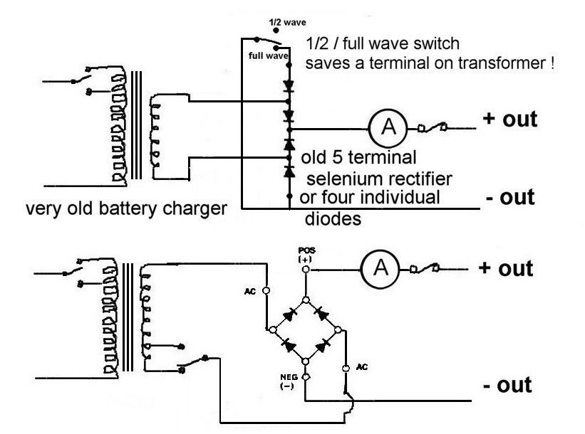

            Hi Norm
            its possible you have a faulty switch or a corroded connection
            photos showing how the charger is wired would help
            if I remember correctly
            decades ago, I looked at a battery charger that had a 6V/12V switch that selected all or part of the secondary winding
            a second switch controlled the charge rate by connecting all or part of the bridge rectifier to the ammeter
            this gave you the full or halfwave rectified output from the transformer – easy to do with the very old 5 terminal selenium rectifiers

              That voltage rating is fine, I often use 1N4007 rectifier diodes which are 1000V and 1A rating for low voltage circuits  but with lower current than yours.

                Humm, thanks for those thoughts, and for confirming that a 3502 should work. I'm 99% sure the rectifier is wired in correctly as I checked the same diagram as shown above. If it wasn't I would not be seeing 13v surely?
                The Hi/Lo switches tappings to the primary on the transformer, and the 6v/12v switches tappings on the secondary and then feeds the rectifier, so perhaps it does switch half to full wave?
                I like the suggestion of a dirty/failing switch. All the wires are soldered on (good old seventies construction) so perhaps I will try a jumper lead on the backs of the switches tomorrow and see if I can get more amps to come out. Just be careful of the switched 250v input.
                It has got a reverse connection protection device with a resettable button on the output – I suppose that could be putting some resistance in the line?
                I think I will put a 60w bulb across the output and see just what gets hot in the circuit after several minutes, and that will be the failing part.

                      two possible charger circuits to go with my previous post
                      switching between half and full wave rectification saves a terminal on the transformer –
                      making the bean counters happy if it makes the transformer cheaper
                      I expect the second diagram is more like your charger

                                                with the simple type of car battery charger without any electronic control
                                                switching between half and full wave rectification can only be used to control the charge rate with a transformer designed for this application
                                                switching between 6 and 12V battery charging can be done two ways
                                                either by having a centre tapped primary designed to have the mains applied to half of the winding for 12V batteries
                                                or a centre tapped secondary – half of the winding used when charging 6V batteries , in this case the current through the switch is greater
                                                when using a full wave rectifier additional transformer taps will be needed to switch between high and low charging rates
