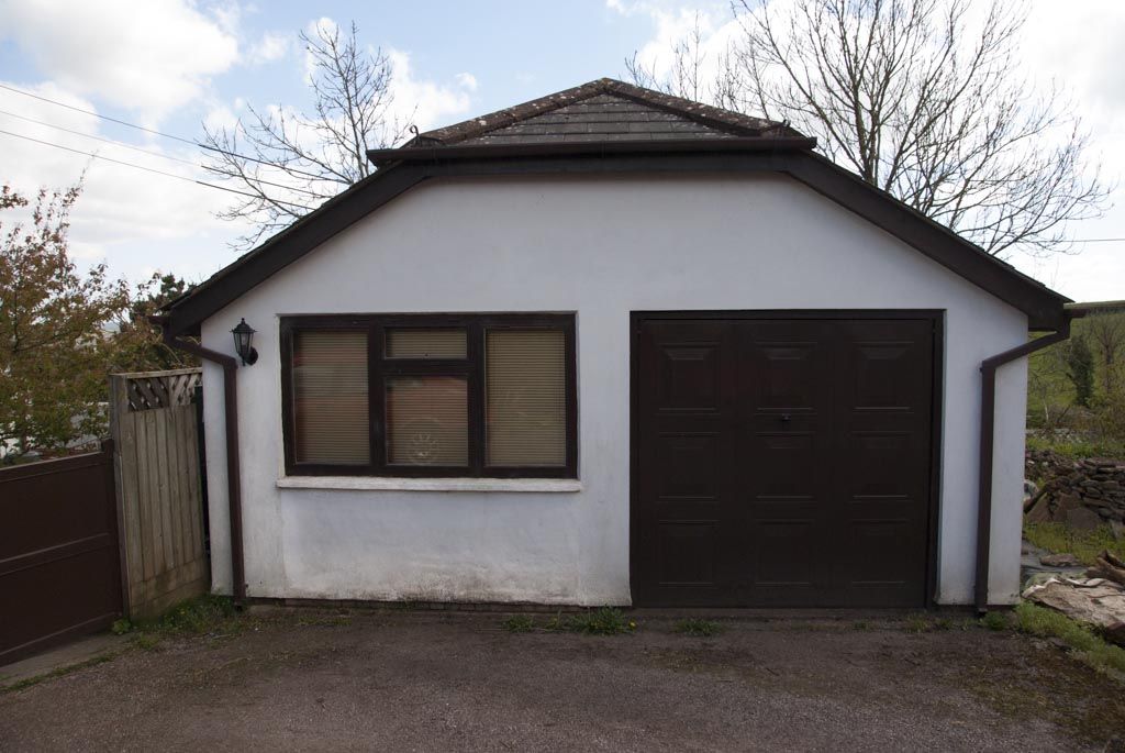

      Hi all, I am about to buy a house in Whitehaven, Cumbria, with a large garage which i want to use as a workshop. Bricking up the up and over door will give me more useful space for workbenches and keep the cold out. Has anybody done this and what should i look out for. Garage has a side door as well for access. I was thinking of putting in a window in the new brick wall to give me some light. thanks for looking

          I would use outward opening insulated double doors with burglar resistant windows instead so there is plenty of room for receiving heavy machines in future. Colin

            This was my solution, done in a day. 2"x4" pressure treated framework sat on a DPC stuffed with insulation two layers of Soundcheck plasterboard on the inside, tar paper on 3/4" board on the outside with lapboard finishing. I made the door too, that is 4" thick full of Kingspan insulation. Simple, cost effective fast and above all, well insulated, both thermally and sound wise. Don't over think the issue. Oh, and you can try getting the door off if you want, you will fail.
            My garage is split, it is extremely long. Only the front 12' is workshop so about 11'x12' the rest, at the back, is for other stuff.

              I'll back-up the don't brick it up advice. Make a new" wall " from timber that would be capable of being opened, even if it means taking out a few screws or bolts ( from the inside of course ). Never when it might be useful. Easy to insulate. Ps Nice part of the world that.

                I have also converted my garage into use as a workshop – the original up-and-over door has been replaced by outward-opening half glazed French doors – taking Colin's point it makes access easier for heavy machines. As the French doors are less wide than the steel door that they replaced I have also fitted a wooden side panel (insulated). When doing the conversion I took the opportunity to specify a 'wheelchair' threshold for the doors – meaning that there is effectively no threshold to trip me up, and moving machinery is far easier. The other thing that I did was to fit a high security (anti-everything) lock to the door – recommend CISA Astral S. Expensive, but far superior to the cheap lock supplied with the doors.
                I also removed and bricked-up the existing window – improved security and somewhere for more shelving.
                Something else that you might want to consider while you have an empty garage is insulation – I have 18mm thick plywood on the floor, covered with hardboard and painted, plus 25mm insulation with 12mm plywood sheets on the walls. The ceiling is insulated with 50mm insulation above 6mm plywood – the roof space has also been ventilated. Result – no cold surfaces to sweat and no condensation. There is no background heating or dehumidifier in use. However, I am located in the south-east where the climate is probably somewhat warmer that Cumbria.

                  I disabled the garage door mechanism, locked the door in place and then put two 4' x 8' blockboard sheets (edge to edge) across the space as close as possible to the door. These were fixed to the walls by battens and screws so that they could be removed without too much difficulty. The bottom sheet sits on the floor and effectively stops any ingress of water (rain, not flood) that would be blown under the door. The top, between the top sheet and door, has been left open but the result is totally rain and draught proof. The one disadvantage is that the dummy wall is too weak to carry any shelving.

                              Brick walls need a properly designed concrete footing to stand on likely to be 500 to 700mm deep x 300 wide, depending on your local regulations. and the connection to the existing building needs to be flexible you will need sliding ties **LINK**
                              A lot of work compared to an insulated timber frame, I would go with lightweight construction. You will still need to dig a few pads for the frame to sit on, and have a plan to drain rainwater away or you will have a damp floor.

                                    I was in a similar situation to you in that, having moved, I had a large double garage and no workshop! On the principle that cars are waterproof I didn't feel the need to use the garage! I did what you suggest – took off one door and put a window in. I then added a partition so that half of the garage became the workshop.
                                    Voila! – cosy corner!
                                    I won't bore you all again with the lengths I went to to make it dry and warm but if you would like to know more,  just send me a personal message and I will be happy to oblige.

                                            Referring to my 'photo above – which is probably similar to your garage before modification. No need to bother about a new concrete footing as an extensive slab already existed for the garage base and lightweight blocks were laid onto that. Don't forget a DPC though and do ensure that you tie the new blocks to the existing structure. The blocks were rendered to match the existing – it looks worse in the 'photo than in life! – not helped by all the muck that got splashed up in the recent rains! The ( substantial!) window was made for me by a local carpenter at a price too good to miss. Not much weight in this mod as there was an existing lintel over the original door so it was just the weight of the window frame + glass plus a few lightweight blocks and render.
                                            If some future purchaser of the property wishes to convert it back to a garage it would be an easy ( if very foolish!) job to do so.
