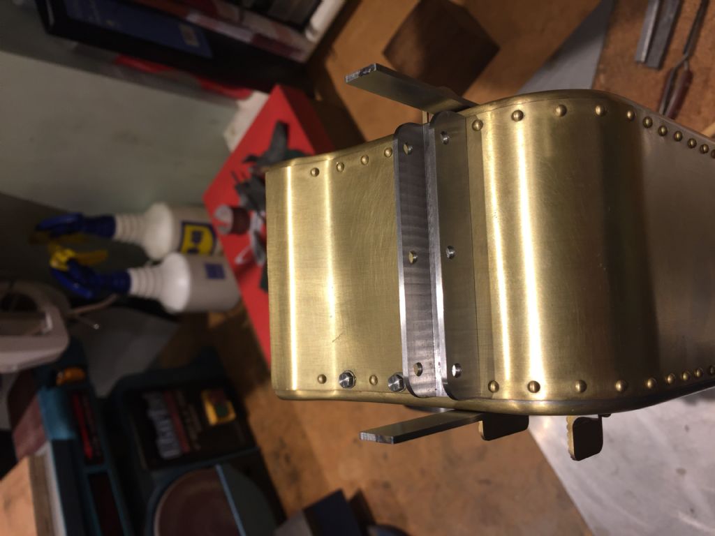

                    I have inadvertently made the draw bar for my minnie out of stainless.
                    When i finally paint the tender, do you think this would take the paint ok ?
                    Thanks.
                    Brian

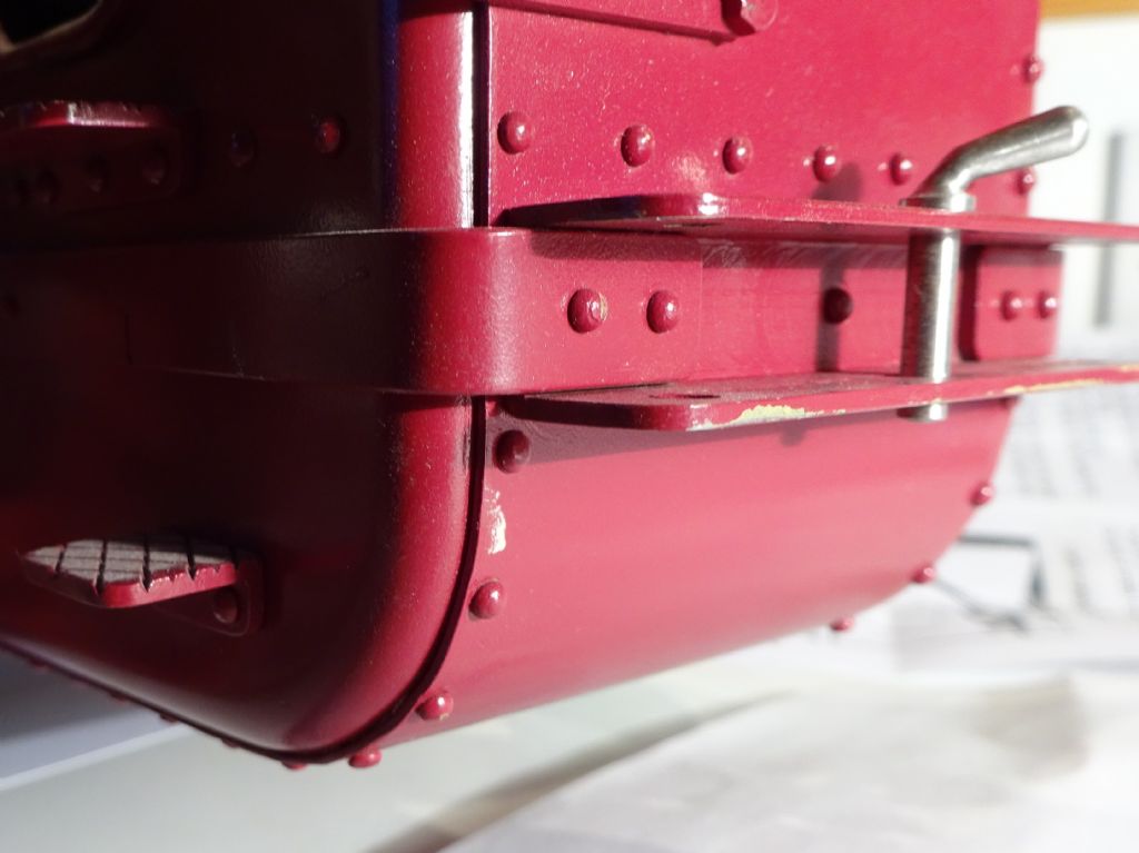

                      #282165
                      Brian Abbott
                        @brianabbott67793
                        Etch primer..Ok..

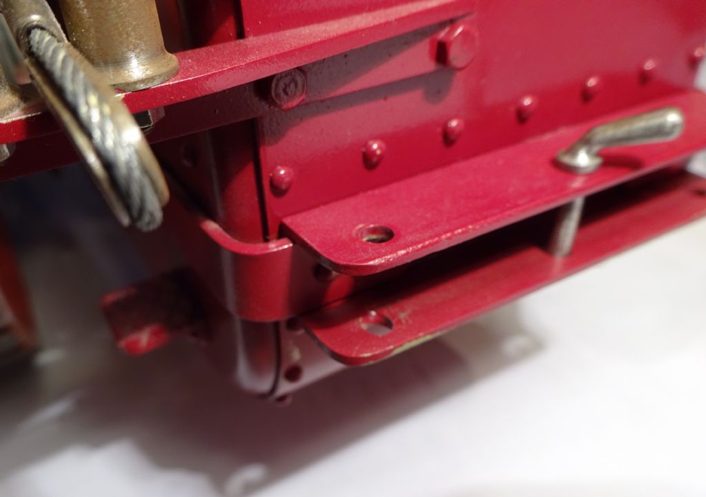

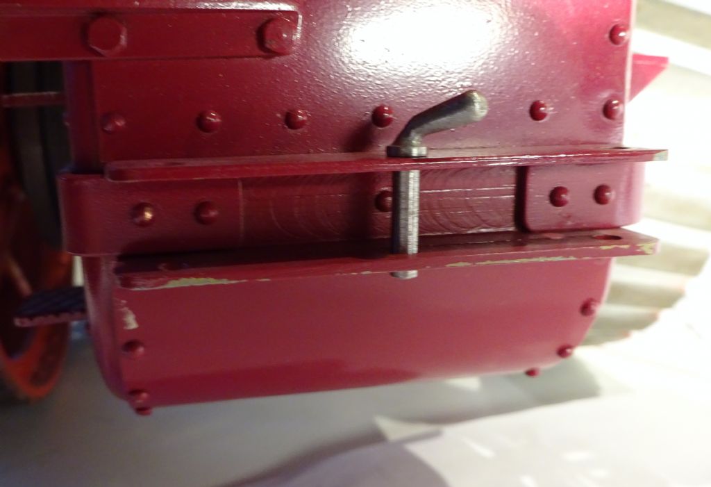

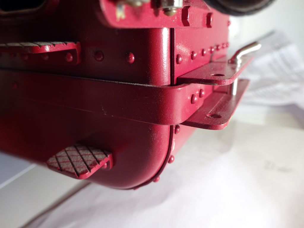

                        Jason, when you get a chance, would you mind posting a picture of the tender on your Minnie, Ideally around where the draw strap wraps around into the draw bar, viewed from the back
                        Thanks Jason.
                        Edited By Brian Abbott on 03/02/2017 13:16:43
                        #282173
                          Will do.
                          Better dust it firstblush
                          #282188
                            #282217
                            Brian Abbott
                              @brianabbott67793
                              Thanks Jason,
                              just wanted so see how you had bent the draw strap round the corner into the draw bar.
                              i've done mine the same.
                              Thanks again

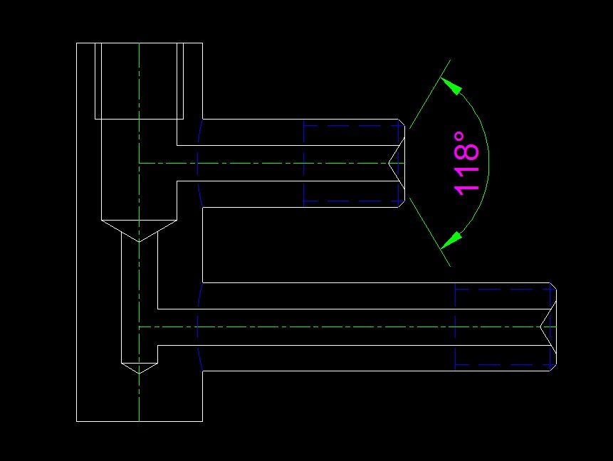

                                This is a sketch of the by pass valve on the Minnie i am building.
                                Unsure of the angle of the pipe cones, in the past i have just used the drill angle which seems to work ok, is this right ?
                                Thanks.
                                #286469
                                  Should be 60degree inclusive, easily done with a centre drill and will then match off the shelf nipples/ferrules
