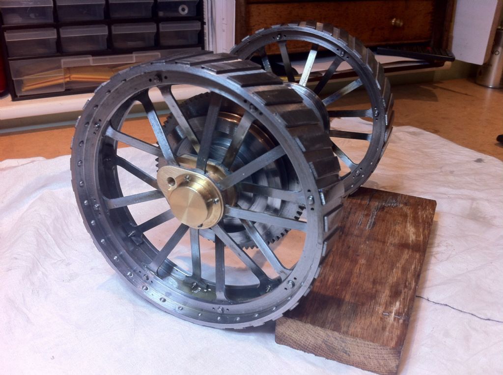

                          Quick update on the wheels, all soldered up and progressing well.
                          Jason did warn me about corrosion but since soldering these I seem to be battling the rust.
                          Might just be a coincidence.

                          Brian Abbott
                            @brianabbott67793
                            #181923
                              Looking good, now for the fun job of riviting in the spokes!

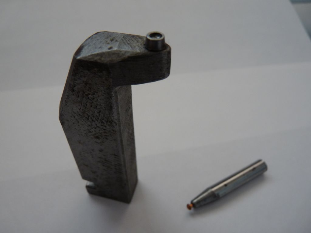

                                      CotswoldsPhil
                                        @cotswoldsphil
                                        Hi Brian,
                                        This is the dolly made many years ago when riveting Minnie's rear wheels. I also used a hollow punch to settle things down before trying to close the rivet.
                                        Getting the length of the rivet is important for a correctly formed head, a little experimentation as Jason suggests will pay dividends. I made a little shear tool to crop the rivets to length once the correct length had been determined. (there are quite a few to cut!) I tried side cutters but then the rivets tend to fall over to one side.The length will vary depending on how good a fit the rivet is in the hole, first it will expand to fill the hole and then start to form a head.
                                        The dolly can also be used on the smoke-box ring, when you get there, by repositioning the snap, that's what the slot is for at the other end.
                                        Regards
                                        Phil

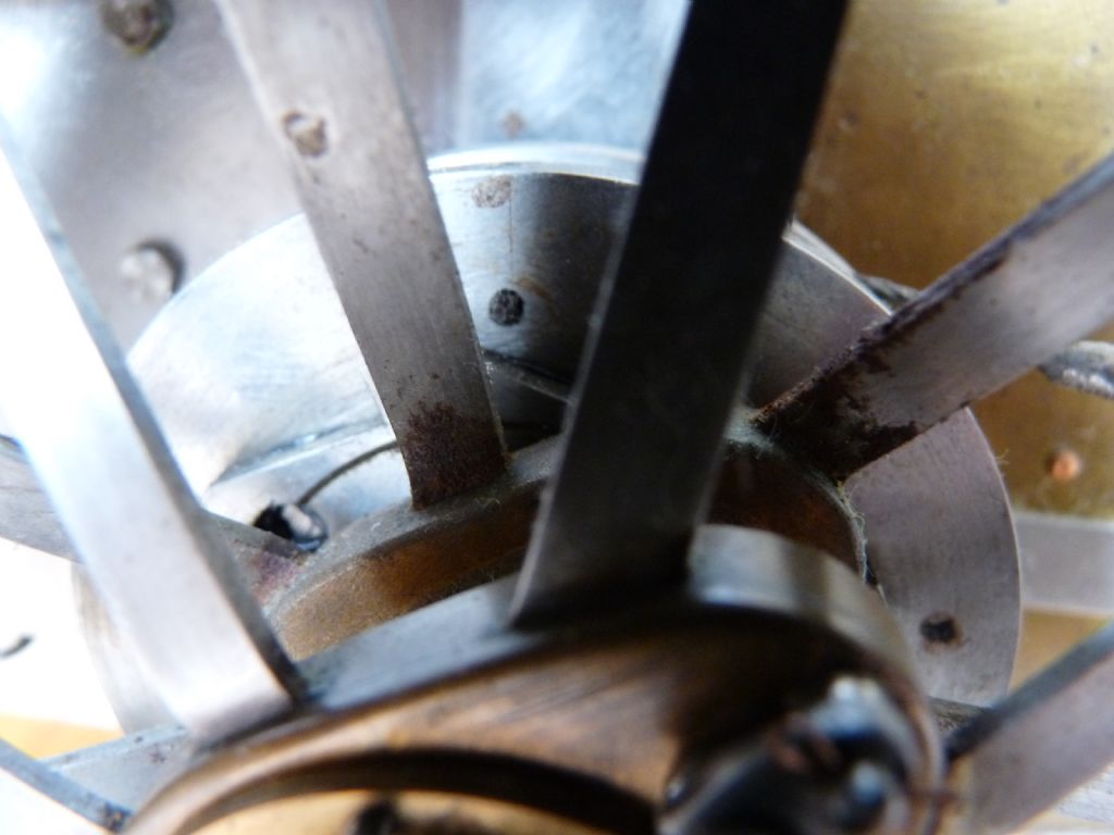

                                              Hi Brian,
                                              So that you know you are not alone…
                                              After soldering, my wheels leached flux from the Bakers Solder Paste at the root of the spokes for a long time. I think this is why I have avoided painting for so long.
                                              If I was doing it again, I would use slow set epoxy resin, I think I mentioned this in an earlier post.
                                              I'm sure someone here will be able to advise what method to use to remove the flux.
                                              This is what mine looks like after some 30 years…
                                              Regards
                                              Phil
                                              Edited By CotswoldsPhil on 19/03/2015 11:27:03
