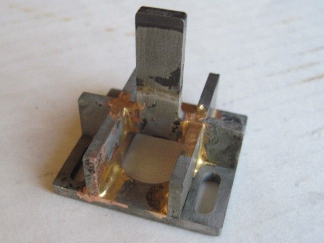

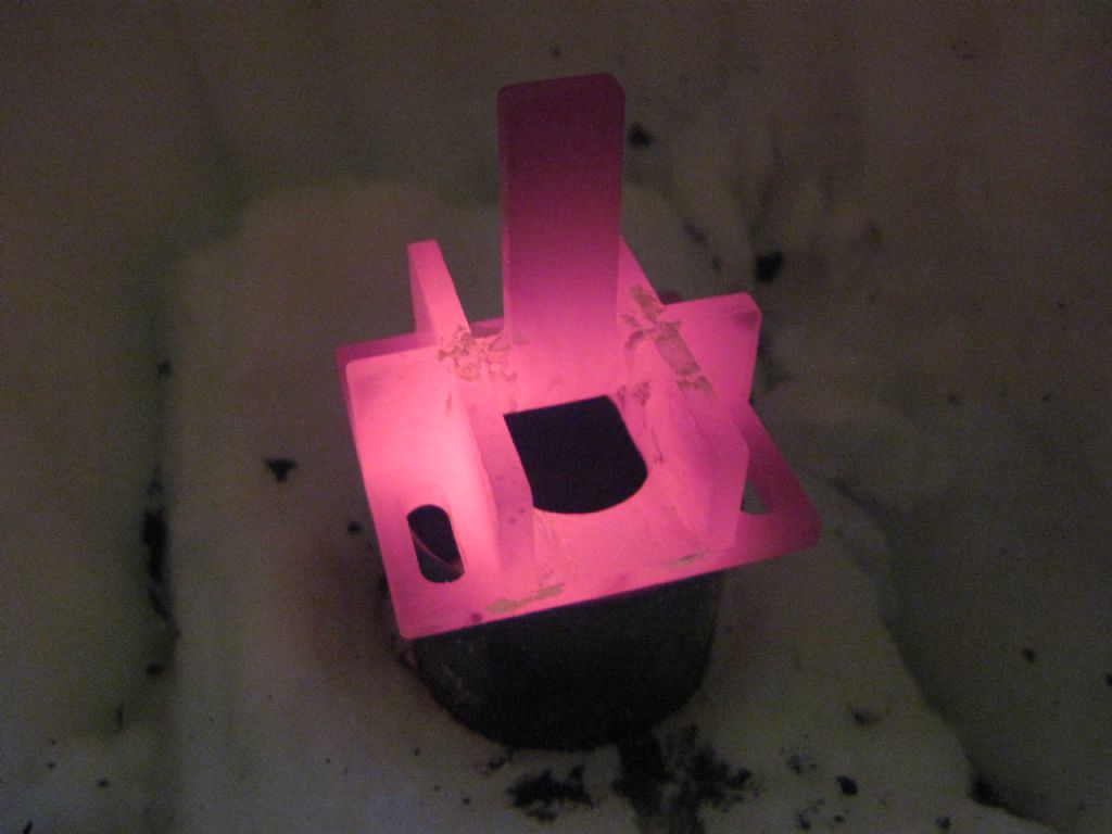

                                                  Hi AD,
                                                  The Bullfinch should handle that work with no problems, provided the work is clean, you use the right flux (?) and you can 'contain' the heat (I use a simple hearth inside).
                                                  Drag Bar 3
                                                  This is a similar sized part (3mm laser cut steel – base being about 35mm square) and the only problem I had (at first) was not allowing any gap for the Sifbronze to flow into. Second attempt worked fine – just a problem of my technique, not the torch.
                                                  Here is the finished part – not perfect perhaps but very strong. If you look in my 'Brazing' photo folder, you will see some larger items I brazed with the Bullfinch. Only when trying to join the very large plate to its base (it's about 180 x 120 x 100mm) did it struggle with the Sifbronze – and I had to use silver solder to complete it. These days, I would have just added some more heat from one of my other (disposable) propane.butane mix torches (as the metal radiant area was quite large) – and shielded it better.
                                                  Drag Bar 4.
                                                  The Bullfinch 404 is not a replacement for Oxy/A but works very well for small ferrous fabrications. There are many users of Sievert torches here (I have a similar (non-Sievert) torch myself) and they are certainly good where I want large volumes of heat (e.g. for boiler work). However, the Bullfinch is very good for the work I use it for – and Sifbronze is at least an order of magnitude cheaper than silver solder (which I still use of course for non-ferrous brazing).
                                                  So I'd suggest you practice with Sifbronze and the right flux – making sure that the work is correctly shielded and the filler can flow into a slight gap in the parts (similar to silver soldering really).
                                                  Have a look here – I use the 1.6mm rod by the way (£26.85 for 1kg ! ). They also do the correct Sifbronze Flux – 500gm for £13.75 (inc VAT) which will last you some time.
                                                  Sifbronze No 1
                                                  Regards,
                                                  IanT
