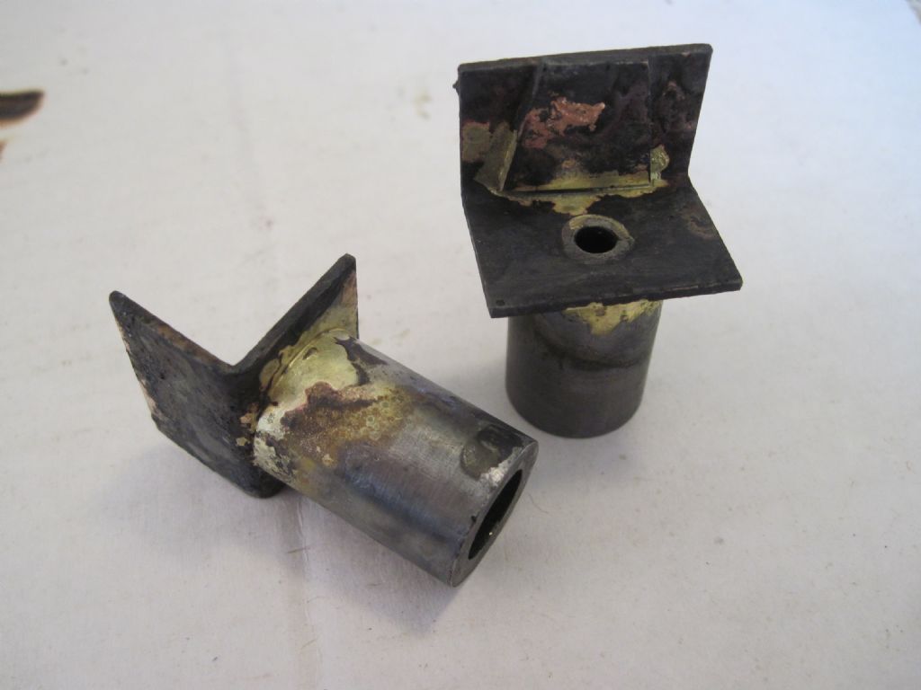

                    Hi Con,
                    I build in 2.5" gauge (Gauge 3) too and have used brass and silver brazing to make various small fabrications. I've not attempted a 'bogie' as yet – but have assembled a loco building frame from laser cut parts which is a good bit larger than any of my bogies.
                    LBSC used to describe "SIF-bronzing" – which is simply brass brazing by another name. In fact I use 'SIF' brazing rods and 'SIF' flux for my brass brazing (SIF being the brand name). If you search for "SIF" you should find the brazing guidelines they published at one time (although I haven't checked this recently). I purchased about sixty 1metre SIF rods a few years back for about £30 – a lifetimes supply for most hobbyists – and a great deal less than silver solder would cost. It also helps if you watch for special deals – which the welding dealers sometimes have.
                    Whilst I trained with Oxy/A at welding classes – I couldn't justify the cost for home use. So I purchased a Bullfinch 404 brazing torch which works just off propane. This torch is good enough for small items but will need help (extra heat input) if you want to work on larger masses. It can of course also be used for silver soldering/brazing – which it does with ease.
                    Jason makes a good point about silver flowing more easily and not tending to 'lump' quite so much as brass but this is about getting enough heat into the part without burning off the flux. This is certainly easier to do with Oxy/A than my 404 but care with heat shielding and component support helps. Smaller parts are obviously easier to do and suggests that 'staging' a larger fabrication makes good sense. I have built assemblies mostly using SIF brazed parts, with final assembly with silver solder – which is much cheaper and a bit easier.
                    As an aside – I am a great fan of Kozo Hiroka's silver soldering recommendations – which I use whether silver or brass brazing. Essentially this involves holding parts in place securely (without heavy clamping), making sure there is clearance between parts (for capillary flow) and absolute cleanliness. He stage solders/brazes his parts – basically one major joint at a time with thorough cleaning in between. This approach also works well when using a brass then silver braze mix.
                    In summary – fabrications are good way to make custom parts. Brass brazing is useful and cheaper than silver soldering when fabricating steel components. Silver brazing is really the only way to braze brass fabrications (or brass & steel ones). Both need high heat which will require some clean-up (I use Citric acid) and brass is not quite as easy to get a neat joint with as silver. But if you think of this as making a custom casting – then you can machine it clean and true it up anyway.
                    Hope this helps. There are some photos in my album (in Brazing) of the engine frame which was brass brazed – and last week I made a couple of small stand-offs to fit a DRO to the front slot of my Atlas MF mill. Simply some steel angle brazed to cylindrical turned parts – with some 'thickeners' added to allow deeper tapped holes in the angle. They need a bit more work to finish them and make 'em presentable. They could easily have been silver brazed instead but this took the same time and helps to conserve my precious (e.g. expensive) silver solder stock for when I really need to use it. Once you start doing brazing (with silver or brass) it makes a lot of things so much easier and it will become a routine part of your hobby.
                    Hope this helps.

                      IanT
                        @iant
                        Yes, absolutely Eddy.
                        The parts above were held together with stainless steel screws, tight enough to not slip but not really wrenched up. However – the clearance was provided by simply making centre punch marks around the flat surface of the turned parts where they mated with the angle. This gives enough clearance for capillary action (a few thou) to take place. It's another of Kozo's tips, Very easy to do and makes for a tidy joint.
