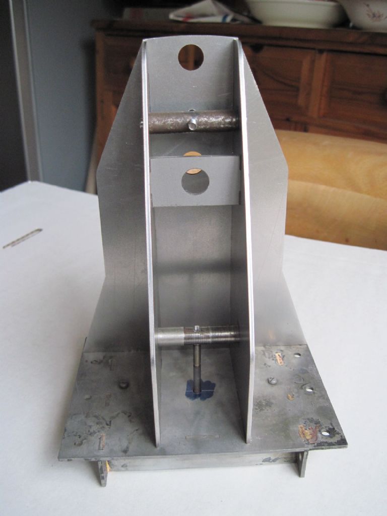

                      I've mentioned this a few times before – but for anyone interested you can certainly Sifbronze small steel fabrications without the expense and trouble of OxyA kit. However you will need a propane torch capable of the required heat outputs – and the one I have (a Bullfinch 404) can manage this. They are not cheap but are well made and I expect mine will last me my lifetime – I can also silver solder with it and I like the auto-ignition feature.
                      Why Sifbronze? – well I paid about £20 for 1kg of 1.6mm Sifbronze No 1 (about Qty 60 x I metre lengths) – so it is considerably cheaper than silver solder! I still have quite a few lengths in stock. Using a larger propane tank also saves money over disposable gas bottles.
                      I've just checked current pricing – 1kg Sifbronze No1 (Approx. 60 x 1.6 x 1 meter rods) is £26.85 (inc VAT) from WeldEquip (not some no-name Ebay supplier) – whilst Qty 5 x 1.5mm x 500mm 524 Silver Solder is £21.77 (inc VAT & Delivery) from CuP.
                      So if a fabrication is not too big (and made of steel) – I tend to use Sifbronnze but for other (generally non-ferrous) applications I will use my precious (e.g. expensive) 524 silver solder.
                      Is it worth the extra cost of the Bullfinch 404? Well, certainly it is not for everyone. It will depend on how much small scale steel fabricating you need to do – but I use mine a fair bit and find it very useful.

                      Side Frame Assembly End Assembly
