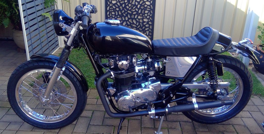

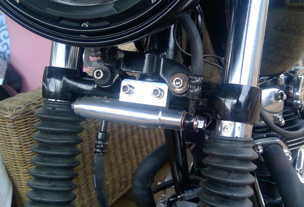

      This is a new brake line block I machined up to replace the original. The original hoses were rotted, so I replaced them and did away with the two steel tubes that connect the hose to the calliper and the hose from the master cylinder to the divider. Unfortunately, the new hoses have the banjos on the same plain requiring the lower hose to be twisted through 90degrees to connect to the original divider, so I machined a new divider to get around the problem. The lower hose connects at the rear of the divider, as does the brake light switch. The top hose connects to the side of the divider.347234372_286809430441186_6542214020676610329_n.jpg

          Looks good but to my eyes its way to big and the whole line assembly holds far too much fluid.
          Banjo unions too. Yuck.
          My experience is that to guarantee proper bleeding, especially with stainless braided (Goodridge et al) lines the total fluid capacity of one pipe run must be less than the brake calliper contents so one side can be fully flushed with the other side pistons strapped down into full retraction. Usually such extreme measures aren't necessary but sometimes you get bubbles that just won't shift.
          Shudders at the memory of a wasted weekend almost taming a friends 1000 cc Kamasaki four pot.
          I use straight angle connectors with baby T unions, the bronze ones they used to fit the Girling systems on Minis et al if I can get them. Straight through all the way so the fluid flows properly and drives the air up and out when the pistons go back.
          All done in one run through.
          I've always had a thing about front brakes working.
          If they can't lock the wheel at ton plus they get sorted.
          Right from the superb 8" single sided one on my DB32 Goldie (190 mm, crap, way too hard to set up right) through the unfairly maligned BSA/Triumph TLS conical hub to the 4 pot Yamaha ex FJ 1200 pair that replaced the standard twin piston Yamaha crop on my Norton Commander.
          Finally giving it brakes to match the big rotarys performance. Quote from the official unofficial kid sister, the girl who put the agg, res and sive into aggressive riding, "Grandad bikes shouldn't be so fast." Coercing BMW brakes to behave was a total pain. Especially the lunatic swinging caliber ASTE versions.

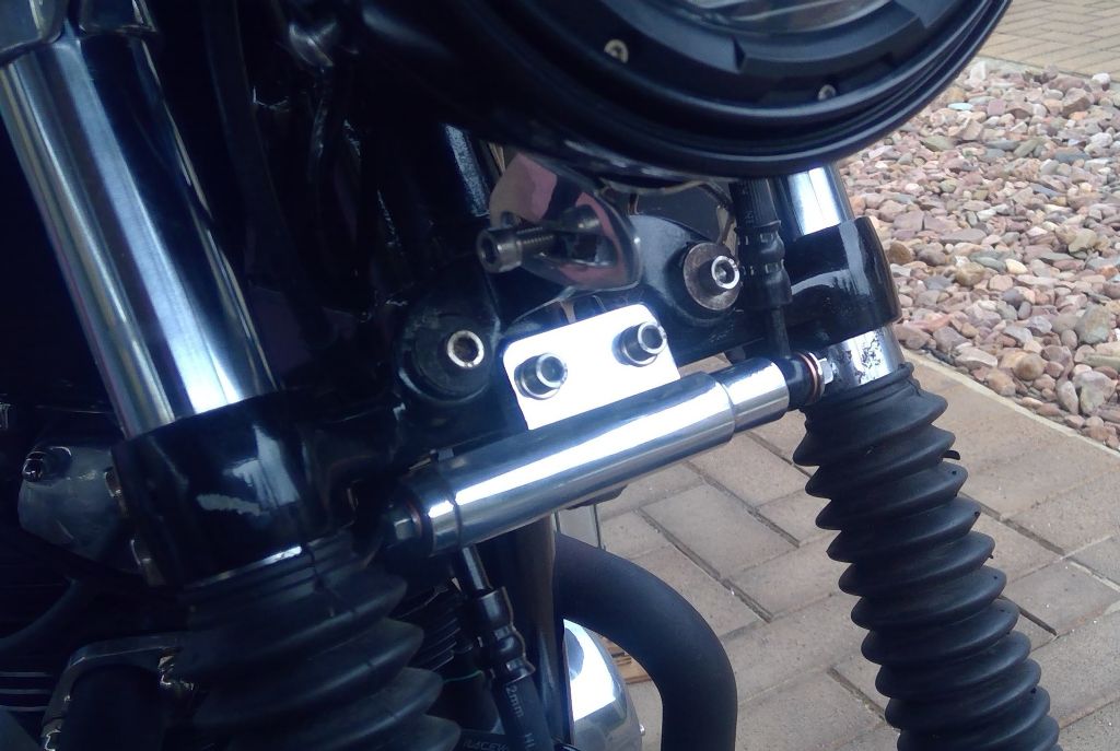

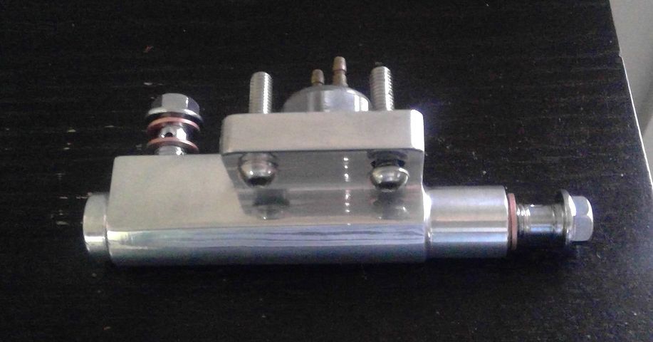

              359437738_3588581628068524_4850308291941790472_n.jpgI don't think a 3mm hole really holds that much fluid.  Personally I like bajo fittings, that's why I used them.
              I could have anodised it, but I think it would have looked out of place on this bike.  What do you think?

                      Most motorcycle brake lines use banjos, I've never seen one leak or cause an accident.
                      The original setup.on the XS650 had a banjo and hose connected to the MC, on the other end of the hose was a cup/ cone arrangement connected to a steel line which connected to the junction box via another cup/cone fitting.
                      Then there was a banjo and hose connected to the junction box, running down the fork leg, that connected to a steel line via a cup/cone, then on down the fork leg connecting to the caliper by a another cup/cone fitting.
                      That's six fittings and 8 sealing areas.
                      I'll stick with banjos!

                          Well,the idea behind it was something that you can see, something that draws your eyes. You can't hide everything under a plastic cover. Have a look at the bike, if I hid everything, or made everything smaller, less noticeable, it would be a totally different bike. This is what I like, it's the look I was after, so, that's the way I built it.
                          You'll notice, the inlet hose is on the left and the outlet pipe is on the right, the junction was made to span the width, so the outlet hose follows as straight a path as I could get down the fork leg, allowing for the up/down movement of the forks.
                          Now if I replace the upper hose with a rigid pipe,how would I adjust the MC angle, how would I adjust the handlebar angle, how would I change the handlebars? And then there is the aesthetics: This system fits in with the design of the bike. Maybe, not to everyone's liking, but I haven't built to please everyone, just me!
                          I have similar parts like this in areas you can't even see, but I know they are there and that pleases me. I could have made the seat more compact, the side covers less noticeable, the catch can smaller, the air filters more compact, the cooler less noticeable, the spin on filter less noticable. i could have painted the engine silver like a stock XS650, I could have painted the bike in a brighter colour, put a squarer looking tank on it, longer mudguards, painted the wheels black, made a two into one exhaust, I could have anodisedall the aluminium instead of polishing it. In short,I could have have done a lot of things differently, but still there would be someone who would suggest I could have done something different to fit In with their bike ideology.
                          The bike follows my design philosophy, that's the way I built it, the way I like it. I'm pleased with what Ihave built.!
