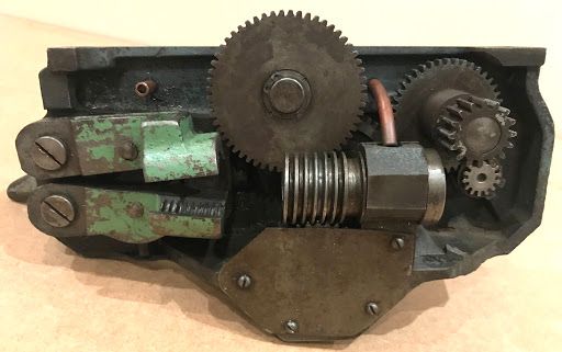

        I'm slowly ticking off a long list of jobs repairing an old Boxford Model C. This lathe has a 3/4 x 8 TPI acme thread leadscrew in reasonable condition. By contrast, the half nuts are worn unevenly, with a very noticeable sawtooth effect and they fail to hold effectively when feeding towards the headstock. The half nuts have a tendency to skip / jump when under the lightest of loads. Everything is done up snug and there is no obvious way to adjust or shim the half nuts any tighter.
        half
        My conclusion is the half nuts need to be repaired or replaced. Maybe the best solution would be to bore the thread out of the half nuts, replace with a sleeve nut, fix with epoxy and then split into two halves. I would need to fabricate a suitable jig. I have access to a suitable mill at work but tooling is limited. A ready-made sleeve nut might reduce the work, otherwise I'd have to make one myself including the internal thread. I haven't found any UK based suppliers online, only US based.
        The alternative solution might be to build up the thread (how?) and then tap the existing / repaired thread. I don't have a suitable tap and I'm not convinced it would be easy to tap the two split halves, held slightly apart, even if held in a jig.
        I suppose it's possible to make an entirely new half nut mechanism, maybe using a plastic insert melted onto the leadscrew thread, but I haven't given this option much thought.
        What would you do? Thank you.

            The tricky part is the way they are on an arm as a casting and there is not much meat in the bit surrounding the threaded part. Not sure how easy it will be to find a nut in the UK. Then make sure your silver soldering is up to scratch to attach the embryo nut as the residual wall once threaded won't be able to add much support leaving only the back wall of the thead to grip.

              The original part was made from a single casting that was split after being drilled & tapped for the leadscrew – would it not be easier to make a complete replacement along similar lines than try to add a threaded insert ?

                        Interesting, but probably not practical. Unlike a Myford, which moves the half nuts vertically to engage & disengage the screw, a Boxford/ Southbend arrangement pivots the two halves :
                        So the "shim" to allow re-tapping would not be parallel & the engagement mechanism may not have sufficient travel to engage the screw after the modification.
                        Nigel B.

                          You could use the same method to repair as is common on Drummond M-type halfnuts. There have been a number of threads on here and at least one article in MEW in recent years on it.
                          Basically a "bobbin" is turned up out of brass with the internal thread to match the leadscrew. The OD is parallel with the small flange on each end for location.
                          The old thread is machined out of the halfnut pivoting lever by clamping it to the cross slide of the lathe and boring it with a between centres boring bar.
                          In the case of the Drummond, the bobbin is cut in half and soft soldered into the machined halfnut lever. With a pair like the Boxford, some care would need to be taken to get the two halves exactly aligned. Maybe as suggested solder it all together first then cut the bobbin in half.

                                If I could make a jig to hold the two arms/nuts at the correct distance and was able to bore out the thread plus enough to install an insert, that might be easier to making a complete replacement. Maybe.
                                As it stands, the half nuts don't work so there's not much to lose in trying to improve them.
                                      Nigel B.
                                      I watched a video late last night – sorry, I don't have the link to hand – in which a Boxford owner managed to bodge a repair by adding a blob of weld to one of the engagement pins thus forcing the half nuts more tightly together. Seemed to work but was not pretty!

                                          Have you checked that the two half nuts are allowed to engage fully? If not, the wear rate would be increased.
                                          If movement is restricted the internal threads will not engage the Leadscrew sufficiently.
                                          So is there any means of adjustment, or facility to increase engagement? Could the heel on each of the two halves be fouling before full engagement?
                                          Howard

                                              Both sides appear to be engaging "fully" (in as much as their worn state allows) but the sawtooth effect of the wear allows them to rise and jump the next thread, if that makes any sense.

                                                    Each nut/arm has two removable pins that could aid with work holding in a jig. They also have a machined face. I think holding the work securely for boring is totally doable, just a bit time consuming for a one-off job. My greater concern is there is not much "meat" (as mentioned by another poster) to remove for a sleeve.

                                                      It would be too much to hope that the pins are eccentric to enable the arms to be adjusted?
                                                      If the two arms are going to be machined, (to remove the worn half nuts and then to bore / screwcut / tap the replacements ), they will probably need to be separated by a spacer, to simulate the fully engaged position.
                                                      If you want to Tap the thread, Tracy Tools may be able to supply a Tap, but it will be a high cost per thread, unless you want to make a business, or a habit of the operation.
