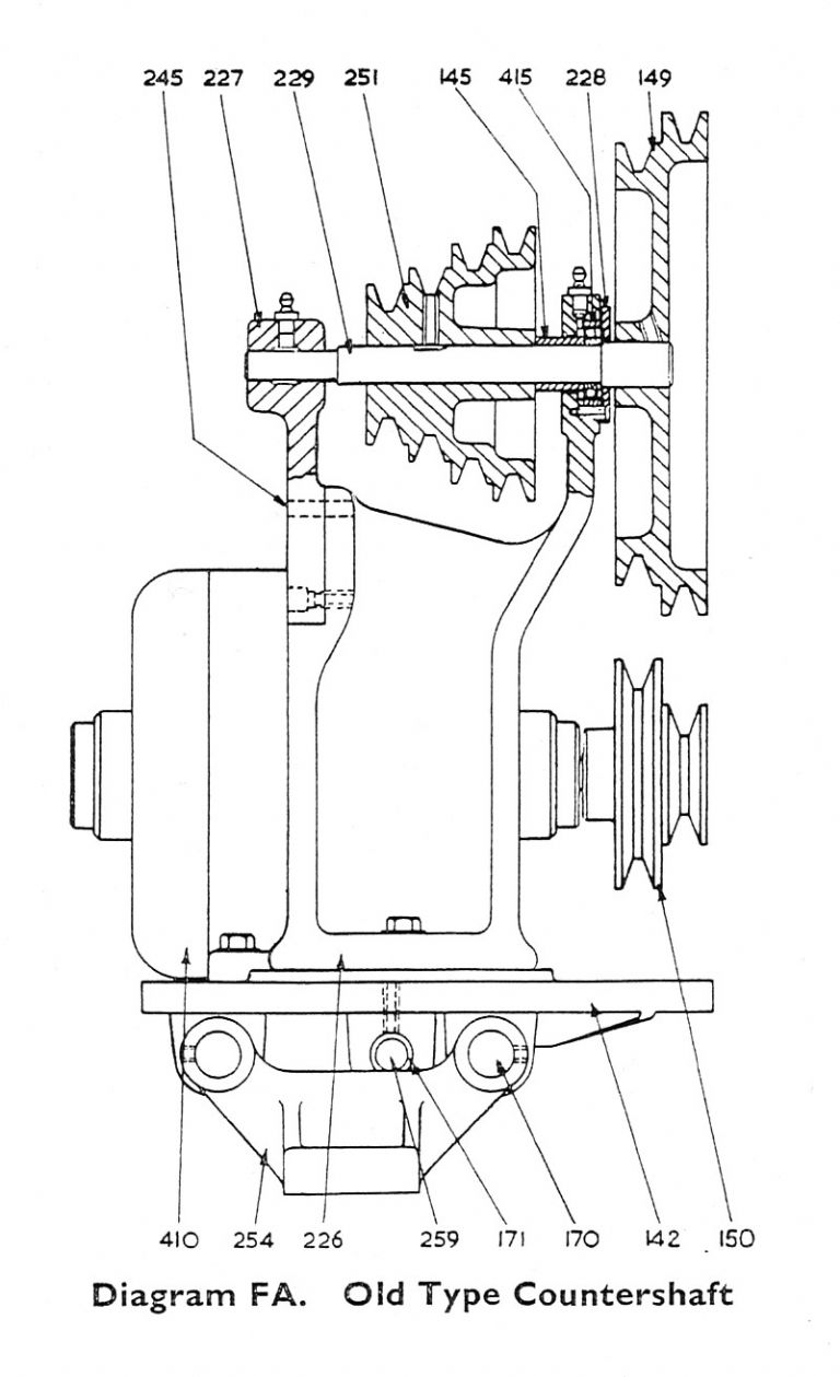

      Hi, new here so please bear with me. I have just acquired a Boxford lathe, rear drive, powered cross slide. Model c?. Everything seems to work. I am in the process of cleaning, lubricating and setting it up square level etc. I have purchased , know your lathe, however I can't find any information on the rear pulley set up. The double pulley and the 4 pulley are not fixed as I thought they would be and have play of about 20 degrees (guessing) between them. I have not looked to see if it's a key or screw fixing but wondered if anyone knows, should both pulleys be securely fixed with no rotation between the two. Many thanks Rob

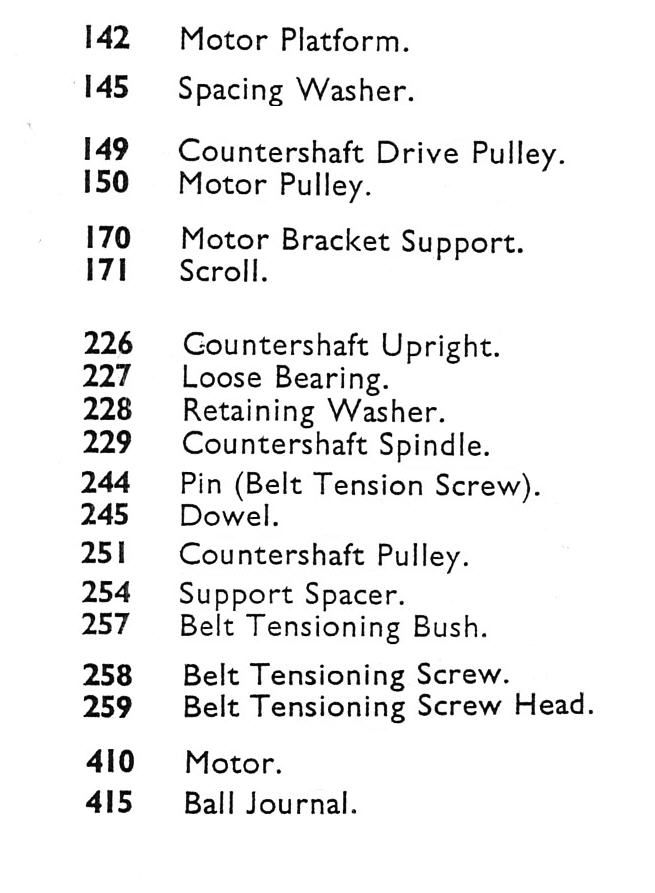

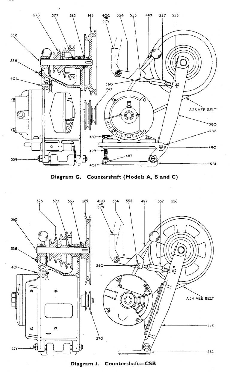

            Hi Robin, below is a scan of two types of countershafts, I guess diagram G is the one you need,
            The list of part number descriptions can be seen List 1 List 2.
            Part 149 is the Countershaft Drive Pulley, which is in a different list that I have not shown.
            This however, maybe what you have Diagram HA and List 3.

              Based on my Boxford the large double pulley has a grub screw and a keyway. The 4-step pulley has only a grub screw.
              Both grub-screws tend to loosen and when this happens on the 4-step pulley you could well see the movement you describe. I haven't stripped mine down in years but IIRC this grub-screw bears on a flat on the shaft, hence a small amount of loosening gives quite a lot of angular movement.
              Incidentally, there are 2 types of rear drive countershaft, basically as diagram G above. They're similar to one another but the later one is more compact but gives an overall higher speed range.

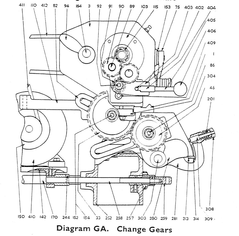

                  Hi folks, back again. My model A Boxford ( imperial screwcutting gearbox) lathe is in the process of behind stripped and lubricated etc. My lathe is rear driven and the tensioner for the rear pulley is under the gearbox. I have removed the motor / rear pulley cradle but I am struggling to remove the tensioner shaft. I cannot see any screws holding the shaft in place nor can I see how the knurled nut with the the round c spanner type holes and fixing screw is held in place . Is there a screw under the headstock in the casting?. If anyone knows I would appreciate the advice. Cheers Rob.
                  #568089
                  Clive Brown 1
                    @clivebrown1
                    Hi Rob, I'm puzzled by your description. The primary belt tensioner should pull down on the hinged motor mounting plate behind the lathe bed and completely clear of the gearbox. It's shown as parts 489 and 499 in diagram G in an earlier post above. Turning the knurled nut tightens the belt.
                    The only fasteners under the headstock are 2 screws clamping it to the bed.
                    The plate 581 is completely separate from the lathe itself and should be bolted down to the bench behind the lathe.

                        Hi Robin, perhaps these scans are what you need.

                          That's the very thing. Appreciate that Nick, I can see the fixing screw is located from the bottom, nothing like making it easy!
