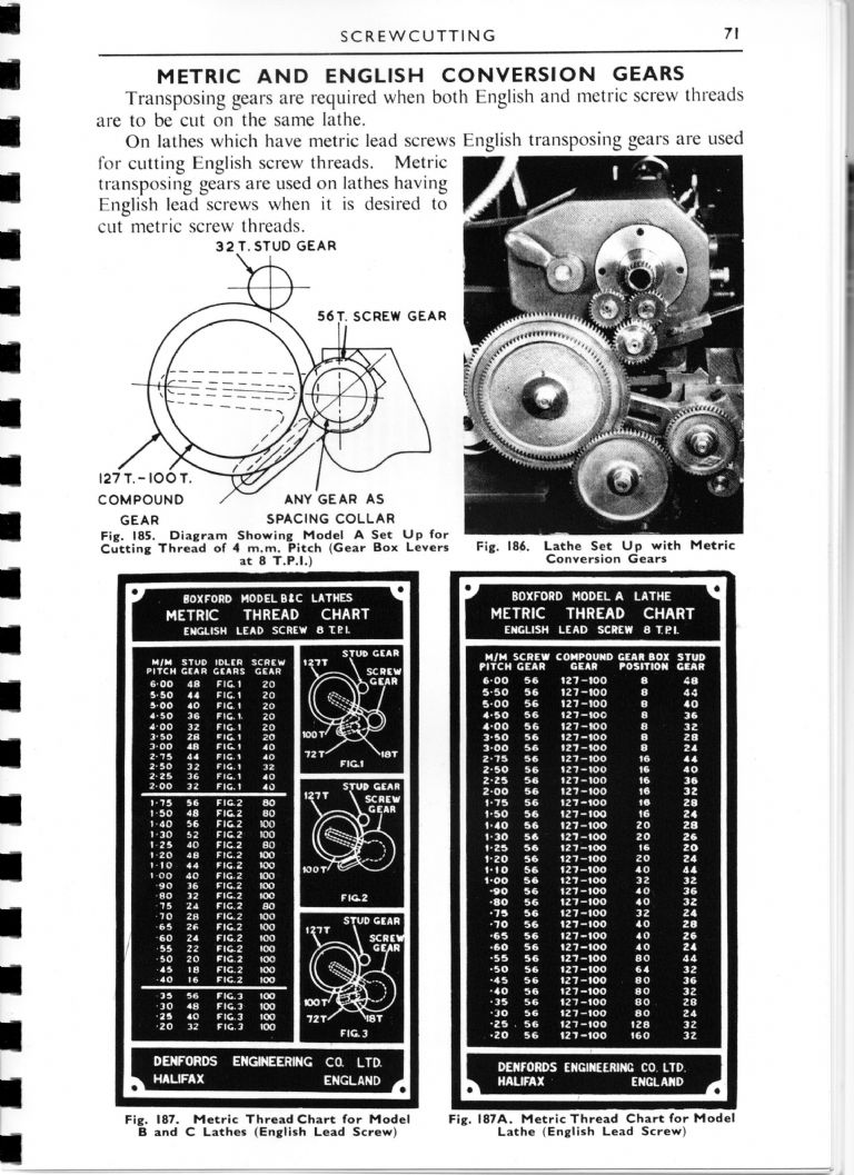

      I hope that someone may be able help.
      When I purchased the Metric conversion gears for my Boxford lathe, the set came with a metal plate showing the setup of the gear train for specific Metric thread pitches.
      Having recently moved to Portugal, along with the workshop of course, the plate seems to have hidden itself somewhere. Does anyone have one that they could scan or photograph for me.
      Regards Barry

        #118206
        John Stevenson 1
          @johnstevenson1
          Gearbox or none gearbox model ?
          This is the gearbox model.

          #118220
          Robbo
            @robbo
            boxford metric gears.jpgBarry,
            There is a pic in my photos titled Boxford metric gears which may help. Shown above. Charts for gearbox (model A) and non-gearbox (B, C etc).

            #118221
            Saxalby
              @saxalby
              Many thanks John and Phil for your help, wont have to do it the hard way and get the calulator out. Of course now I have the details my own plate will mysteriously re-appear.
