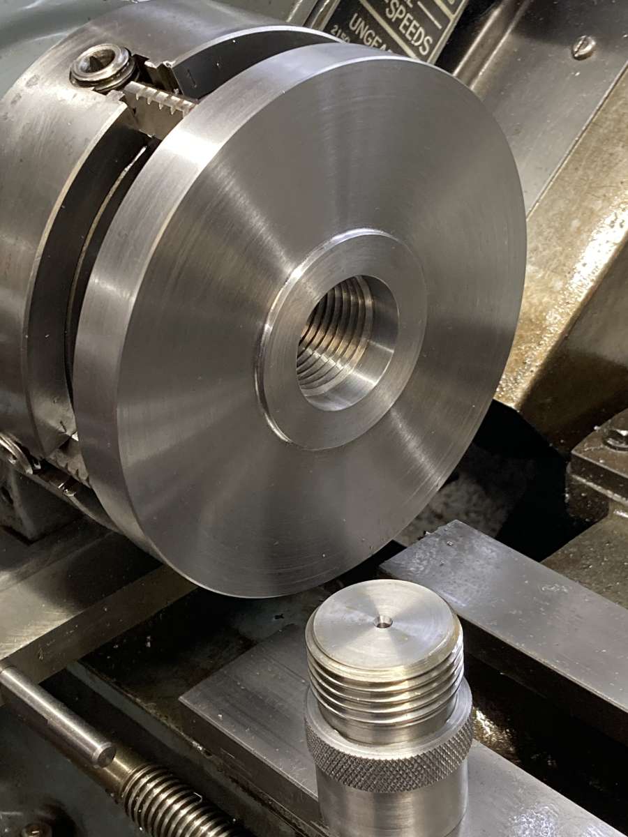

      Morning all, I wonder if anyone can help me. I bought a backplate suitable for my Boxford AUD from RDG a couple of years ago to fit a 3 jaw chuck my father in-law gave me. I’ve only just got around to fitting it and found that it will only spin onto my spindle a half a turn or so. It has 1 1/2” x 8tpi as per my spindle. I spoke to RDG and they said that some of these need to have a tap run through them to ease them up a bit. I don’t particularly want to buy a tap as I doubt I’ll be using it again and as for machining, my lathe is metric AND I don’t have a faceplate to mount it, which is something I definitely to need to buy. It’s probably a stupid question, but does anyone have any other suggestions given my lack of equipment.
      PS I’ve checked the thread for stuck chips etc.

          The thread should be on the loose side so that it locates on the register.  I bought one a few years ago to fit a new chuck to my Atlas lathe (same spindle nose as Boxford) and had to skim the thread. I set it up on the four jaw chuck to machine it. The thread doesn’t have to be very precisely aligned as it has to be loose.

            On Simon Ricketts Said:
            …does anyone have any other suggestions given my lack of equipment.
            What equipment do you have?
            Let us say you only have the backplate.
            Buy a soft Morse taper arbor that suits the spindle taper. Turn down a shoulder on it. Drill and tap it for a securing bolt.
            Cut a circle of plywood and drill a hole in it to suit the diameter of the shoulder of the arbor. Bolt wood and metal together using some large metal washers sandwiching the plywood.
            Mount in spindle and use a pen to draw a circle on it the same diameter as the backplate. Fix backplate to plywood concentric with the circle you have drawn. Woodscrews and plywood cleats will do for this.
            Set lathe to cut 3.175mm pitch, put screwcutting tool into toolpost and chase out thread.
            The likely point of failure of this setup is for the plywood to slip rotationally on the arbor so give it a good tug with your hand to see how secure the connection is and reinforce (glue, weld, pin) if necessary.

              Russell thank you, never even thought to use my 4 jaw as I follow the YouTuber Enotts Engineering and he did the same thing but used a faceplate.
              If there’s one thing I’m learning, there’s a lot to learn.
              DC thank you, the back plate mounts up ok in the 4 jaw so I should be able to move forward.
              Ok, so bear with me gents, as this will be the first time I’ve done internal thread cutting before. To be clear I’ve done some external threading cutting and internal boring so I’ll probably need to check a few things with you as I go.
              Am I right in saying I’ll need a 60 degree tool angle for this thread?
                …first time I’ve done internal thread cutting before…
                A Boxford owner will be along soon but I am under the impression that Boxfords used a Whitworth (55 degree) thread form. The US South Bend, to which the Boxford owed many design features had a 60 degree thread form.
                You are not really thread cutting, more thread chasing. Which means you need to pick up the existing thread. It is actually easier to pick up an internal thread than an outside thread.
                With the halfnuts engaged (and as you have a metric lathe, they will need to remain so throughout the process), leave the tool slightly loose in its holder and slide it forwards and backwards until it fits the thread groove. Then tighten the tool in its holder. Blue up the internal thread* and take a scratch pass as the first pass. Examine the blued up thread after this pass and you can verify that the tool is correctly aligned and adjust if not. For what you are doing, I would be turning the spindle by hand.

                  Yep, it should be 55 degree form (apart from the very earliest models, but anyone that has one of those would probably know).
                  I’ve always wondered, however, if the backplates being sold at most of the usual suppliers do actually have a 55 degree thread and not just “sixty degrees and it fits OK“. Nobody seems able to confirm this for sure, so I’ve held off buying one.

                    I understand that the Boxford thread is 55 deg. You face a problem with setting up to cut 8 tpi on your metric machine.
                    Boxford list 3.0mm and 3.5mm pitch as standard set-ups, neither are near enough for your need of 3.175mm. If you happen to have a Boxford 135-127T gear then you’re home and dry, otherwise you may get near by juggling the standard gears, but the gearbox complicates calculations.

                      60 degree does not ‘fit ok’ A Southbend backplate does not fit at Boxford and you can guess how I know.
                      Try fitting it backwards. It is many years ago so a completely different batch but I had a tight one and tried it backwards to see if it was a progressive taper and it went on a few times getting easlier. When I turned right way it fitted ok.
                      I think it was a combination of being minutely tapered and removing the burs and high spots. Try using blue (felt tip) to find what part is actually jamming and if crests or troughs that can be worked on first. It is unlikely that you need to try and recut rather ease it down manually with emery. You could make an internal boring tool of the correct angle and work it round by hand, not even in the lathe, to remove high spots.
                      PS make ABSOLUTELY CERTAIN that the backplate is colder than the nose when trying it or you will get a shrink fit. Once the thread fits you should find that the parallel register is too tight and again it is vital here not to get a shrink fit.

                            I hesitate to raise this, but when you screw it on and it jams up after half a turn, is the plain register on the backplate still clear of the register on the spindle?
                            If the two are already in contact at this point, could it be a tight register on the backplate rather than a problem with the threads?

                                Morning all, thanks for confirming thread angle and just to confirm the register is not in contact and screwed on backwards it turns about the same distance.

                                      Hi Simon, looks as though you are sorted but as DC3 says on more than one occasion I have discovered imported tooling for Myford to be cut to UNF thread form 60deg ! thus having the same problem as you are the tool will go on for a short distance then stick — the only way is to re-cut with either single point or a tap.  Also I find, for Myford, all the spindle tooling I have measured has an oversize register but as much as 0.004″.
                                      If you are keeping the lathe long term and are likely to make more tooling I would suggest you make a thread GO gauge and if you don’t have access to a suitable bore mic a register plug gauge.
                                      I recently made a special backplate for a Boxford owner and did the screw cutting on the Myford because it was easy at 8tpi
