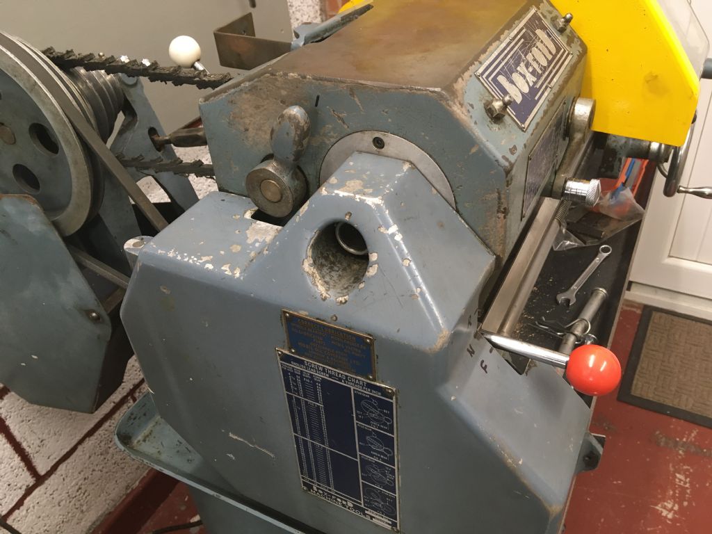

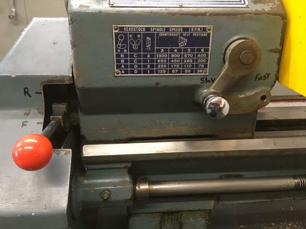

          Ok, so I’m happy to report that the issue here is me and not the lathe (easier fix). Now that I know where the correct position is with all the various levers all seems to be great so I can forget about a reversible motor to change the direction of the spindle as I don’t need that anyway now that I’m beginning to understand what I want to do with the lathe and how a lathe works.
          So what I wanted to do was actually make the leadscrew move forward and then backwards as required so that the saddle moves automatically.
          I have now identified the following options with all your help:
          • 2 speed lever (Fast or slow)
          • Auto Saddle selector lever
          • Saddle move forward, neutral, and reverse lever
          You guys have all been brilliant with advice and pictures. I can’t thank you all enough. Sorry if my questions are a little confused at times but I thank you for being understanding.
          image 1: showing my markings for the 2 speed lever (Fast or slow) and Saddle move Lever marked as R,N,F for Reverse, Neutral, and Forward.
          Image 2; showing the grey lever (Saddle selector lever) in the position to engage the Auto Saddle.feed

            No; the grey lever in the 2nd. pic. is nothing to do with the saddle feed. It's the lever to engage the back-gear, used in conjunction with your "fast/slow" lever in the 1st. pic.
            The saddle feed is engaged using the half-nut lever on the front of the saddle, which isn't pictured. This is used in conjunction with the red-knob lever.

                  The red lever can be called the "tumbler reverse lever." The other two levers on the head-stock can be jointly called the "back-gear levers".
                  The lever on the saddle is the" half nut lever". This engages a split nut with the lead-screw and thus drives the saddle along when the lead-screw is rotating under the control of the tumbler reverse.
                  Hope that's clear.

                            DO NOT move any of the levers on the headstock, (that's the big grey lump at the left hand end) while the lathe is running. After you change any lever check that everything is free to move by pulling by hand on the belt. Sometimes you have to do this to get the gear teeth to engage and to move the lever right across.
                            You will find that one combination of the grey lever (moved towards you) and the shiny knob on the front (positioned to the right) causes everything to lock up. Never use this combination for anything at all ever.
                            The red knob must not be moved when the lathe is running. It is not a stop lever for moving the saddle.
                            The lever on the front of the saddle is the one you are allowed to move up and down when the lathe is running. It is also the emergency stop for the saddle when it is moving automatically as it is instant while the motor may run on for a few seconds after turning off.

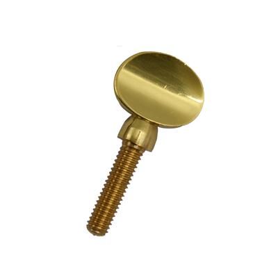

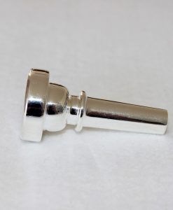

                                              As you know I’ve been learning about my lathe and with the help and guidance from you guys I’ve managed to do a few little projects plus I managed to go on a lathe turning course.
                                              I now want to try screw cutting but small bespoke sizes for example 0.7 which is a screw size for a Bugle I have which has no lead pipe tuning screw.
                                              I also want to try to turn a bugle mouthpiece and would like to know if anyone knows the best tools for these two projects and any tips to achieve them.
                                              Here are some pictures of the types of items I'm looking to create.

                                                Hi Steve. To turn your mouth piece it may help to grind some HSS bits to suit your profiles to turn. I.E to do the radius you could grind a blank with the radius you require. ETC ETC . Some one will be along shortly with a better description of making cutters for the type of work you are doing. From your posts it sounds like you are at last getting there. Regards .

                                                  The mouthpiece doesn't look too difficult. The radius could be made with a ground HSS form tool as suggested. Personally I'd favour a form tool from carbon steel which can be shaped by milling, drilling sawing and filing before being hardened. An good alternative for the radius could be hand-turning using a graver. For a one-off this has the advantage of simplicity.
                                                  For the screw, I can only suggest a silver-soldered assembly. The concavities in the finger plate will be difficult without very tedious hand filing, although fly-cutting  might just be possible, but requiring a tricky set-up. A flat piece of brass would do, apart from the aesthetics.

                                                    For the screw if you want make the thumb piece part of the screw, I would suggest that you machine the concave parts by "milling" or fly cutting whilst it is still part of the bar stock and before you turn down for the screw portion – if it doesn't go to plan, you could cut off the failure and try again without loosing too much material. You would have to support the bar stock onto the cross slide (Not sure if you have one with "T" slots) . Not such an easy thing to do if you don't have "T" slots. Not everyone wants to drill and tap some spare holes into the cross slide to hold work.
                                                    Also, when you screw cut, you may find it more rigid if you drill the end of the screw for a small centre.

                                                      WRT the mouthpiece, the tricky bits would be the internal shaping of the cup, the profile of the rim and the taper of the backbore, the external parts (apart from the taper of the shank) are mainly cosmetic.
