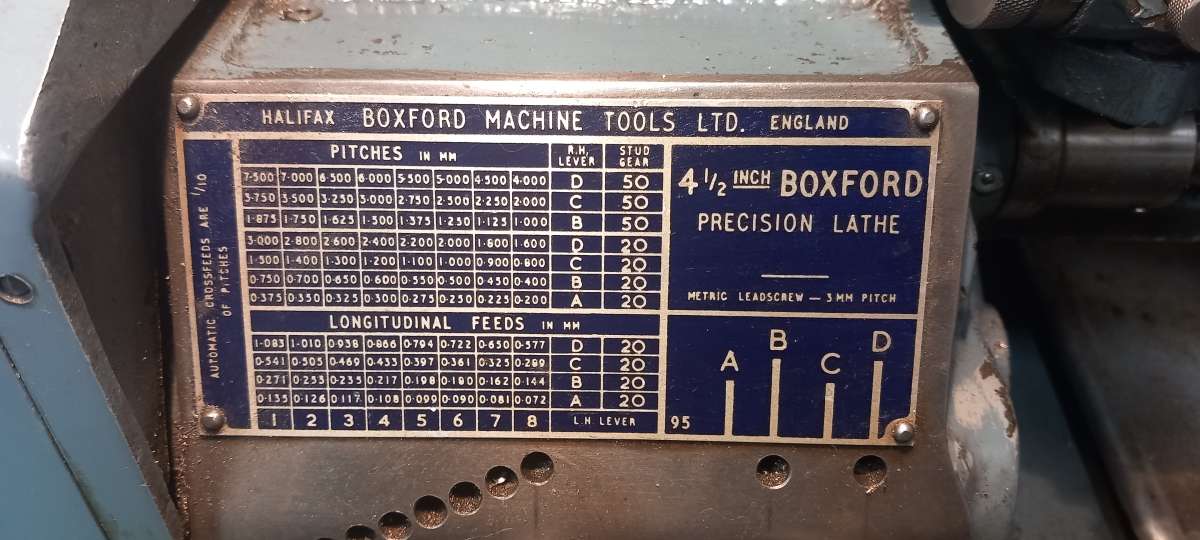

      Can anyone tell me please what the standard stud gear ( headstock spindle Driver ) Idler gear and Leadscrew gears should be for an early ( 41/2 inch) AUD underdrive fitted with a factory original equipment  5mm pitch metric leadscrew and gearbox.
      I do have the large double gear idler which I presume is to allow imperial threads to be cut with the metric leadscrew but its the original setup I am really interested in to get the correct pitches from the gearbox plate as currently they do not correspond.
      Hope this makes sense.
      Kind regards all .

          According to the Boxford book “Know Your Lathe” 1988 edition the standard set up for a metric machine with a gearbox is:-
          stud gear       20 teeth
          idler gear       80 teeth
          gearbox gear  45 teeth
          For coarse pitches replace the stud gear with the 50 teeth spare gear that is normally parked outside the gearbox gear.
          The 45 and 50 teeth gears are of very similar size so it would be easy to inadvertently interchange them on the gearbox drive shaft. Which will give incorrect pitches. A likely error on a used machine and hard to uncover if you don’t have the book.
          The book is not clear as to what constitutes a metric coarse pitch, presumably its on the gearbox data plate, but for English threads coarse is said to be from 4 to 7 tpi, so I guess a metric box coarse will be roughly 3 mm to 6 mm pitch. So a matter of little concern to the user who is unlikely to cut such coarse threads. Especially as they are mostly greater than the lead screw pitch and so widely considered unsafe to do on a small machine. Its often recommended that if such things have to be done the lathe be driven via handle on the lead screw end rather than by its motor. This practice is said to greatly reduce the stresses on the drive train.
          Clive

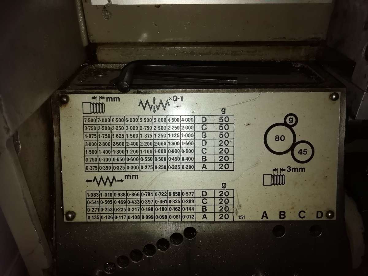

            Craig Brown
              @craigbrown60096
              IMG_20200108_082123
              Here is a picture of the chart off the gearbox of a later AUD but to my knowledge it was the same all the way through. These later charts were better, giving all the information required. Hope this helps

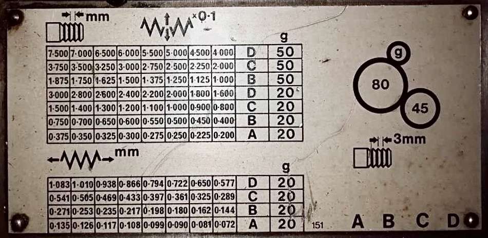

              #733757
                I hope you don’t mind, Craig
                … I’ve just spent a couple of minutes brightening-up that very useful chart
                IMG_9701

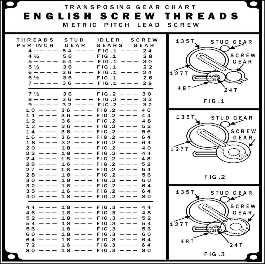

                                        #733969
                                        Pete Rimmer
                                          @peterimmer30576
                                          On Clive Brown 1 Said:
                                          PS. I’ve never grasped where the 135 count springs from, but my lathe’s imperial.
                                          127/135 in effect turns a 3mm pitch leadscrew into a 9TPI leadscrew. That’s why in the chart the 9tpi setting has 32T input and output gears and most of the pitches contain a gear that has a tooth count divisible by 9.

                                                Yes it doesn’t appear to be intuitive. Until you swap out the 45 gear on the gearbox for the supplied 40. 45/40 = 9/8 and now you have a virtual 8TPI leadscrew giving you a bunch of even-number pitches on the box. Somebody somewhere must have this conversion chart
                                                Did anyone notice that on the Metric gearbox if you start on any row on the right, the numbers go up in 1/8th increments as you move left?
