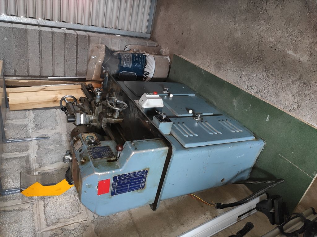

            I've attached a pic of one of the machines. The start/estop is quite modern, the fwd/rvs switch looks like it's original kit. Both can be seen clearly in the pic.
            Edit: No idea how the image upload tool works. Will post the pic when I've figured it out. thinking

              Moderator edit: rotated photos.
              Edited By SillyOldDuffer on 09/05/2022 22:09:50

                Not sure why the album rotated them, nor how I correct it. It seems a clunky tool (the photo album tool, not the lathe). Maybe it's just me? dont know​​​​​

                  The white box is a NVR starter you won't be able to use that but you most probably would be able to use the original drum switch to the left of it.
                  EDIT you could use the NVR as a power switch to supply the VFD but you wouldn't be able to use it as a start/stop and depending on what model VFD you get using the E-stop on the NVR might invoke motor braking or it might allow it to run down normally. Killing the power to a running VFD is not recommended.

                    Nice machine, but messy blockwork !!

                      Indeed! It was like that when I bought it! thinking

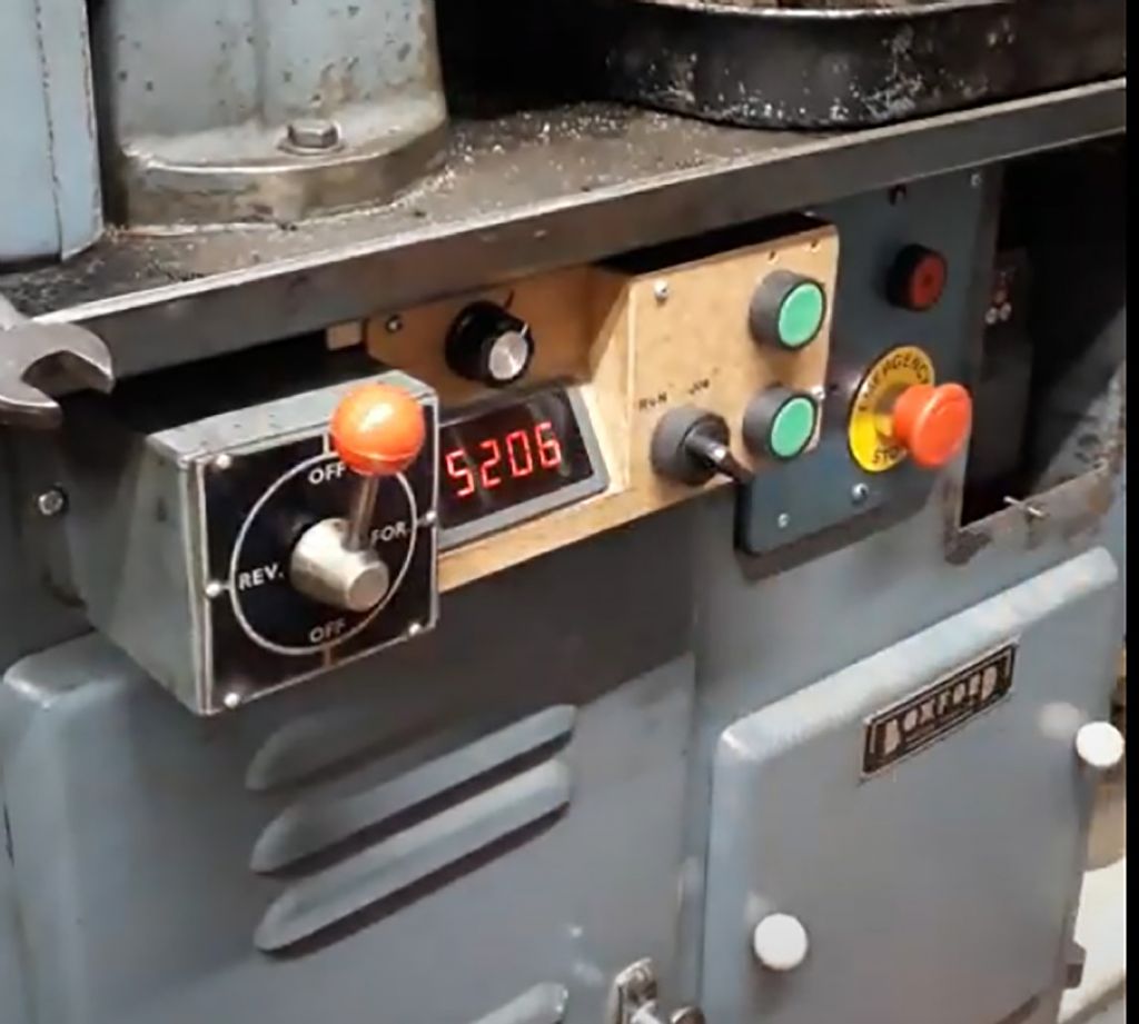

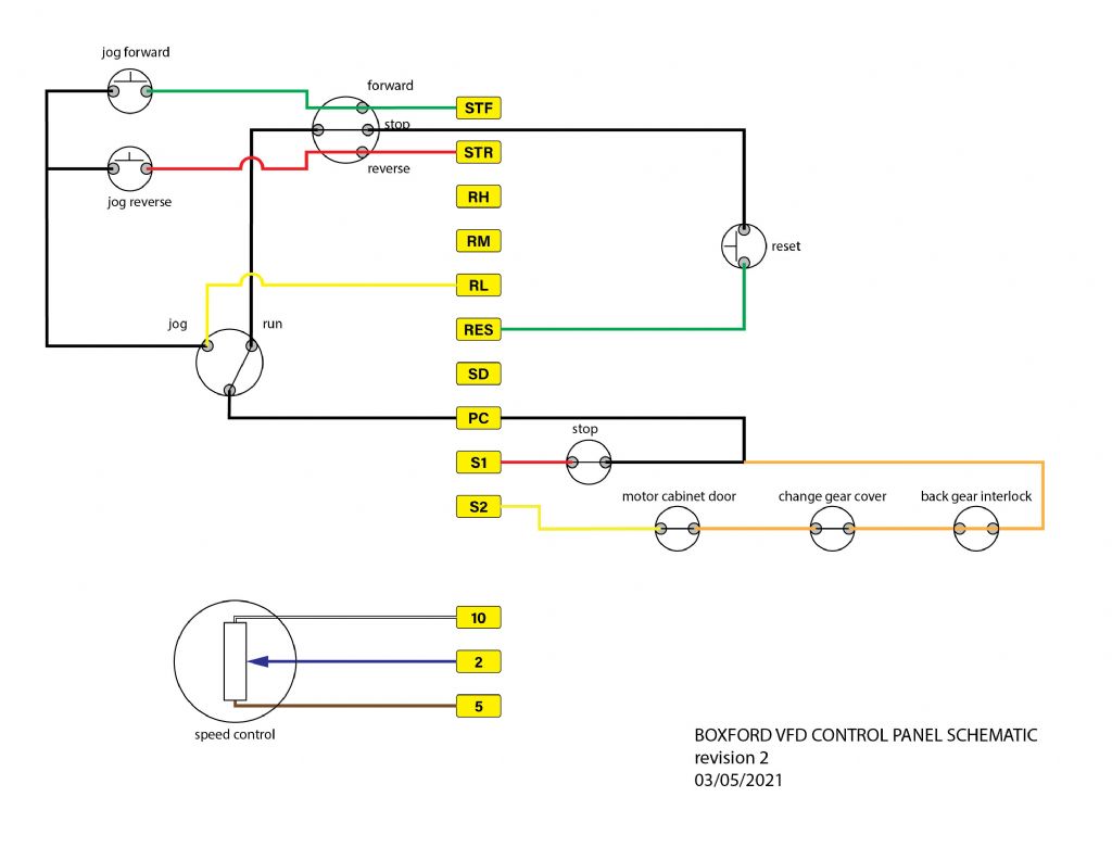

                                                  I've done my CUD with original motor and a Mitsubishi VFD. I was accustomed to the original stop start switch and much prefer it to buttons so I devised a wiring scheme to retain it. I had to dismantle it to rearrange the contacts and some were burned out but there were enough usable to do what I needed. Photo shows my prototype enclosure to be remade in steel when I get round to it, and you can just seen the VFD tucked into the cabinet. I have also attached my schematic wiring diagram. Please note, I am not an electrical engineer, this was devised with help from this forum and from the chap at Inverter Drive Supermarket who is a mine of information, so use at your own risk. It has been working without any problem for a year or so.
                                                  William.
                                                  Edited By William Chitham on 11/05/2022 12:55:03

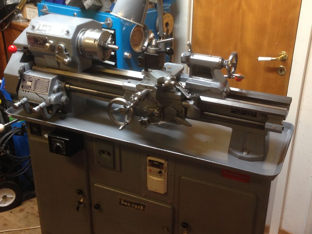

                                                    1963 Boxford
                                                    This is the minimalistic approach. Original switches with a potentiometer added on the side.
                                                    Edited By Yngvar F on 11/05/2022 17:41:51
