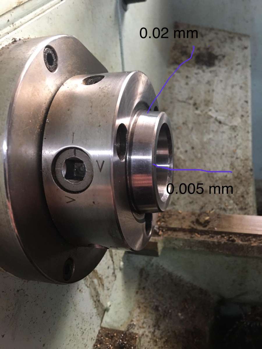

      Hi I’ve had this lathe for several years now and very happy with it,after a discussion with a friend I checked the run out on the lathe with the 3 jaw chuck on and off  it’s a D1-3 fitting.With the chuck off the front taper is 0.02 mm run out the face of that taper is 0.005mm run out, with the 3 jaw chuck on the run out is just slightly over 0.02 mm.Wondering how accurate it would have been from new and would other owners be concerned with this type of run out

        Typically it is usual to assume that the runout of a three jaw chuck is not too important. Trying to remove a machined part from a 3 jaw self centring chuck and then replace it in exactly the same position is often a futile experience. Also the chances of the jaws giving the same run out for different diameters is low. If you have obvious (as in visual) run out of a three jaw chuck then some remedial work may be required but mostly they are used as is. If you want to put a part machined workpiece back in a chuck then an independent 4 jaw chuck can be used to achieve near zero run out so this is the path most people follow.
        If you have a need to regularly hold lots of parts with low runout without needing to dial in a 4 jaw chuck then collets or soft jaws could be a good option. There are also times when turning between centres is a good technique to use but some people never need to do it.

          Hi Andy,
          I don’t have a Boxford 280 lathe but the run out on my old Compact 8 is less than the 0.02mm you get on the taper. A thread about the run out here. I assume you are already a member of the BoxfordLathe user group.

                I you haven’t noticed the runout over the years, than obviously it is not so important for you.
                It seems your chuck holder is mounted on the lathe spindle using bolts at the front. You could check if this mount has any play and use that play to decrease the spindle runout. As mentioned before, check your bearings first!
                I have turned the register on the backplates of my chucks a bit larger so I can use the play to reduce the runout.
                The runout of my (Chinese) 180 mm Sanou chuck was less than 0.01 mm when new (absolutely top). After 3 years of hobby (ab)use, it is now 0.025 mm worse case (not bad for a 3 jaw lathe chuck).

                  Only the two Camlock interface surfaces need to run true, being the taper and the adjacent flat face with the holes for the cam pegs. I would expect these to be better than 0.01mm TIR. Certainly on my Colchester Bantam they are better than that, but most of the other the faces have slight visible eccentricity.

                        Andy, its not completely clear what the two measurements you have shown in the picture actually are.
                        I assume the 0.02 is radial run out on the taper spigot but the other number (0.005mm) looks to be axial run out on the end face of the spindle which has nothing to do with the chuck mounting, The end face will be in fresh air when the chuck is mounted.
                        The important face is the large diameter one. Have you checked the axial run out of that?

                              I’ve just checked my Boxford 280. The radial runout on the internal MT bore is 0.02mm TIR but the outside tapered register is only 0.005 – the needle barely moves. Curious; you’d think they would be more or less the same.
                              I replaced the headstock spindle bearings with standard Timken bearings, which were not to the same high specification as the originals, which appeared to me to be a bit worn. £200 or so… about five years ago. I kept looking for some Gamet ones at the time (It was an option from Boxford), but even if I could have sourced them, they would probably have been ten times that price (if the price of similar-sized ones were any guide.)

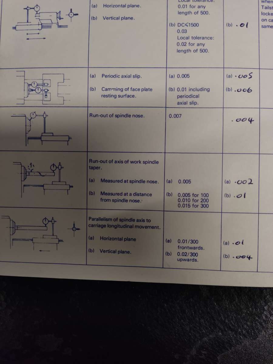

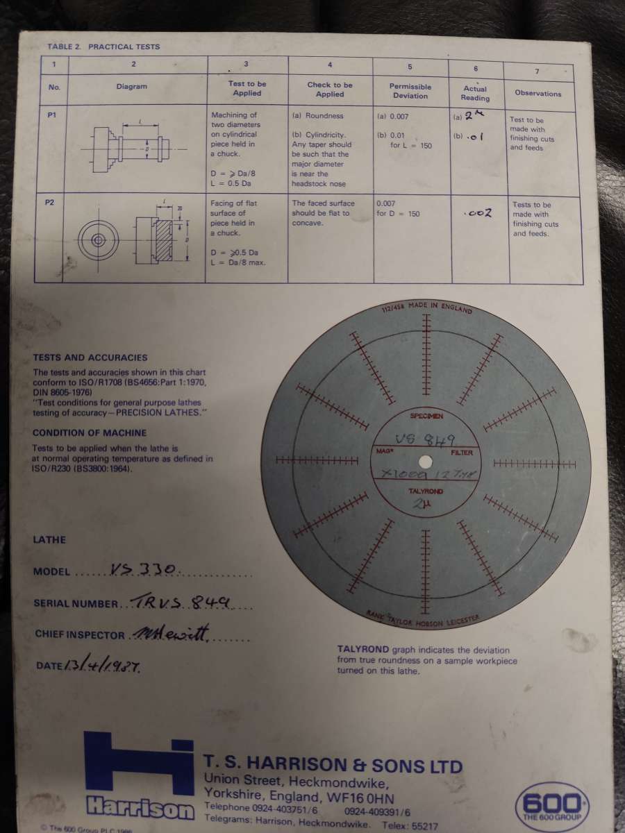

                                At work we have a Harrison VS330, bought s/h and unusually it came with it’s original documentation pack, including the test certificate. I was in work today & took a couple of pictures or the test certificate, the spindle bit is below :
                                IMG_20231121_121754
                                The values are metric. Also included was  Talyrond readout of a test piece machined on the lathe & details of the standard the machine was built to :
                                IMG_20231121_121705
                                The VS330TR is not much bigger than a Boxford 280, so the values should be a reasonable guide. The two machines amy well have been designed by the same chap – the Boxford designer came from Harrisons & I recall it being stated at the time that he had designed the M300.
