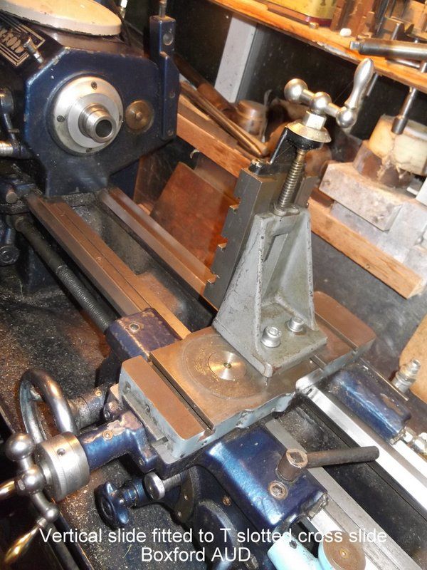

                                i have had the lathe for about 10 years and have long wanted to try milling on it. I kept a look out on ebay and managed to get a Boxford lathe with the T slotted cross slide, so did a swop, tidied up the "new" lathe and sold it at a profit!
                                #139746
                                SteveI
                                  @stevei
                                  John,
                                  Any chance for a picture of that set-up?

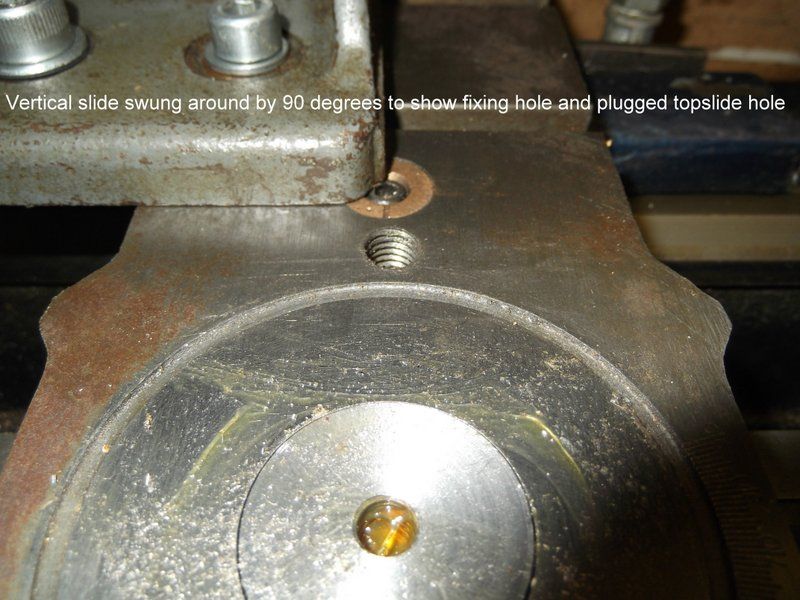

                                    John Hewes
                                      @johnhewes50816
                                      1-009.jpgSteve, here are a couple of pics.
                                      The fixing holes on the vert. slide did not match the T slots, so I have drilled and tapped the slide to fix one of the vert slide holes.

                                        All,
                                        My apologies to all. I have mistaken this thread to be about the later type Boxford lathes. e.g. the IS11.30, TR11.30, 280 etc. It was not. The pictures clarified that immediately. So pretty much everything I wrote was not applicable. Sorry.
