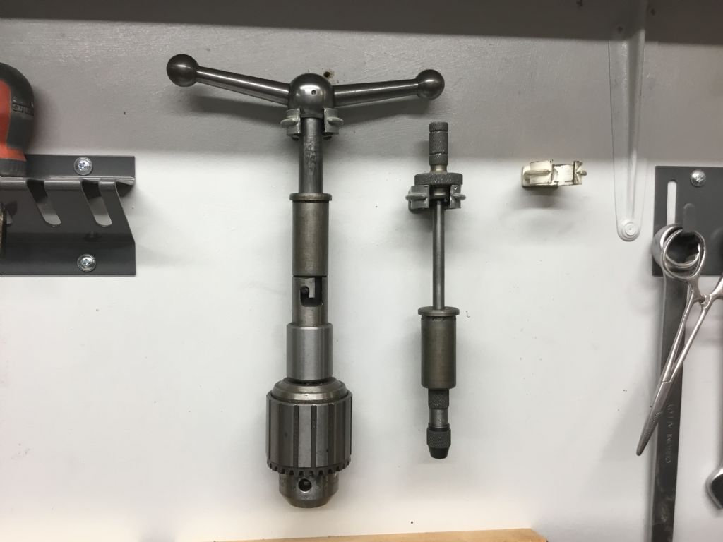

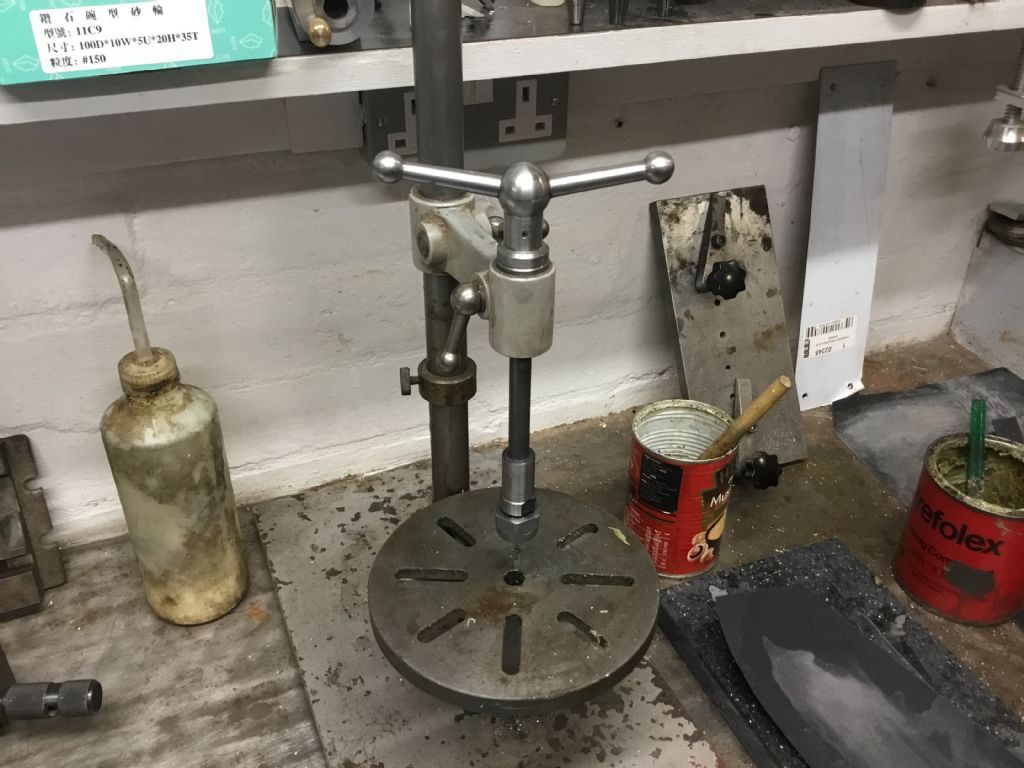

                                              Peter Spink
                                                @peterspink21088
                                                Bore it!
                                                Turn up a go-no gauge as in the book and you'll be fine.
                                                Made mine probably twenty+ years ago an it's one of the most used tools in the workshop, mainly for tapping.
                                                The original GHT handle was not at all user friendly so I made up my own.
                                                Forget the sensitive drilling attachment as more modern alternatives available now.
                                                UPT
                                                UPT
                                                For tiny taps the original Eclipse chuck works well.
                                                For bigger taps, an ER11 collet chuck which can pass through the arm with the nut removed.
                                                For even bigger taps a Jacobs chuck with a bayonet to disconnect the handle so it will pass through the arm.
                                                #470292
                                                Stuart Bridger
                                                  @stuartbridger82290
                                                  Nice work Peter, tapping is the main objective of my build. The ER11 route looks an interesting option.
