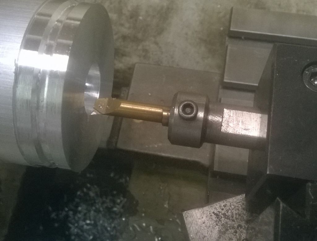

                              John Hinkley
                                @johnhinkley26699
                                Vic,
                                As it happens, I needed to bore a recess for a bearing today and so I used the Sandvik boring tool that I referred to above. The recess started as a through hole of 6mm diameter, but could have been smaller, if necessary. Here it's in use in the lathe, but would have been equally at home in the boring head in the mill as well.
                                Sandvik boring tool

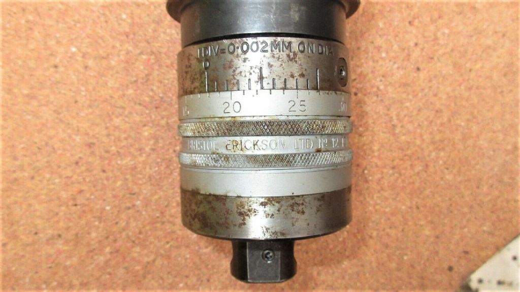

                                              Emgee
                                                @emgee
                                                Like John I also use an Erikson Tenthset boring head, adjustment is .002mm on diameter per division, allows very accurate boring to size. This is a No.12 and uses 12mm diameter tooling shanks
                                                Emgee.
