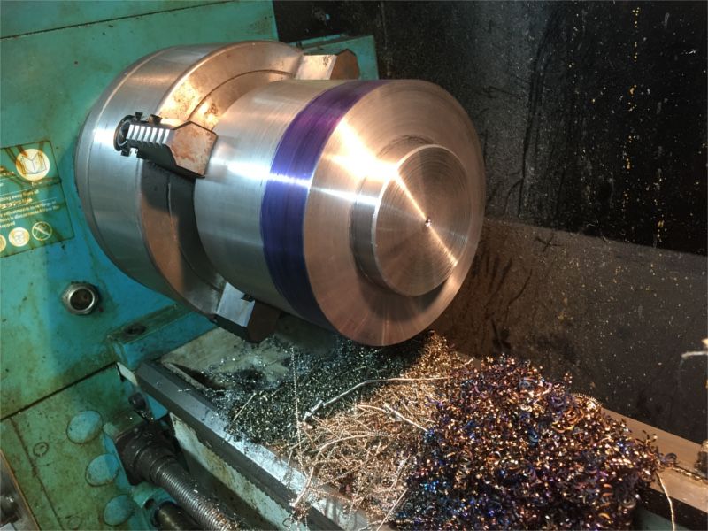

      I want to bore a hole 18mm deep and about 84mm diameter in the end of of a 150mm diameter 100mm long EN1A round bar. The work was set in the 4-jaw:
      and I started out by drilling to accept the 12mm boring tool.
      Then I started boring with a 0,4mm tip CCMT insert at 200rpm with 0,2 mm/rev feed, and an 0,5mm DOC. All went smoothly until I got to about 40mm diameter, when horrible chattering set in.
      My first thought was that it was to do with increasing surface speed as I opened the bore, so I reduced the rpm, but that didn't help.
      I'm struggling to understand why there should be such a dramatic change in behaviour over such a small interval. Maybe some sort of resonance?
      Robin.

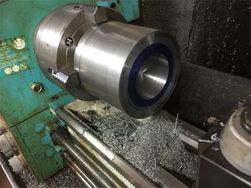

                                            Just to let you know how it went…
                                            Despite my worries about the lathe not being rigid enough, after some experimentation with speeds, cuts and feeds I found some sweet (and more sour!) spots. Because I was experimenting using manual feed I can't give numbers, but the general rule seemed to be (counterintuitively) that when the machine starts to complain, increase the feed.
                                            Anyhow, I got there:
                                            and made some blue chips in the process. By the time I'd finished the work was at 65 degrees C!
                                            Thanks again for advice, Robin.
