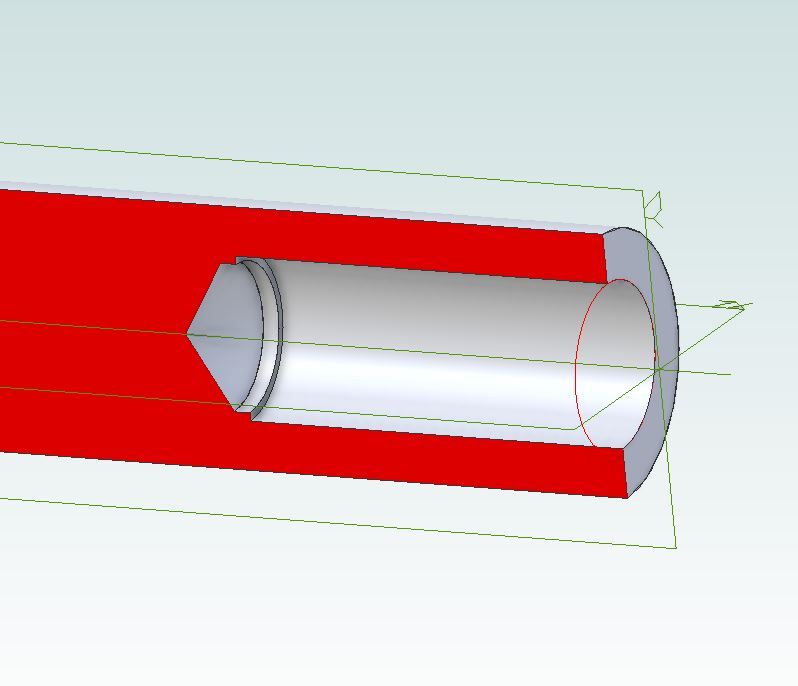

                                                    Chris, the whole reason for you boring the hole is so that it is a good fit on your motor shaft, you can't do that with a reground 10mm drill or a 10mm D bit.
                                                    No need for your blind hole to need end facing, you can stop the boring bar just short of where the 9mmdrilled hole goes to which will avoid the beginners luck of running the tool into the end of the hole.

                                                      Posted by JasonB on 13/11/2019 18:17:12:
                                                      Thanks Jason,
                                                      Yes I get that, I was looking into how to face for academic purposes for my notes. I also found out that using inserts / insert holders should be done with some understanding such as triangular verses other shapes lend themselves to certain types of hole machining. For most mild steel and brass I hope I can make my own HSS boring cutters.
                                                      What has not been covered is exactly what does happen if the boring bar touches the hole bottom. Does it naff up the tool or bottom or both, or just make the hole longer?
