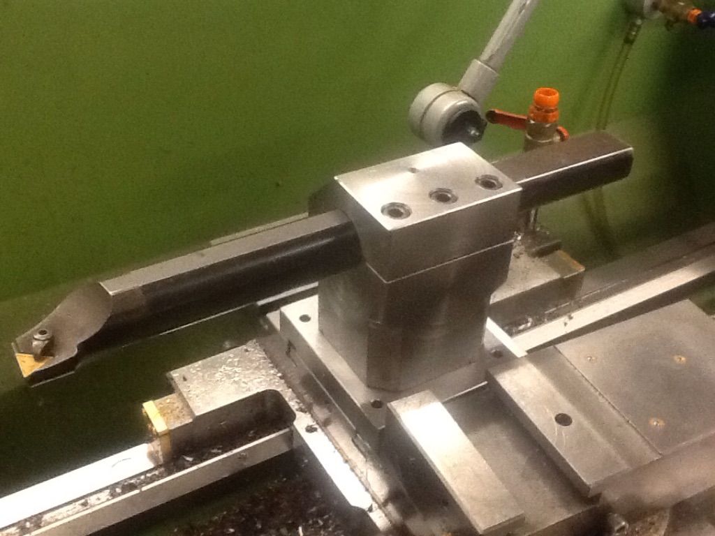

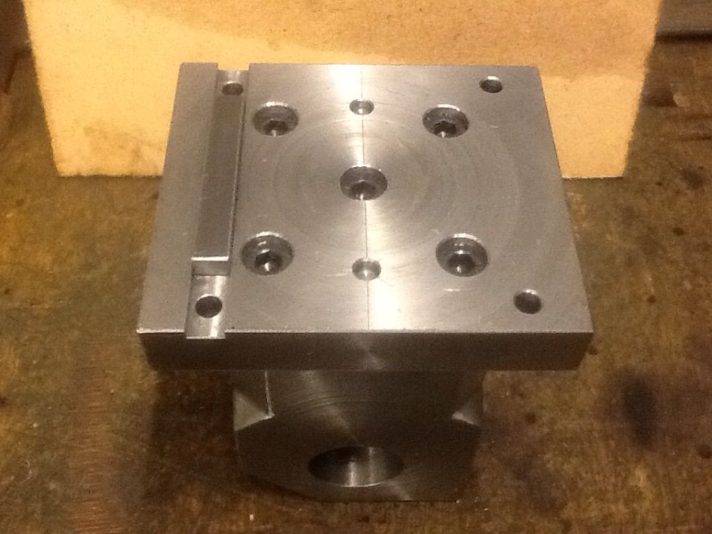

      For quite some time I have been meaning to make a toolpost to take a large boring bar, to be used in place of the topslide and its toolpost for a far more ridgid setup.
      I finally completed one during the past couple of weeks, starting with a block of 80mm square black bar for the body, and some 15mm thick steel plate for the base. The body and the base were both machined on all faces then dowelled and bolted together. The hefty lump was then bolted to the lathes tee slotted crosslide and the bore for the boring bar was first drilled and then finished with a between centres boring bar gripped in the lathe chuck.
      ……………The base is secured to the body with five high tensile M8 cap screws, plus two dowels. A key is also fitted to locate in the tee slotted crosslide. The lathe is a Warco 1330 but the topslide is a Myford 280 item that I modified to fit several years ago.
      image.jpg……………The completed toolpost after slitting one side and fitting three pinch bolts to clamp the boring bar. I was originally going to use a slitting saw in the mill but in the end I used my 7×12 bandsaw. The boring bar will be used to bore the cylinder on my BSA B50.image.jpg……….image.jpgimage.jpg

          Were you aware that the recommended diameter to length ratio of a steel boring bar is 4:1, solid carbide is 6:1, the most expensive bars can go to 10:1, and they cost somewhere in four figures. That cylinder really needs a 3" diameter bar, and a much bigger lathe.
          #435755
          Lathejack
            @lathejack
            Well there lies a possible snag, I had it in my head that the ratio was 5:1 so this boring bar would be right on that limit.
            I had been looking for a bar of 40-50mm diameter, but all the used ones I have looked at so far have been worn away in the area below the cutting tip.
            While the bigger the better for this job is true, it doesn't require going as far as a 3" bar. The 1330 lathe is heavily built and more than up to the job of holding and machining the light alloy cylinders bore out by 0.5mm, once I have made a suitable holding fixture.

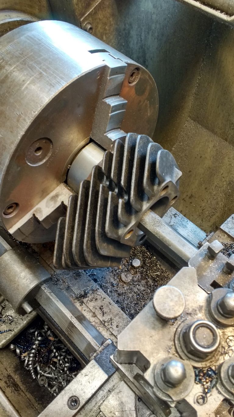

                    Holding the cylinder in a fixture mounted on the headstock spindle will ensure that it is bored accurately on the centre line, and also bored square to the cylinder base mating face.
                    I have come across several cylinder barrells that have been bored off the original centre line, even though they were machined by firms using equipment made for the purpose.

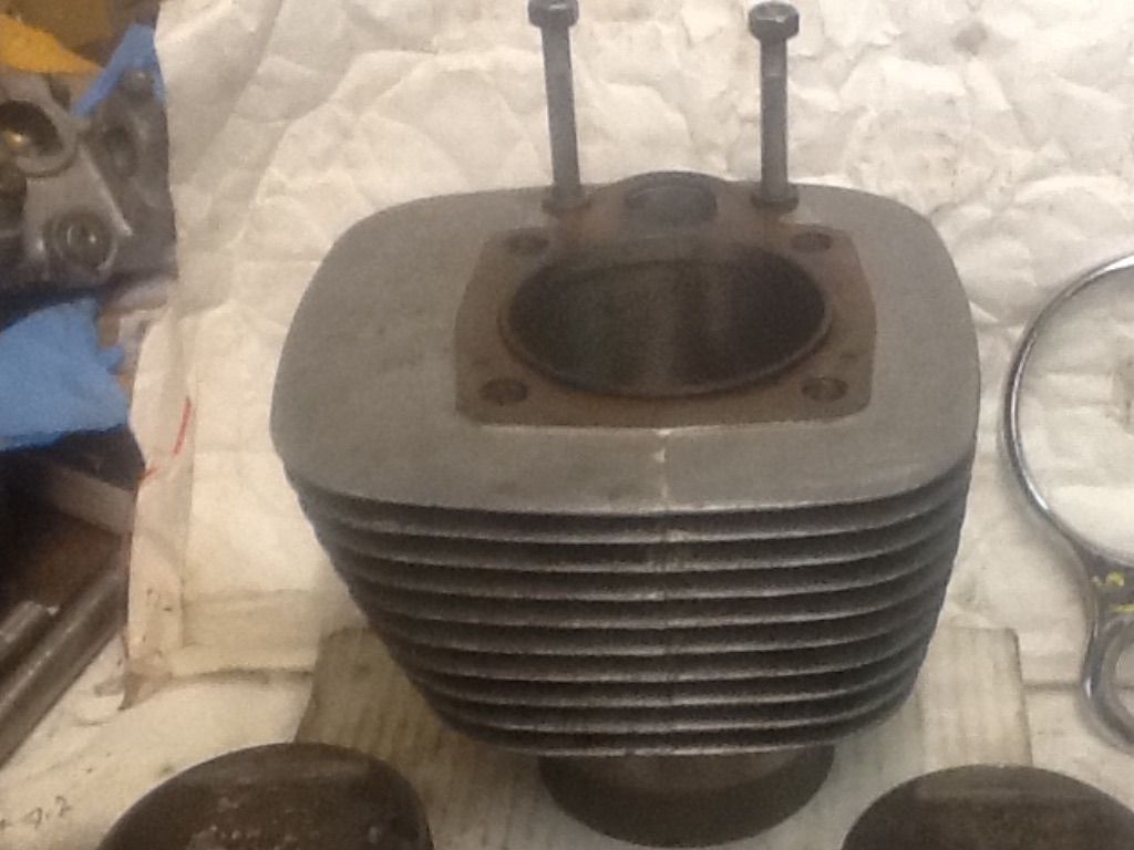

                          The boring bar I have is 32mm. The bored out cylinders I've had in the past were upto 20 thou off centre, so not ideal. I'm certainly not risking my precious BSA cylinders being done the same way.
                          i have also bored out motorcyle cylinders on the lathe before, including two stroke cylinders with all their ports. The lathe does a perfectly good job whatever the bore being machined is for, as long as the tool is ridgid enough and the lathe cuts parallel.

                                          The cylinder Barrell is light Alluminium Alloy, but it is fitted with a cast Iron liner that is to be bored out by 0.5mm. In any case the cutting tip is simply what was fitted when I bought it.
