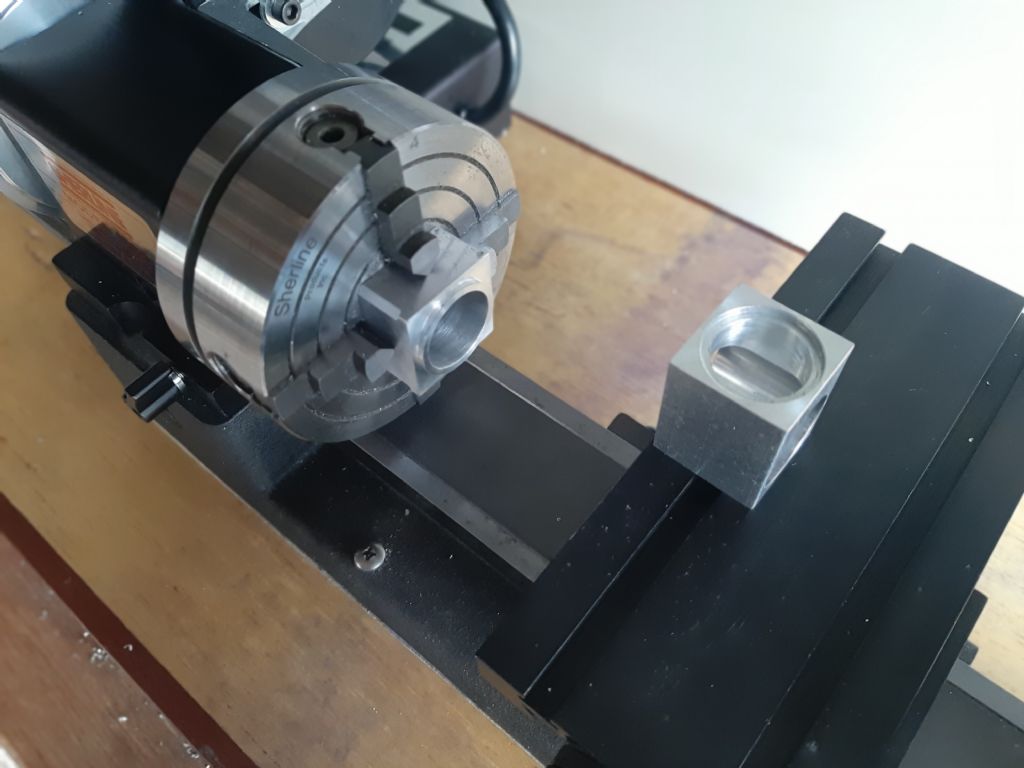

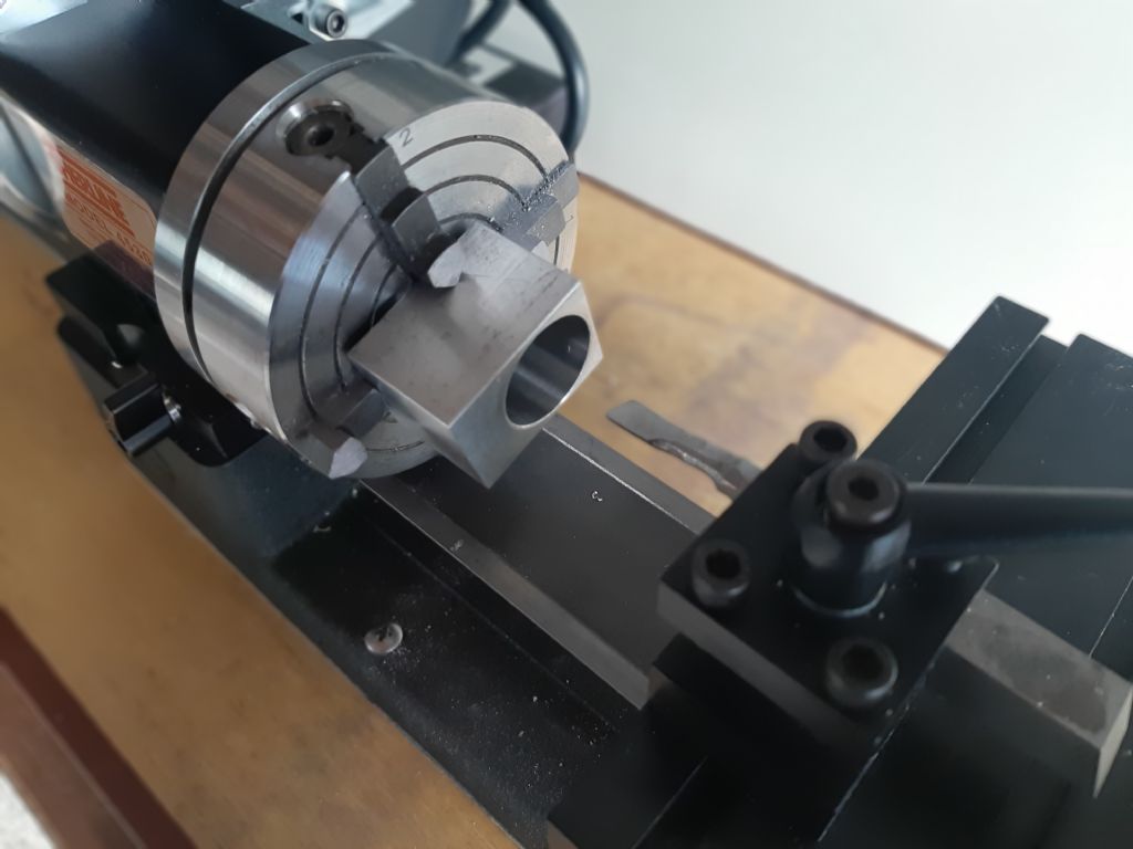

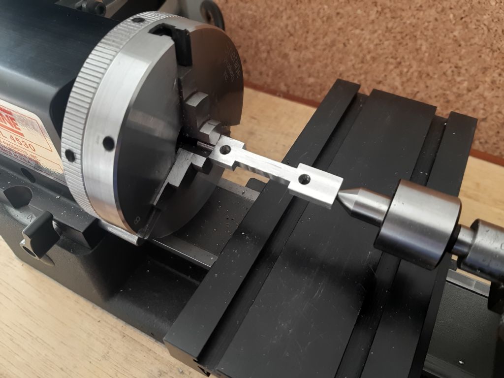

                  Hi All
                  Well I'm making a start on this engine, so more questions to come.

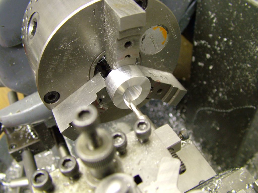

                  I' intend to do all the machining on the sherline lathe which is fine for most of the parts.
                  I decided to bore out the crankcase using the four jaw chuck. The length of the case was I thought a problem as supporting the work would be difficult. I therefore decided to to split the case into a lower and upper half to make the machining more manageable. The lower half has a recess to accept a register ring on the upper half.
                  I'll need longer head bolts as the threaded anchor points will be in the lower half of the case with clearance holes in the upper half. The register is a very snug fit but I still plan to silicone seal the joint on assembly.
                  More post in due course hope this is of interest

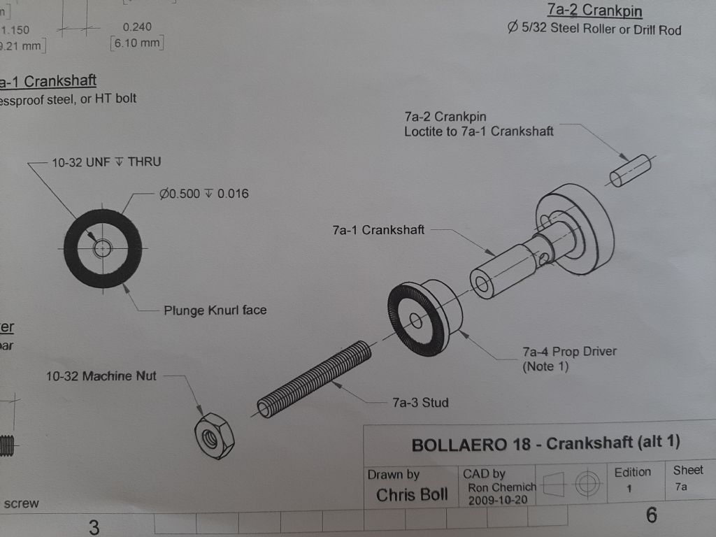

                      Ron's drawings show three options for the crankshaft. This is one of them which I believe is Chris Boll's original design.
                      I like this one and will probably use it.
                      Ron points out that using this design "may" result in a "thrown prop". What is a thrown prop?
                      With particular reference to this engine has anyone any ideas how this design may result in a thrown prop.
                      I'm just curious, the design seems sound to me but perhaps I'm missing something?

                        A 'thrown prop' is when the prop becomes loose – usually when flicking to start it. The engine comes up on compression and the force loosens the prop nut. For the most part it's just a matter of retightening it but if it occurs a lot it's best to redesign the prop driver to something more practical. Some commercial engine shafts have straight knurling with the prop diver forced on, others a slotted drive but the easiest to make and sound in design is the tapered brass collet in a taper bored prop driver – the taper needs to be an exact match though for optimum drive.
                        It is said that throwing a prop can lead to the engine having a shaft run – ie the prop coming off and the engine continuing to run totally unloaded but having hand started engines for so many years and throwing props on many occasions I've yet to experience that happening. Indeed in 65 years of playing with diesels I've yet to meet anyone who has!

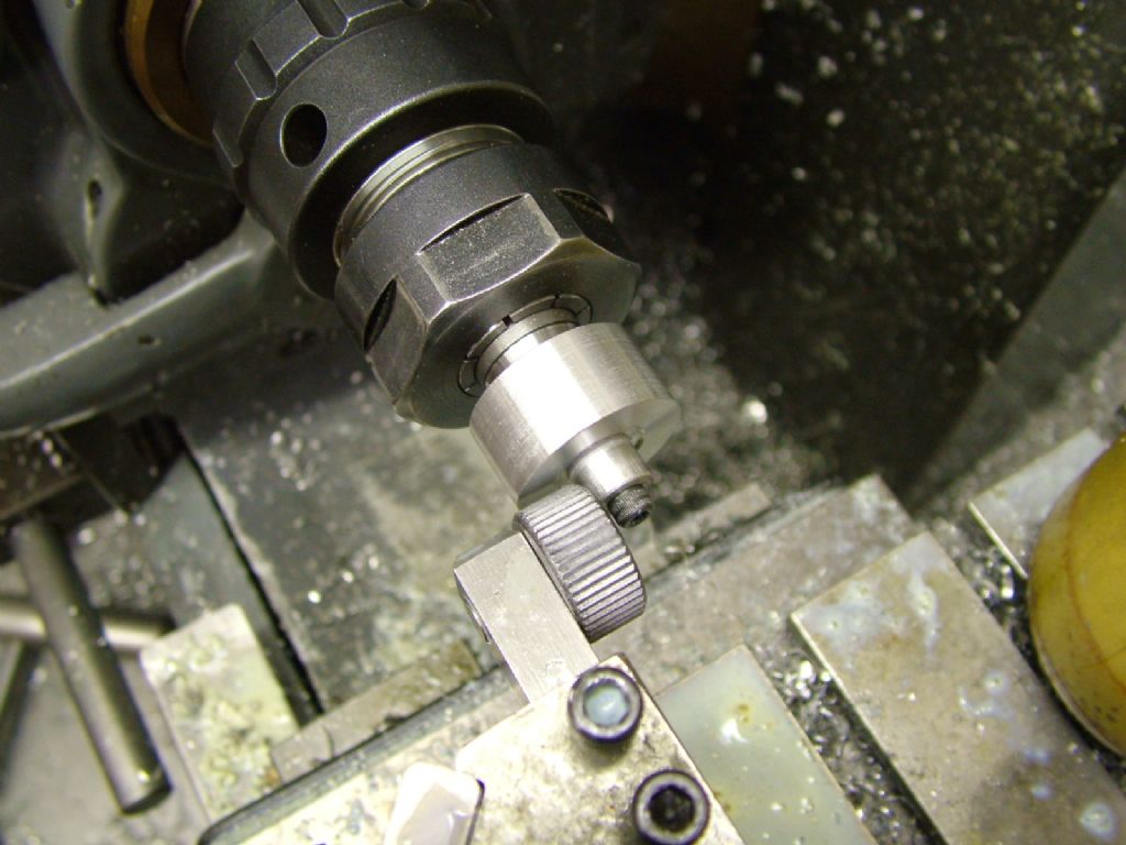

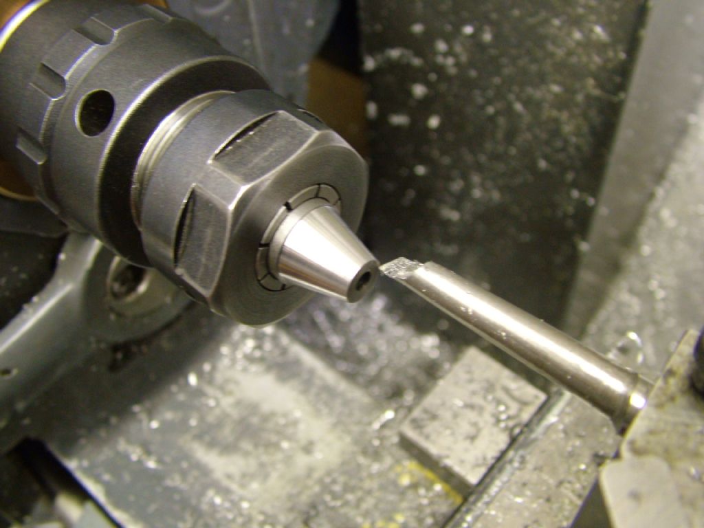

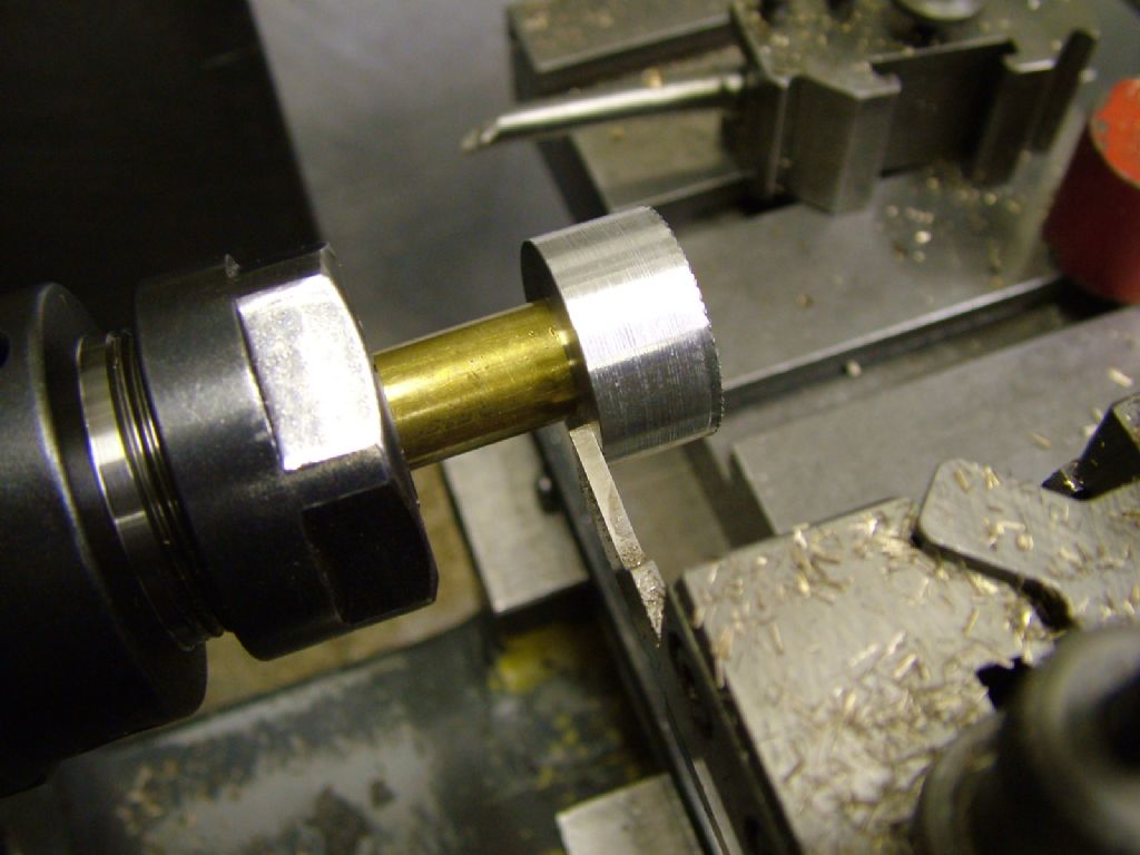

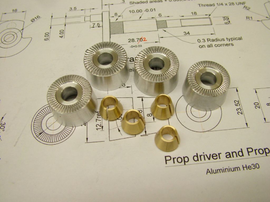

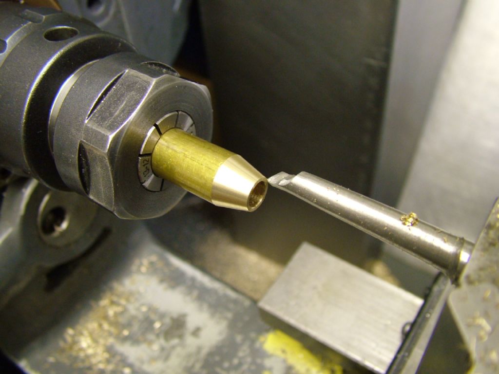

                          Geoff – here are six pics from my ETA build described on MEM (I think)
                          Boring the prop driver blank with the topslide set at the required angle
                          Reverse turning a taper mandrel with the topslide unmoved
                          Holding the blanks on the mandrel to knurl the front face
                          Revers turning the brass collet
                          Finished items. The collet must bear against a shoulder on the crank shaft to resist the tightening forces. The step cut in the rear face of the collet is to enable a small lever to prise it off. No step – very difficult!
                          Hope that helps
                          Tug

                            I can see how a collet driver will be locked very tight on the shaft.
                            If the driver is not REALLY secure on the shaft then it may shift marginally and loosen the nut. Does that make sense?
                            In the design above the driver is screwed onto the shaft and then presumably it locks in place when it butts up against the end of the shaft, but perhaps not secure enough to prevent it coming free and loosening the nut.
                            After your comments I'll look at the collet option in Ron's drawing

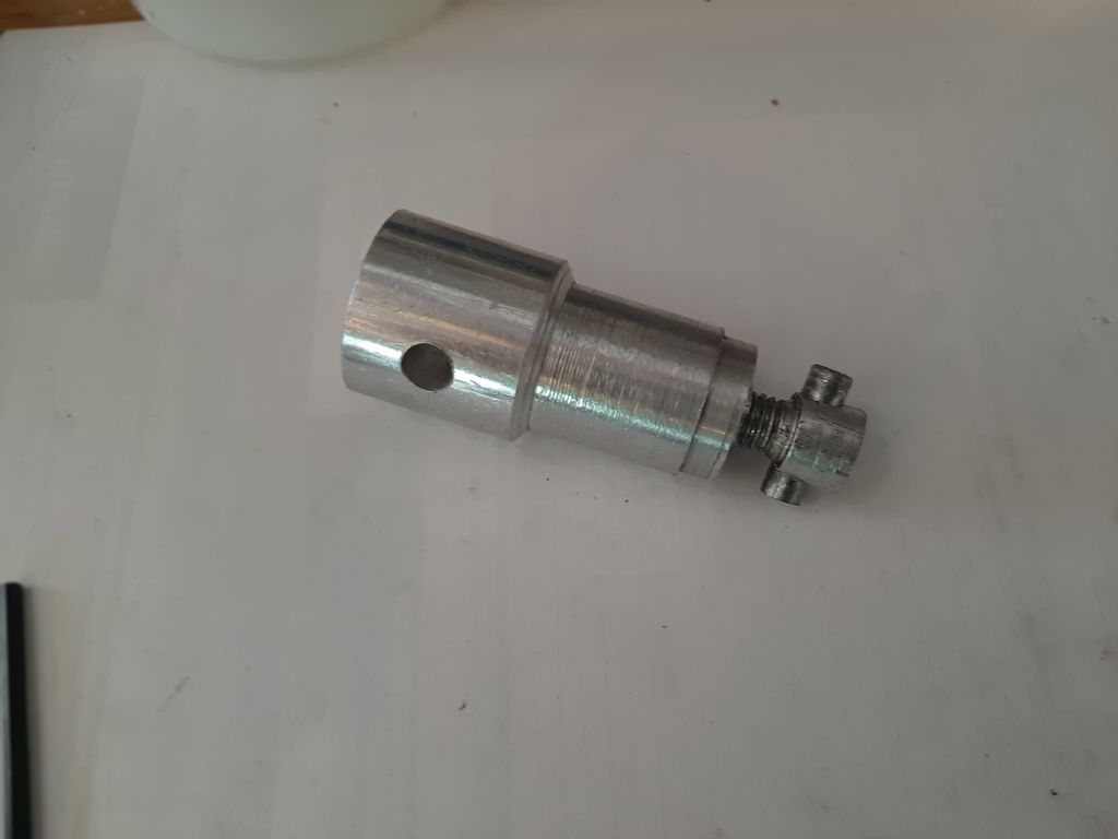

                                Well; Tug I can make your day! A few years ago, when I was test running the Sparey 5cc Diesel, I had just such an accurance. Engine back fired on start up, Prop spun off, but engine continued to run without the prop,but clockwise. I stopped it by shutting the needlle valve. I had not heard of such a possibility and like you have no knowledge of anyone else having it happen.
                                The Boll-Aero 1.8 drawings have no problems. I made the crankshaft to accept the collet /driver/
                                Keith

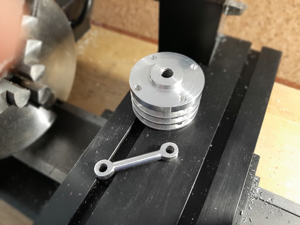

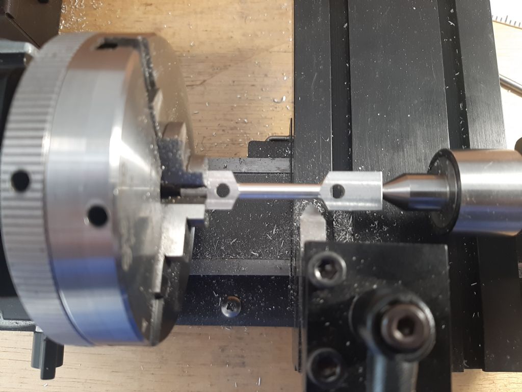

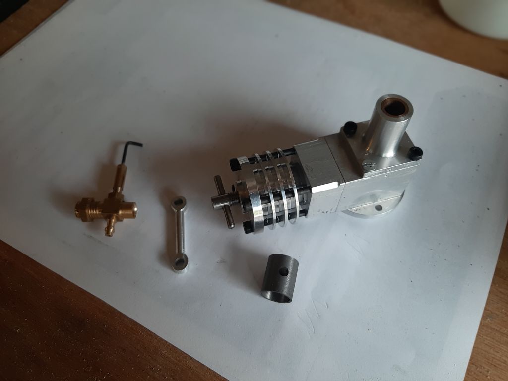

                                    Some more progress today.
                                    After some initial milling, shaping and drilling, set up the con rod on the Sherline.
                                    Perfect for the smaller items.
                                    Last photo shows it alongside the head, finished after some nibbling on the mill and some judicious filing.
                                    Geoff

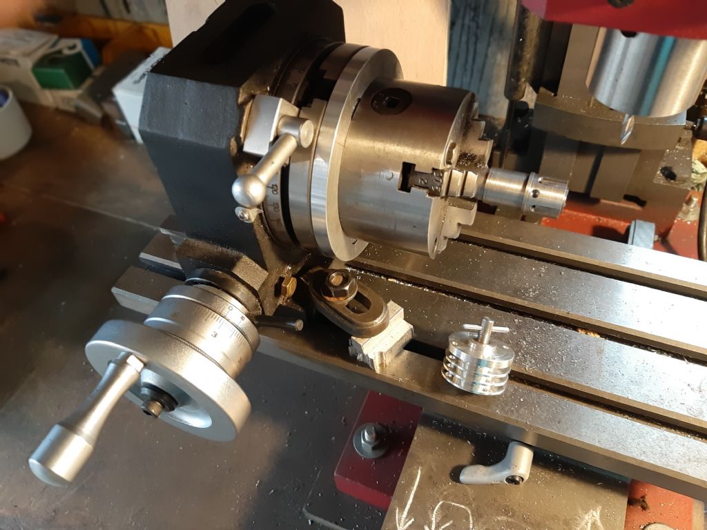

                                          I bought this rotary table about 4 years ago. I had to tweak it a little before the first use but since then it's had lots of use and I've been really pleased with it. I added a circular alloy table to make it easier to mount chucks and other attachments. The chuck in the picture is an Indian Zither, bought from ARC, again about 4 years. 4 jaw self centring, very accurate and for the price I paid good value.
                                          Both seen here in use milling the transfer channels and drilling the port holes in the Boll Aero cylinder. The cylinder is made from EN1A mild steel.
                                          Progress has been ok, here is another picture of some completed parts.
                                          The cylinder head screw for adjusting the contra piston is made to the sizes in Ron's drawings. I have seen some engines like this one which have a locking lever on the head presumably to secure the position of the screw and the optimum compression position for the contra piston. My feeling is that the lever is a good addition as when the engine is running (if the engine runs!!!!) there may be a possibility that the screw may vibrate loose and lose the setting? Any thoughts.
                                          Geoff

                                                      Regarding the crankshaft of the BollAero 1.8cc, my original had the prop driver screwed onto the shaft, this was the same as the ML Midge which inspired my engine design.
                                                      The small Sparey diesel also used this method. Ron Chernich drew the other alternative versions.
                                                      My aim was simplicity above all, the engine was originally published in Aviation Modeller magazine, which was not read by experienced model engineers, in general.
                                                      Ron also swapped sides of the exhaust and intake from my original, I prefer my original way for upright installation in a plane.
