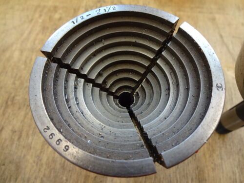

                          The lathe in question is German, a Pittler C3, the Crawfords are imperial sizes but the Boleys are metric.
                          I also got included five of these large Crawford step collets but no closer to fit my lathe mandrel. The closer I got with it was pointed out by the seller as not correct for the lathe but was probably for a Hardinge lathes-l500.jpg lathe thread
