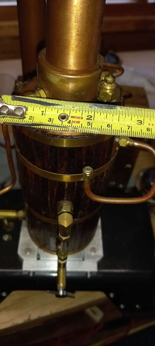

      Hello all. I’ve made several copper boilers in the past and checking the safety valves on them that they blow at the pressure needed. Experimenting with the springs I want them to go at 80 lb and 100 lb as that is the max on the gauges. The 100 lb the valve is almost there with a slight tug with pliers. My question is what pressure would explode a 1.2mm copper boiler with stays approximately 9 inches long 4inch dia silver soldered if the safety valve was faulty. I could pump up my racing cycle tyres in the day at over a hundred lbs ,so I’m just curious about the boiler, when steam is released at 100 lb, to me looks frightening.
      Thanks Bob

                  According to Aussy code, a boiler shell from 1.2mm copper at 100 psi has a max diameter of 3.5″
                  I’d be more concerned with the end plates. If these are also 1.2mm thick the required stay pitch comes out at 0.41″, which is unlikely.
                  The Aussy code agrees well with UK standards.

                    Without seeing details of the boiler I would guess that the boiler would not be approved under the Australian Miniature Boiler Safety Committee (AMBSC) Code Part 1 for copper boilers.
                    For a start, the barrel thickness should be 1.6mm, not 1.2mm

                                  Briefly, bicycle tyres are designed to take that sort of pressure, while your boiler clearly isn’t.
                                  A quick calculation using the formula given in the Harris book gives a safe working pressure of just over 70 psi, and, and you would expect it to fail under cold hydraulic pressure at a bit less 600 psi. Even so, as others have said, 1.2mm would be an unusually thin shell for a 4″ boiler.

                                                Apologies to all that replied, I made a big error, my boilers I made are 66 mm in dia.I got mixed up I have a long length 2 meters  at 3 1/2 inch dia 16g which I haven’t used, I thought that was what I made them from. Put it to old age, yes 4 inch at 1.2 madness.20240228_150422
