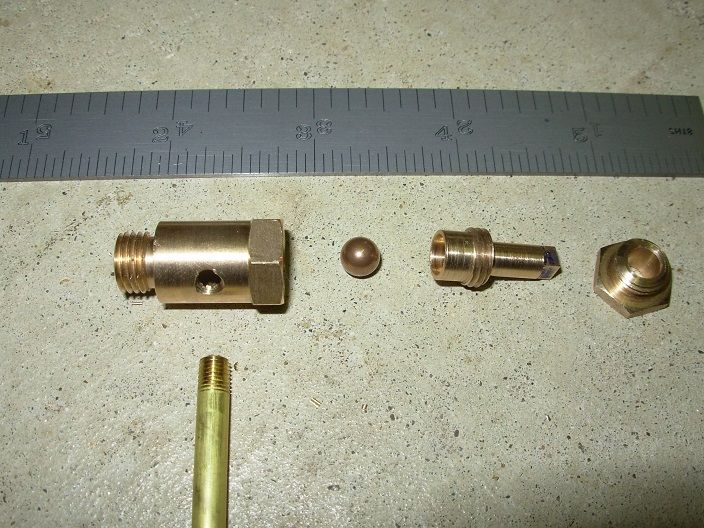

                          Here's the parts for a complete valve of this style:

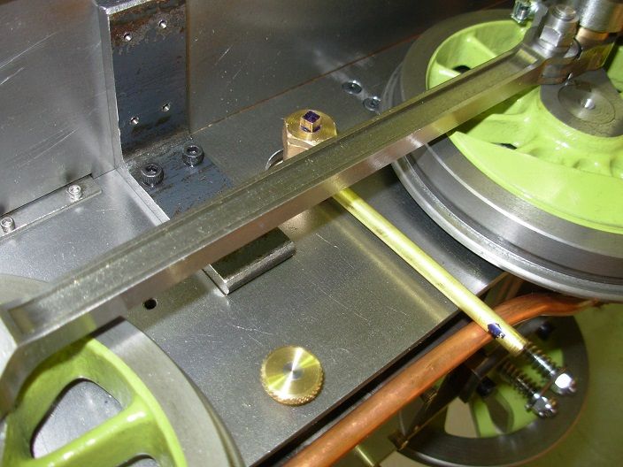

                          Here it is installed:
                          If you add an O ring on the valve spindle just under the retaining nut, you will not get any steam blowing out around the spindle when you blow down. Just make sure you open the valve enough to squeeze the O ring.
                          #413338
                          Peter Krogh
                            @peterkrogh76576
                            Don't drill for the exhaust until you've screwed it into place and marked which way it should point. No shimming to get the thing clocked.
                            Pete
                            #413340
                            David Wasson
                              @davidwasson11489
                              Good tip Pete! In fact, the same goes for all fittings that screw into something and must have a specific orientation.
