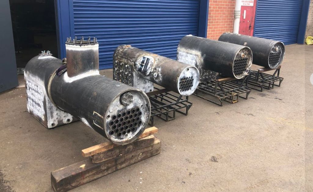

                      #652055
                        Yep still going but does seem to take an age to get accepted.
                        NBR do quite a few boilers for the heritage railways, pic from their FB page, two 9" Foden, one 6" Fowler and a 15"g loco boiler
